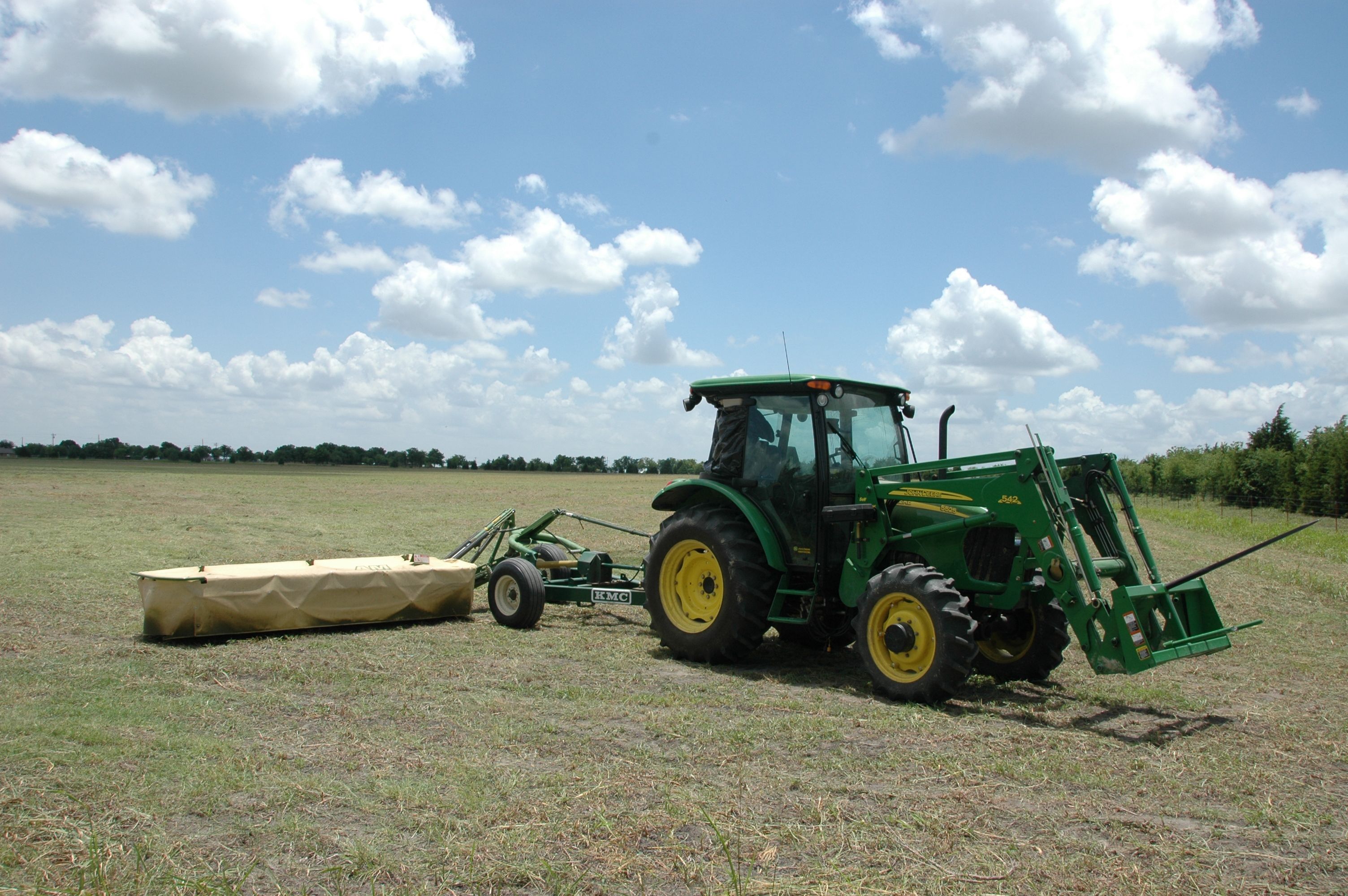

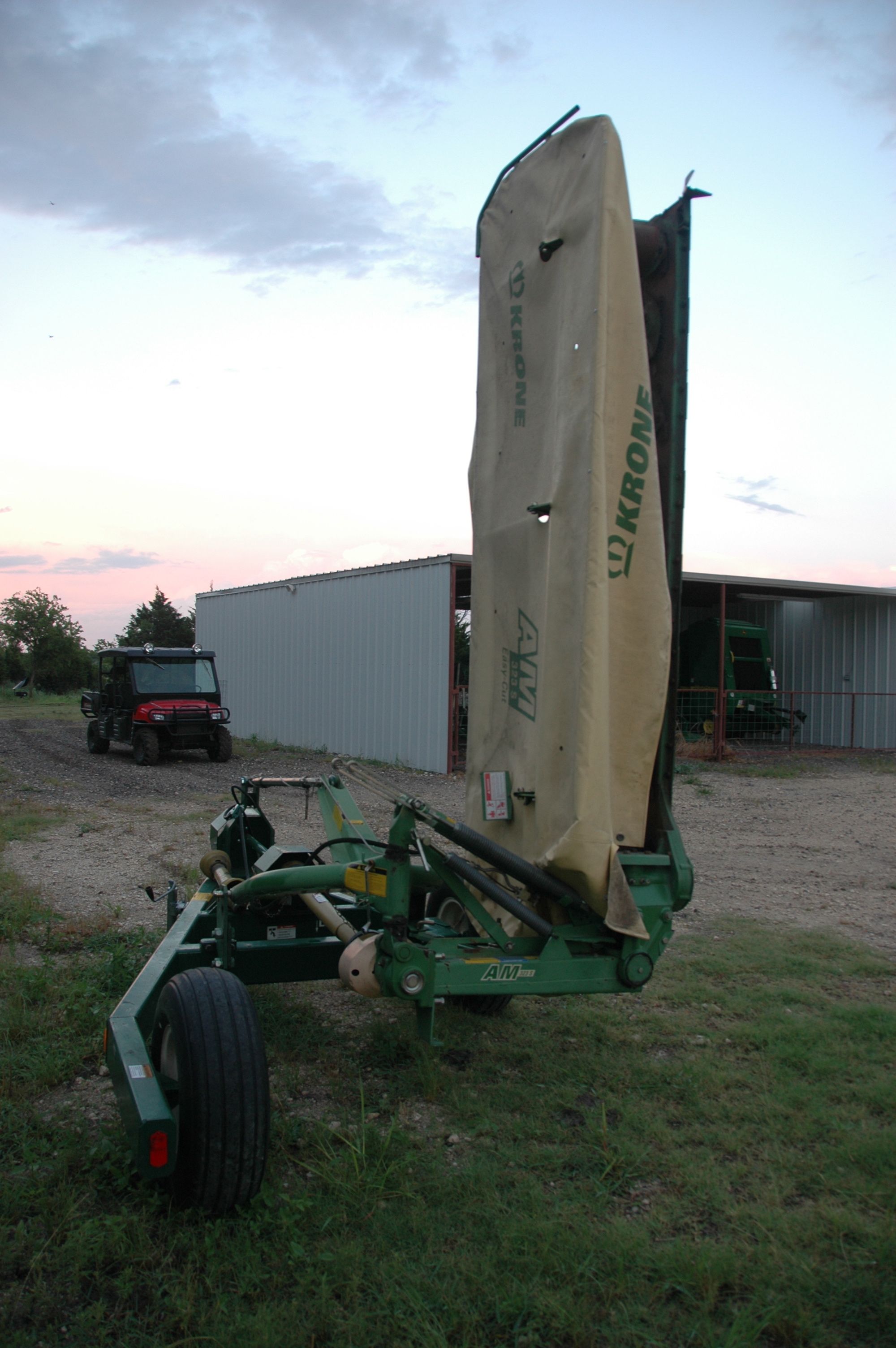

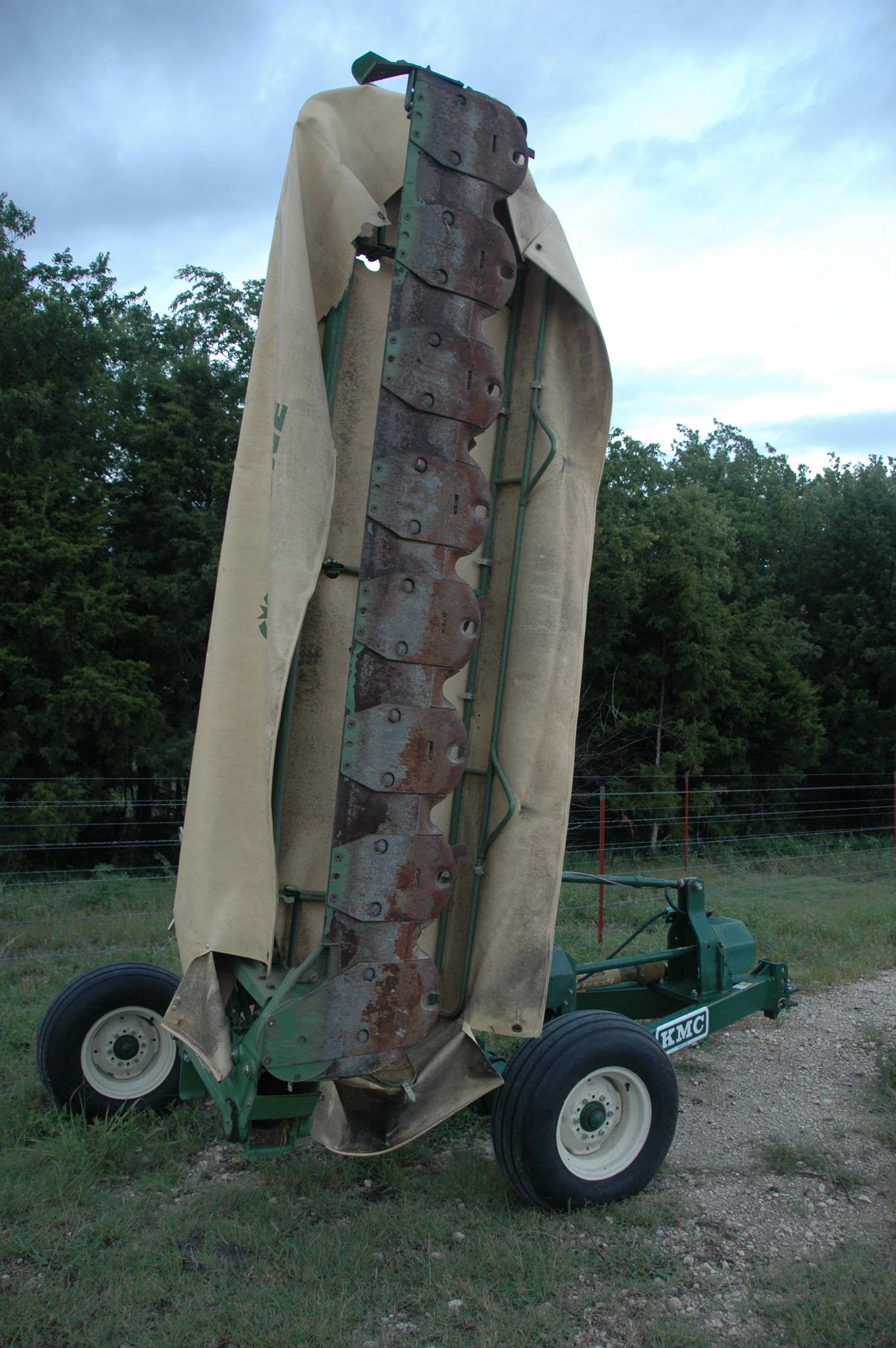

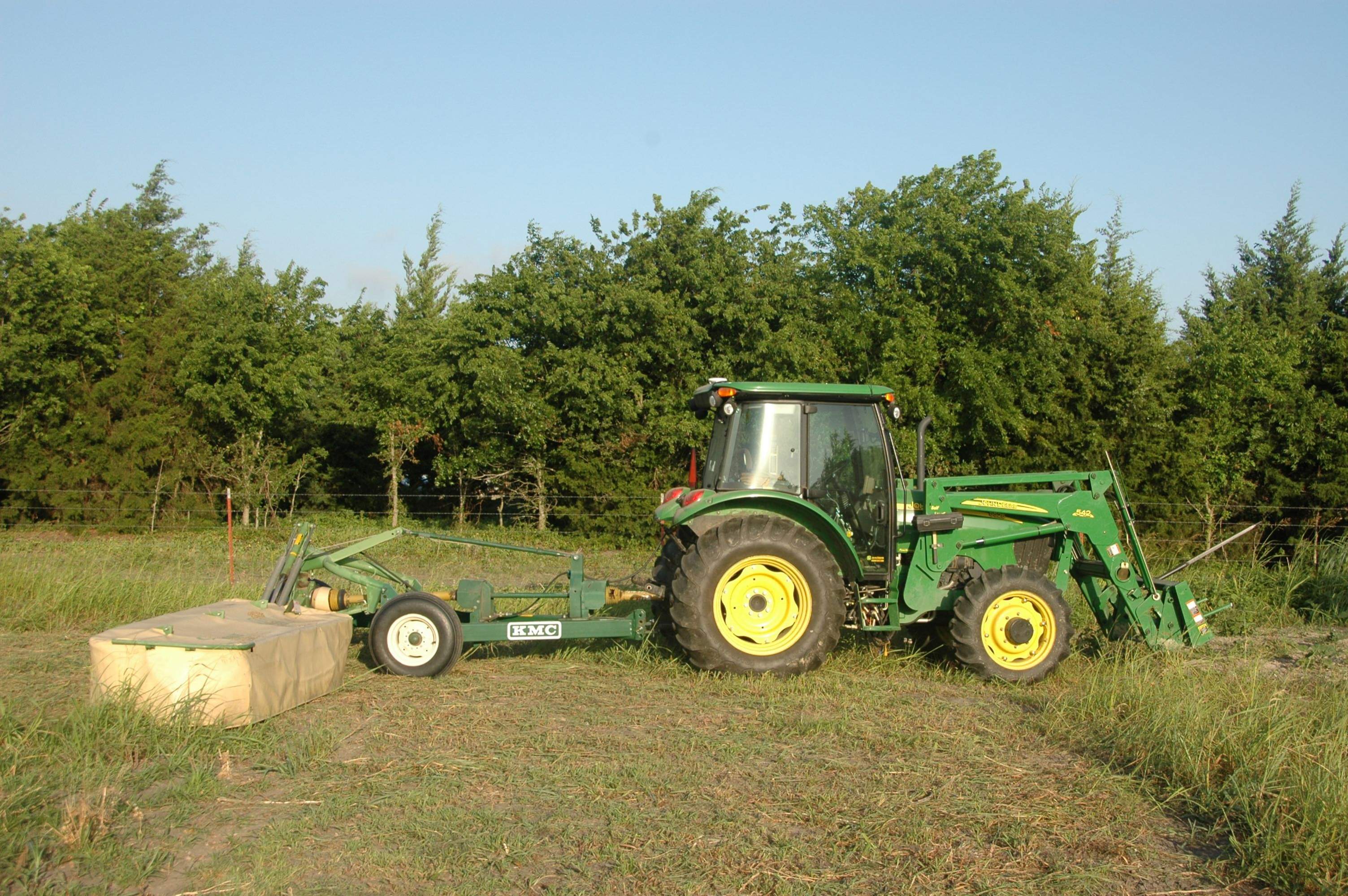

Agreed- where are you located? My dealer has one coming in on repo. Cutter in a caddy, etc.

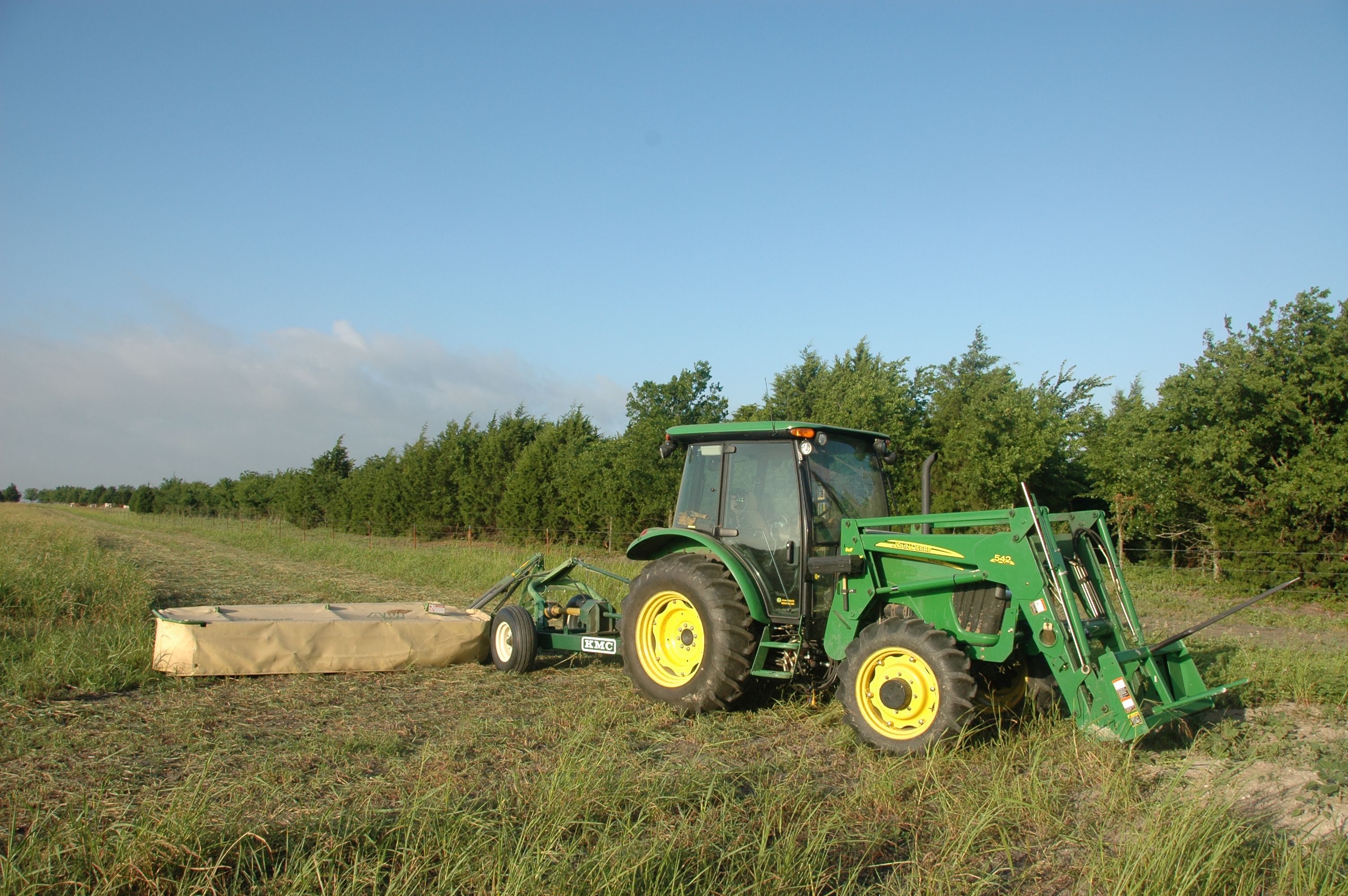

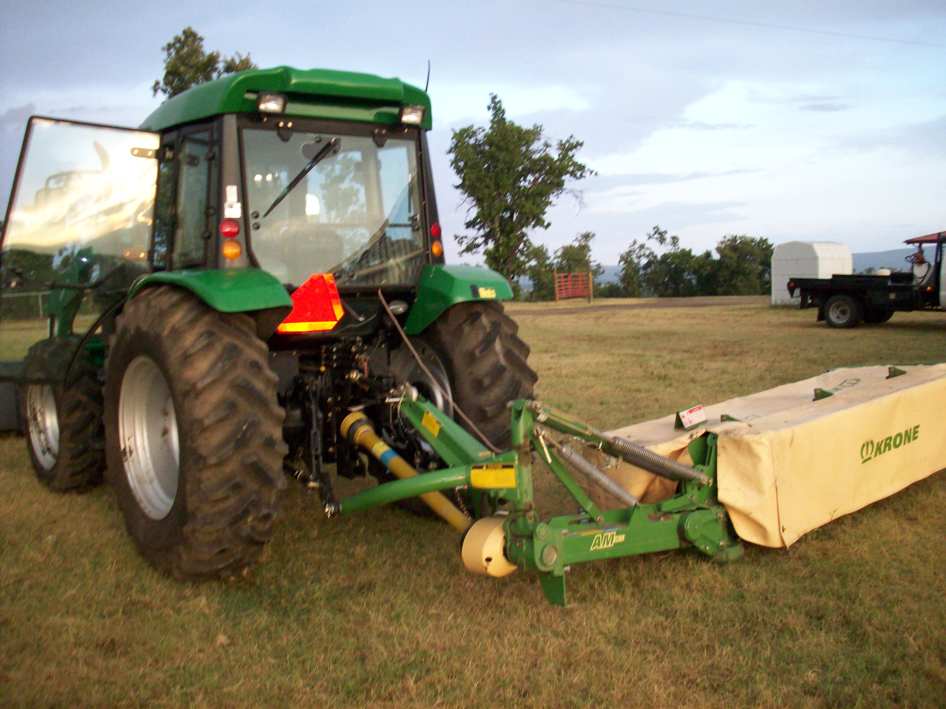

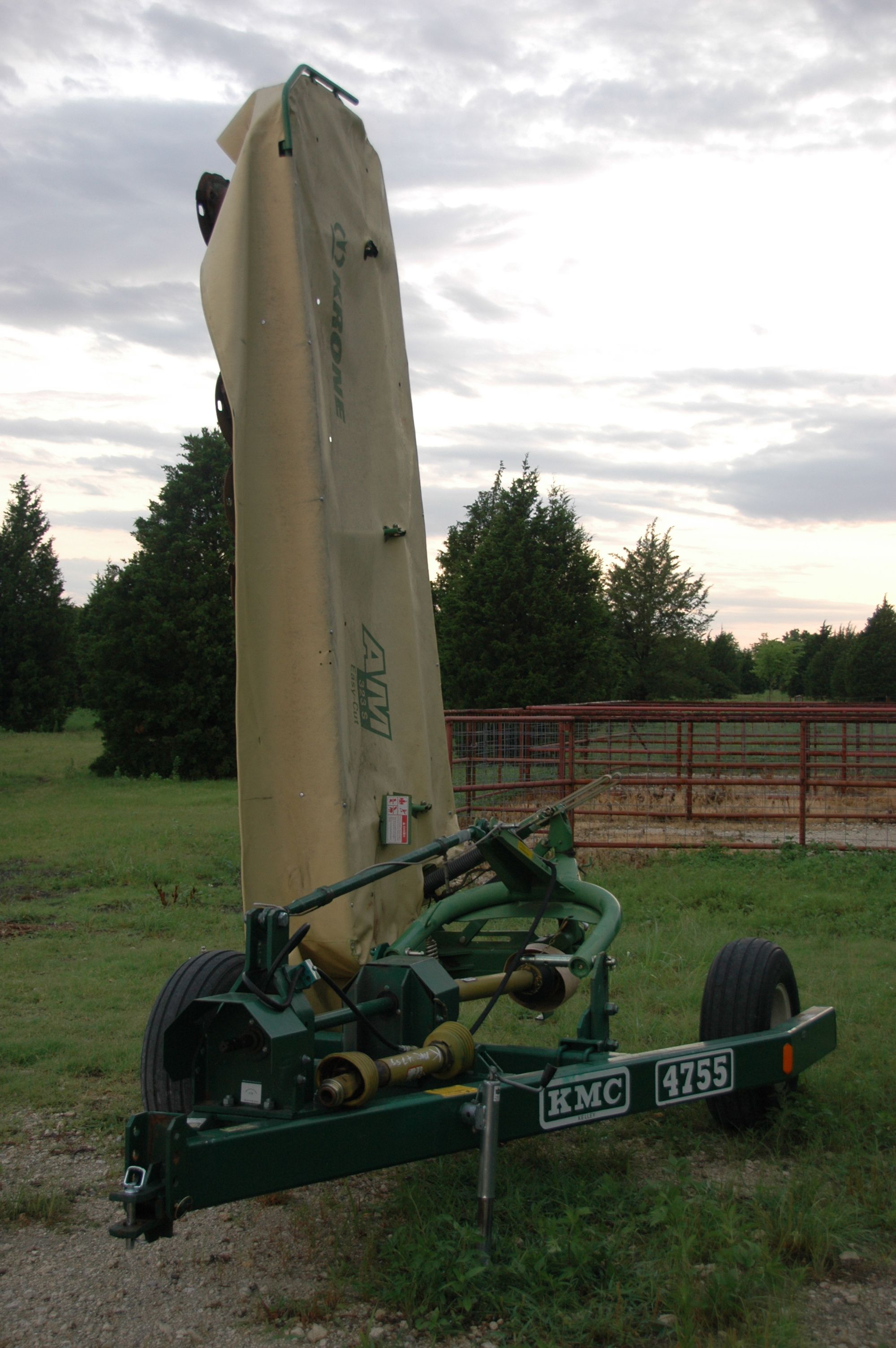

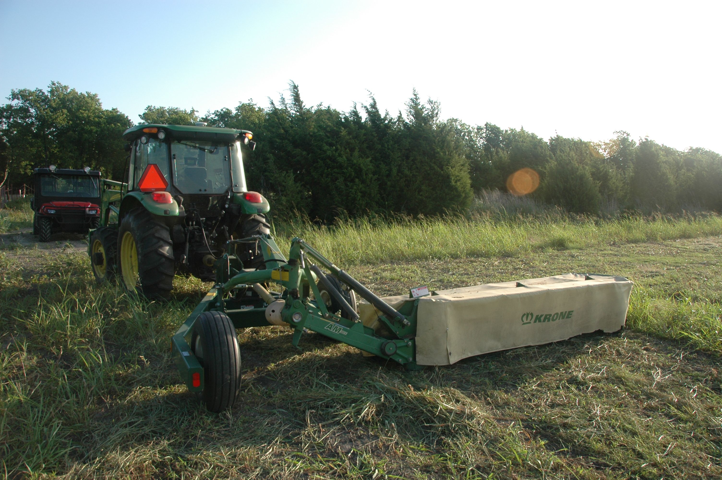

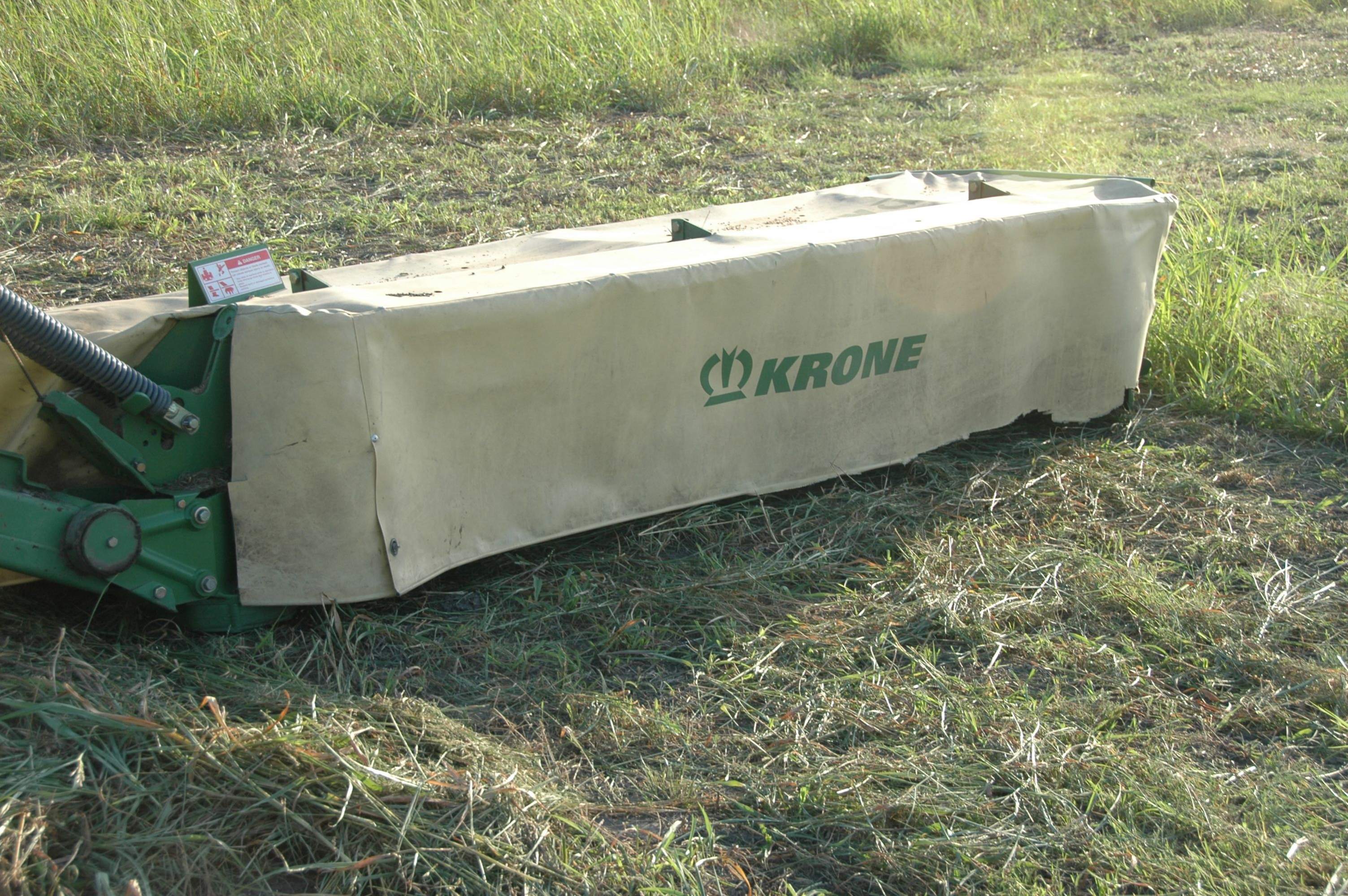

Here are some pics of my setup from my first time using it, etc.

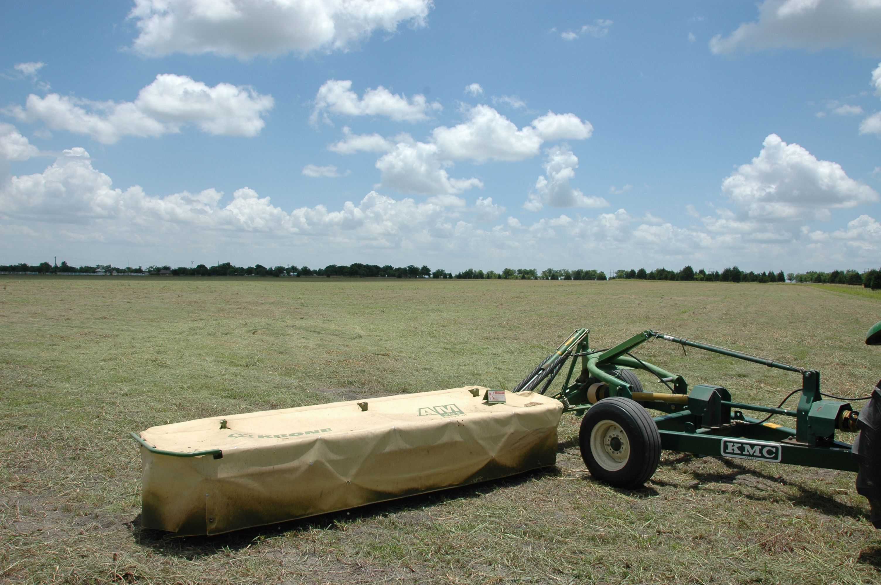

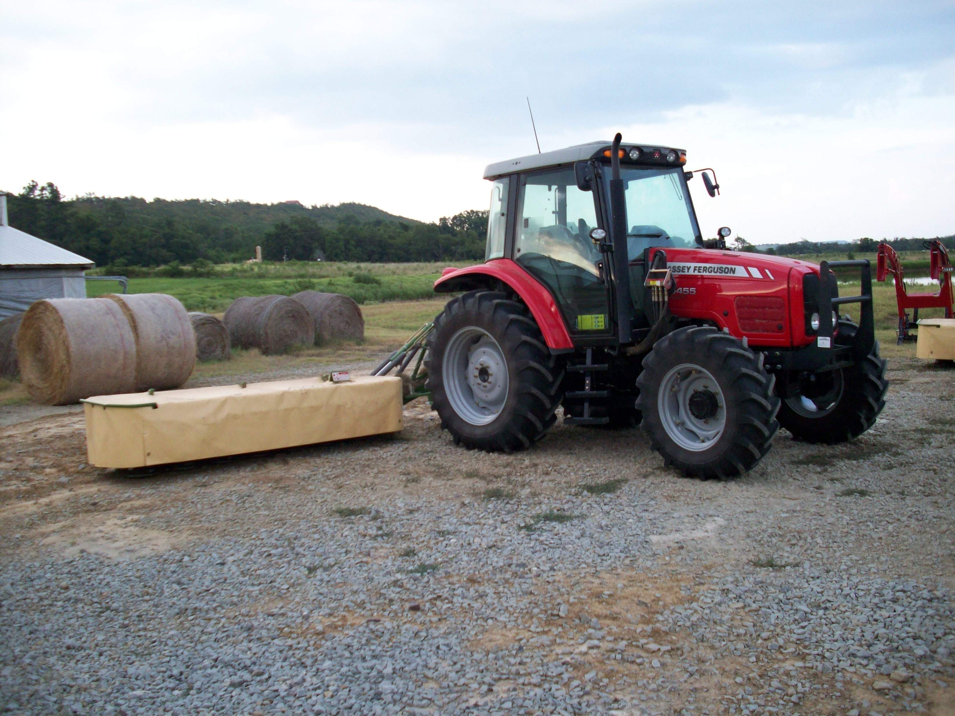

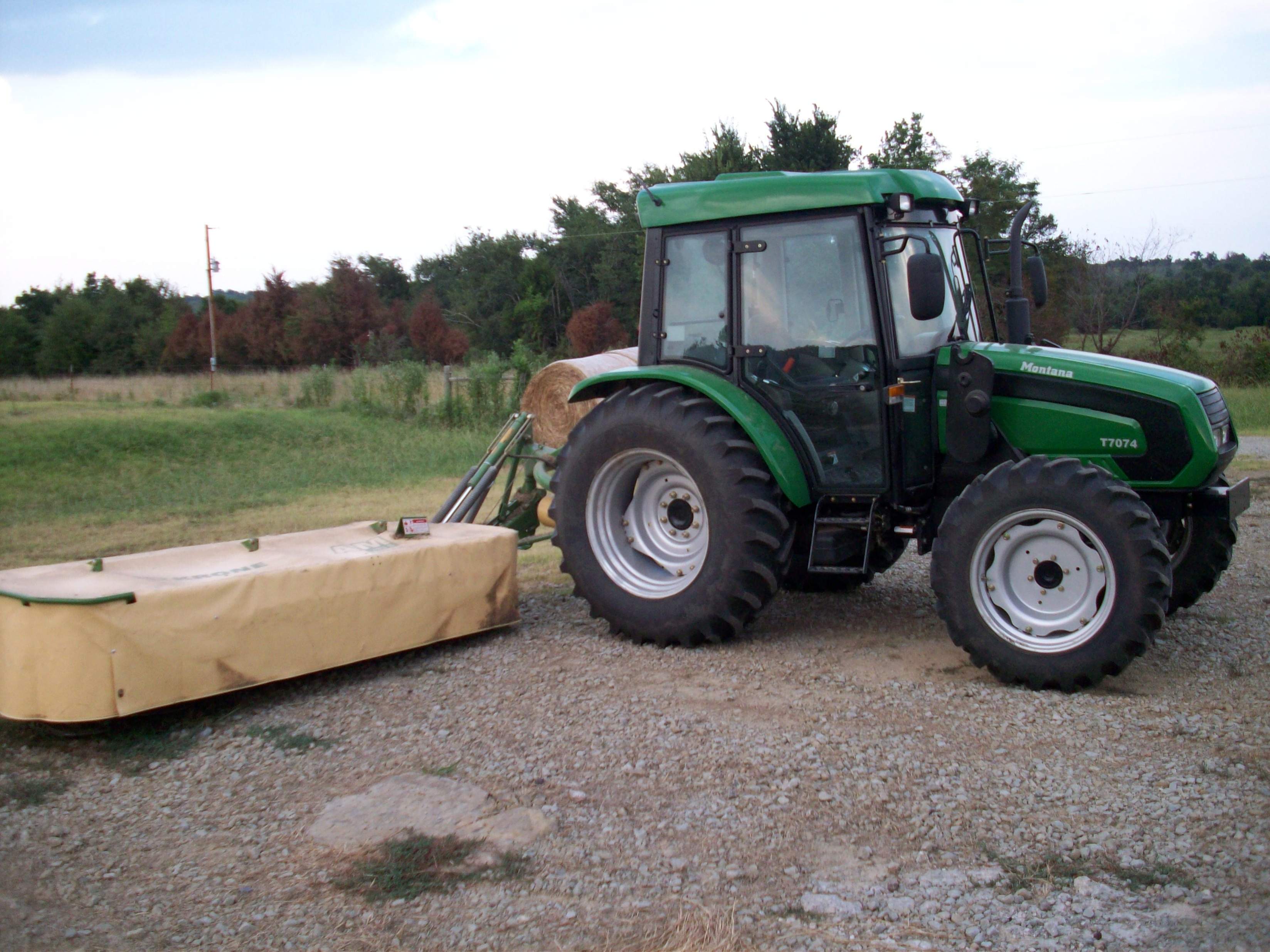

As a comparison here are some shots of mine last year on the Montana and on the MF 5455. Darin's mower is bigger as he mentioned. I have been told several times that if I would try a caddy, that I wouldn't go back to using them on the 3pt. That expense is not currently an option this year however.
A couple of months after I bought my mowers, one came up at auction locally on a caddy. The exact same setup that Darin shows and only 1 year old and only used on a few acres(owner had a heart attack). The whole setup only brought around $7000, which was a steal.:(
They look good on there. You got such a smoking deal on those mowers - you could afford to have 2 of them!
Used caddies don't come up very often. There are a lot of options in the caddy market. Prices are not cheap - I am glad I got my setup used.
D.
Im in E TN. Thanx for the pics. Do you know how long the cutter is?
