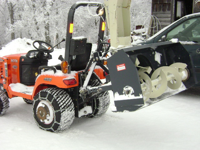

I like to have both a snowblower AND a loader working in tandem when I am moving snow. Presently, I am using a reversed snowblower mounted on the 3PH of my BX24. Reversed or Inverted blowers are not common. However, I find them easier and more pleasant to operate than the conventional 3 point units that stiffen your neck as you back into the snow. The inversed design also has the advantage of doubling as a type of boxblade to scrape the driveway or to pull snow away in tight areas.
The snowblower in the photos is an AgroTrend. I bought it used for $1000. The tire chains provide unbelievable traction under severe winter conditions, and especially on those icy slopes around my home. This particular reversed unit is model # C48PBH. Although this is the smallest model at 48" wide, larger models are also available.
