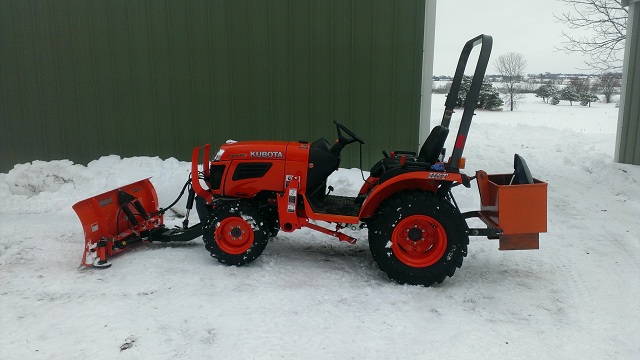

Hi. I have a 2920 which is the same machine (as prevoiusly mentioned), and some seat time, so I have a few thoughts.
Snow first:
From what I understand, you want to clear your 450' drive when snowfall has acumulated around 10"+. I would probably go snow blower. I don't have a lot snow blowing experience, but I have a 60" front blade from kubota.
http://i.imgur.com/cDbtBa4.jpg
http://i.imgur.com/0DAwqTZ.jpg
She will push a lot of snow, but 10"+ is going to be slow. Kubota does offer a front mounted blower as well, and that sounds a whole lot better to me than being wrenched around backward for that long. I personally don't really like the idea of a fel/SSQA blade on the loader eitheir. With a lot of side loading on the fel frame, I think you diamond the loader frame. It is not meant/built for force on that kind of angle, and it is not "industrial" rated like a skid steer. The 26/2920 won't do you any good with a 6' blade. That is just too big.
As far as blower size, I can't really help. Since the machine you are looking has a fel, just adding a 3pt blower would probably be the most economical option.
The backhoe hydrualics are totally separate from rear remotes. So if you want hydro chute rotation, you will need one rear remote.

That tractor should work nicely with a 63" blower front or rear...You may want to consider a rear dragger (which you pull as opposed to push)..Front mounts are costlier ( because of extra mounting hardware) and if you are only doing your own 450' driveway, a dragger in conjunction with an FEL save the old back ache causing twisted in the seat operator position.....Front mount with a rear blade is the ideal, but that all depends on how much you want to spend.
I run a 63" front blower with a rear land pride box blade on my B2650HSDC.
