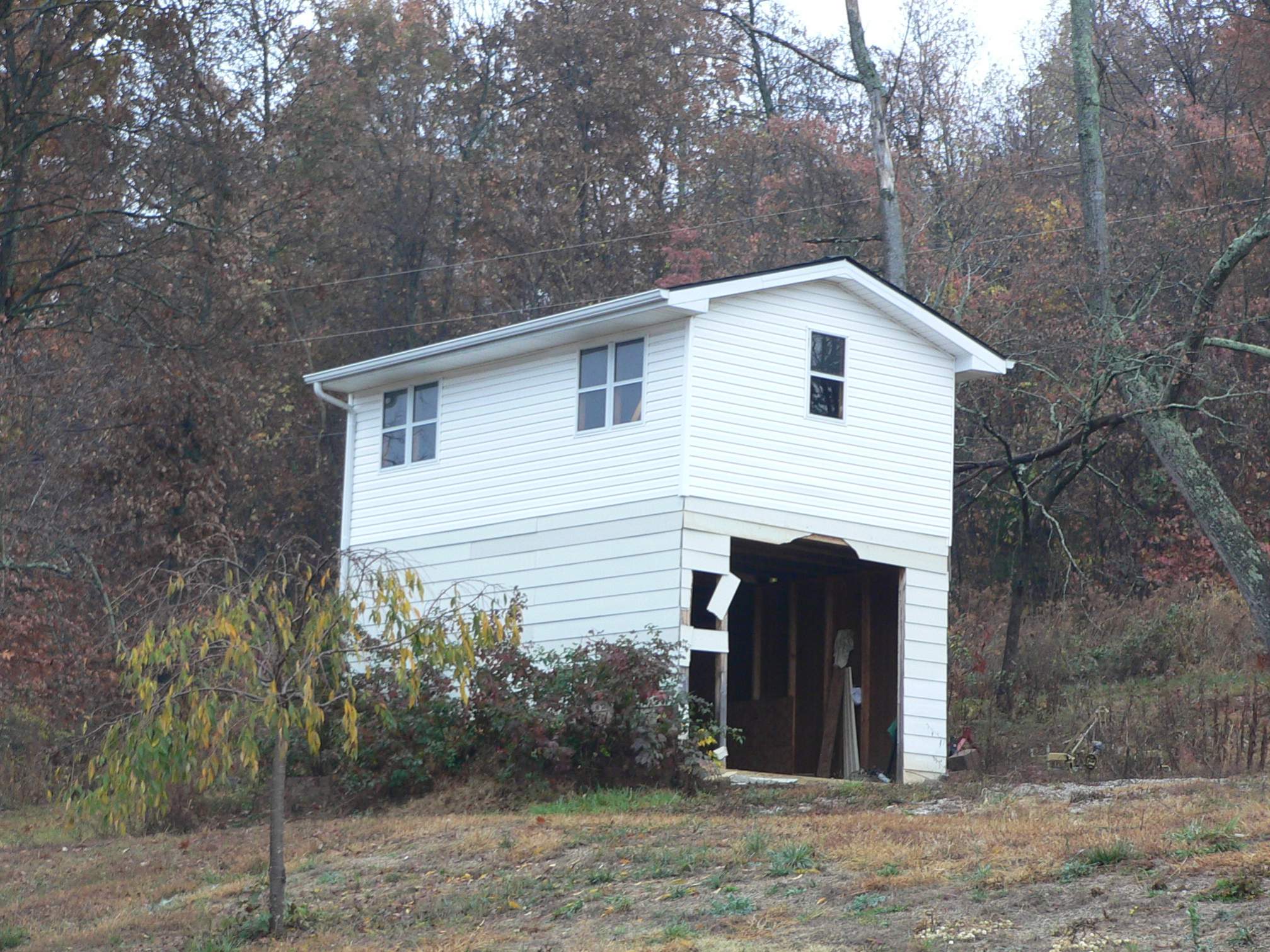

Otherwise, for close in work its pretty much the big bang theory?
Depends on your depth perception and coordination.:D I have a small slice in my vinyl siding on the back side of my garage. Also included pictures of my tractor storage bldg. Sometimes I get distracted which is really dangerous with an extra 5' to 6' hanging out behind you and your close to something on your side. A slight turn is a major turn at the rear end. Also applies to front bucket.
