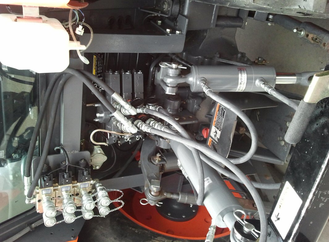

How do you have 6 rear remotes? Or do you mean 3 with two connections each?
FYI: JoelL last posted to TBN in 2014. He may not answer.
Angle, tilt, offset would take 3 SCV valves (6 connections), so if he also has a hydraulic center wheel (?), maybe he really does have 6 SCV's.
/ Rear blade hydraulic angle kit #24
Here is an M7040 with 6 sets of rear remotes.
Sorry about the sideways picture. :ashamed:

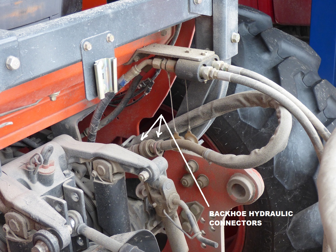

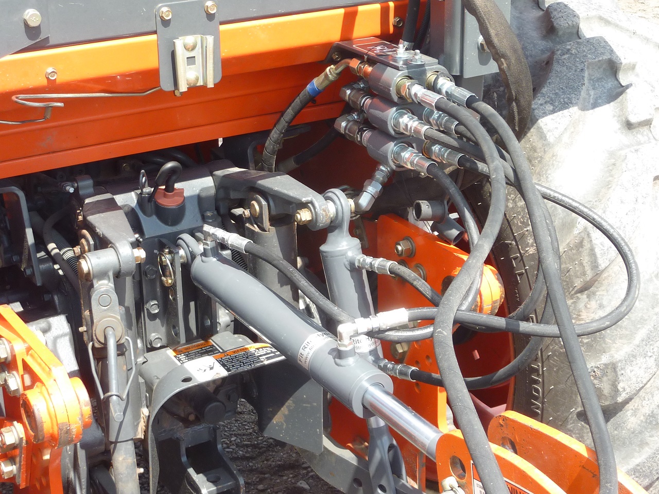

I'm not sure how the backhoe hydraulics work on your Kioti so I don't know if you could solve the valve problem by doing something like this. I was able to add two rear remotes to my Kubota L3430 by using the backhoe hydraulic circuit.
I mounted a Prince FEL valve to the ROPS and plumbed it in series with the backhoe hyd. hoses:
I added 2 sets of connectors below the existing set:
I use it to control a T&T kit from Fit Rite as well as the angle cylinder on my rear blade.
