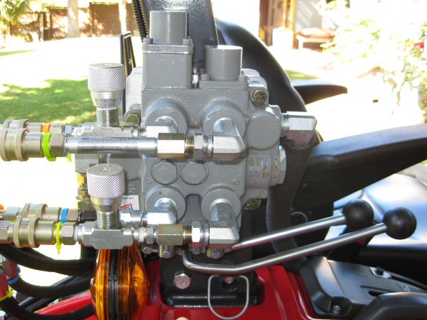

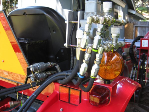

As I had said, I would use the standard Kioti rear remote valve that you need to get from your Kioti dealer. If you do not want to go that route, then go and look at Surplus Center for one of the valves that they have to sell.
https://www.surpluscenter.com/sort.asp?UID=2156010617554486&catname=hydraulic&keyword=HDD1

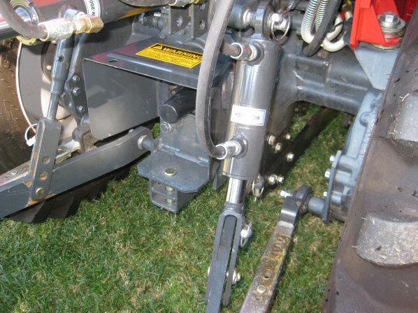

I need 3 remotes on my Mahindra 3215HST, so I have the 1 available factory remote and 2 alternative remotes.

That is an elaborate valve. I wouldn't need a valve such as that if all I want to do is angle the blade side to side correct? By the way, thank you for the pictures.
/ Rear blade hydraulic angle kit #14
I think that you will need something similar. Go with the Kioti standard valve, that really is the best thing to do and the cleanest installation.

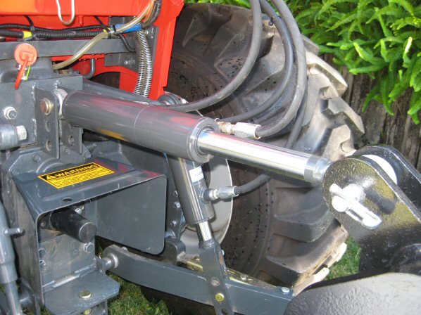

You said in your first post that you already have a rear remote for use with a backhoe. Why don't you just use that valve? All you need to get is a hydraulic cylinder with the proper stroke length, hoses to hook up to your remote outlets, and make the brackets to hook the cylinder to your blade and away you go :D

Here's a factory one. Most of the OEM blades with hydraulics do this.

Most of the OEM hydraulic blades use 14" & 16" stroke cylinders. Usually 3 1/2" or 4" diameter. I think that the smaller blades use the 14 x 3 1/2 cylinder and the heavier blades use 16 x 4 cylinders.
/ Rear blade hydraulic angle kit #20
I just finished mine. Seems to work quite well with the snow we've had recently. I had to redesign it mid-stream, the original configuration didn't pan out so good.
You need to attach both ends to something SOLID, or the blade will turn into a pretzel. Mine was bent when I got it, the previous owner found out the hard way.
I use the valve for the remote to power the angle cylinder, which is a 3 inch bore with 10 inches of stroke. You need to establish where you're going to mount the rod end, then pivot the blade through the rotation you want and measure the difference in length required at the rod mounting point. This will tell you what length cylinder you need. Take it from me, longer isn't better.
