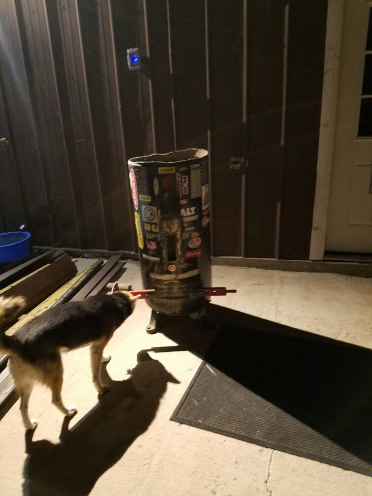

I just cut out a slot in my leaky aircompressor tank & welded in a Cat1 3pt drawbar CountyLine Cross Drawbar, Category 2, 3/4 in. dia. - For Life Out Here (that's a more expensive Cat2). Need to reinforce the tophook slot but it's holding as is for now.
Up to the tophook slot is filled with brake disks, other trash steel & concrete for weight & strength. Above that is just sand to adjust weight if need be. Welded some scrap steel behind the tophook slot to keep some space for the hook to grab. Used some metal tape to temporarily seal it while the concrete setup & sealed it better.
