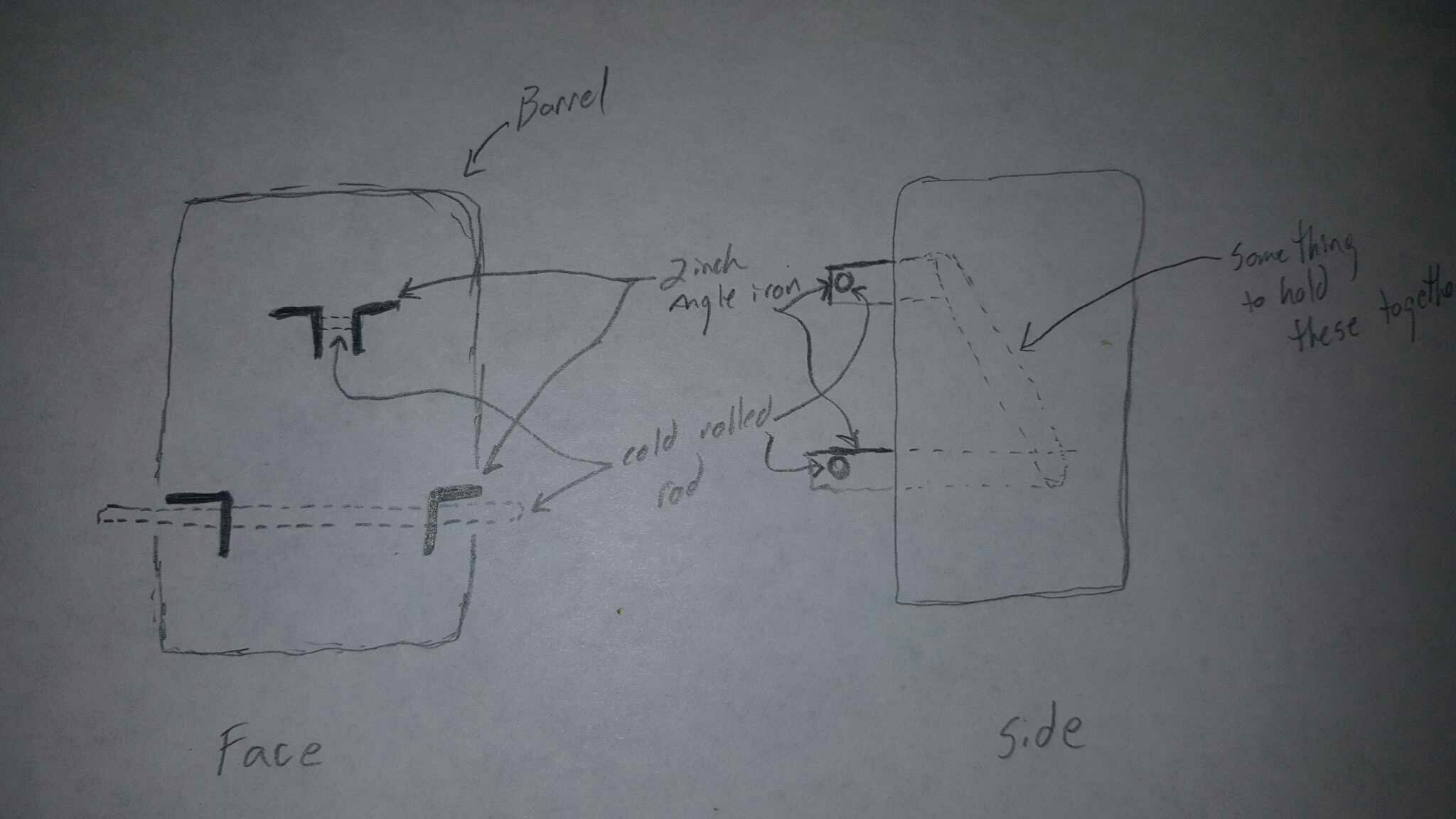

Any recommendations on how to make a 3pt hitch lift points for on a barrel? Do they sell lifting points/arms I can weld on?
   / Rear Ballast Close to or Far out from the tractor?? #9
Easiest is a cold roll rod thru the barrel and a top link bracket sticking out the top.
This is what I'm thinking
