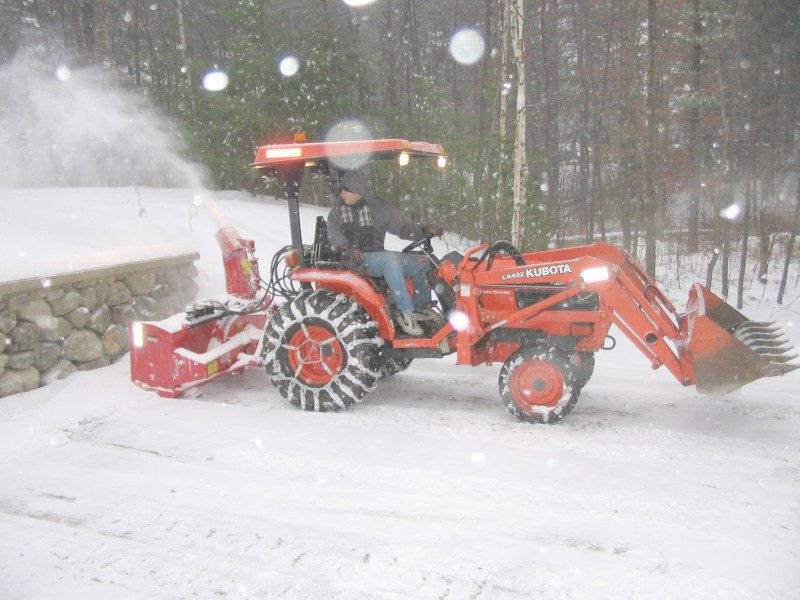

On my B2710 I have the shoes adjusted for the minimum. I drop the blower right to the ground. I adjust the angle of attack of the front lip of the blower with the top link. Until the ground freezes the lip stays 1/2"-3/4" off the ground.

Nice picture Mad Ref-where did you get the nice tire chains and tensioners? I need a pair for my B7800 R-4's as skidding trees out on snowy and icy ground seems impossible right now.
They are 2 link ladder chains with spring tensioners from TireChains.com. I had to remove one link from each tire and shorten the chain accordingly.

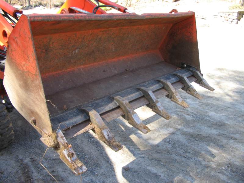

Also, that's a wicked looking tooth-bar. I have a Markham Welding one on my bucket but it's a toy compared to what's on your B2710. Where did you get that?
I got it from the dealer. It's a name brand but the label was trashed when I got it new so I don't know the manufacturer's name. It's a 9624719DS if you can find who made it.

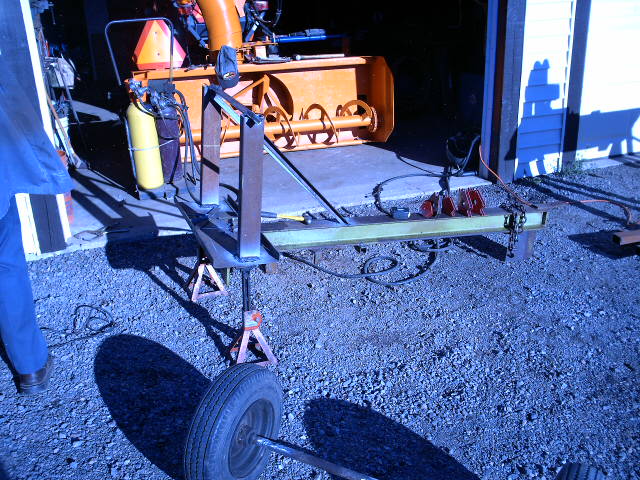

I have a gravel driveway and, even with the top link shortened, I sometimes gouged into the lawn when I got astray before the ground froze.:mad: The cure I found for this (since I manage to drift off course from time to time :eek: ), is to slit a piece of thin wall steel pipe and slide it over the bottom edge of the blower. It is held in place by tabs welded to the pipe and bolted to the blower. This works really well. The attached pic shows the blower in the background with the slit pipe installed on the bottom edge.

Thanks again for all the responses. I've found a website for the manufacturer(Walco) so I'm going to see if I can get a manual . That looks like an interesting idea about putting the pipe on the bottom lip. When you say thin walled pipe is that like EMT? (thin electrical conduit). Also, what size (diameter) did you use, and did you just run your angle grinder along to slit it?
Thanks
Fjord - the pipe is something from the scrap pile, I'm not sure of the wall thickness but a little heavier than EMT. It's 1.5" diameter. And, yes, that's how I slit it - a 1/16" thick cutting wheel on the angle grinder. With the 1/16" slit, I had to pry it open wider at one end to get it started over the lip and then worked my way to the other end of the pipe with a big hammer. It does work well.
