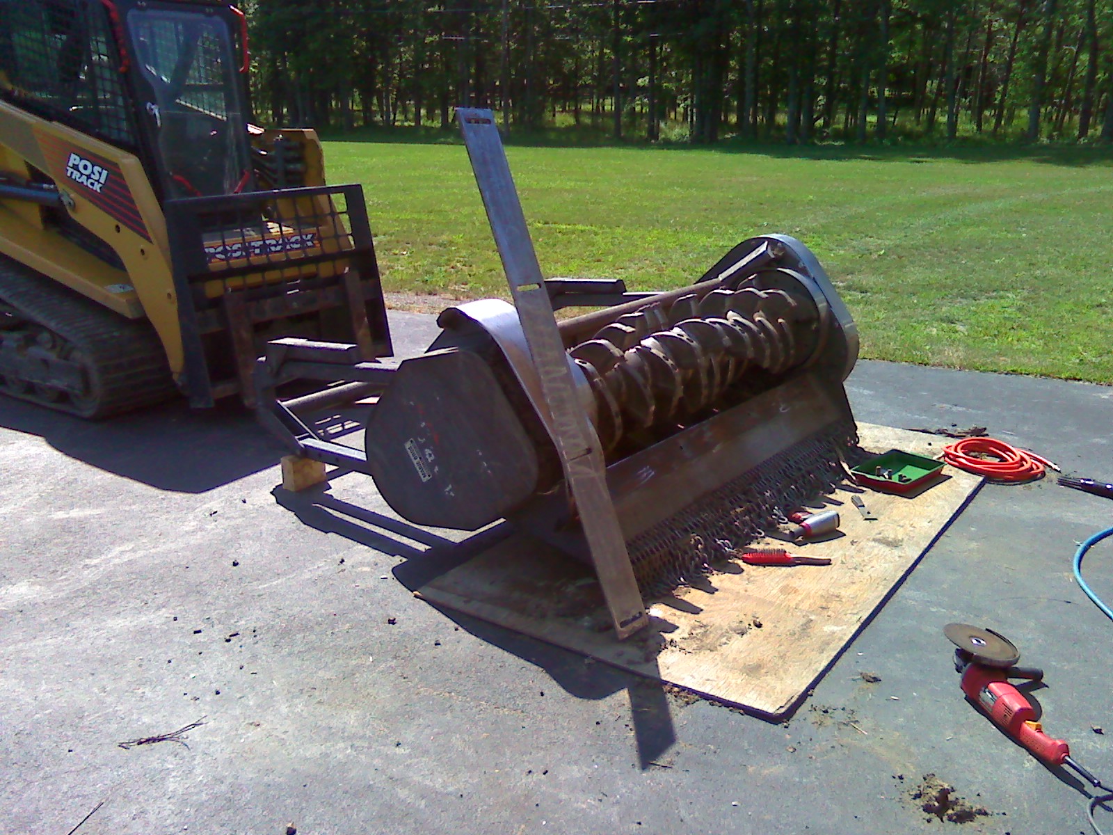

I wonder if they can fabricate a carbide edged cutter bar? I've flipped my cutter bar 4 times, now need to visit a machine shop for new edges. It gets rounded over in only 100-150 hours. When material starts to jam frequently, it's generally rounded over. A long carbide edge would really help. A new bar is $138 plus shipping from Loftness.
Robbie, that's your grinder on the ground.
