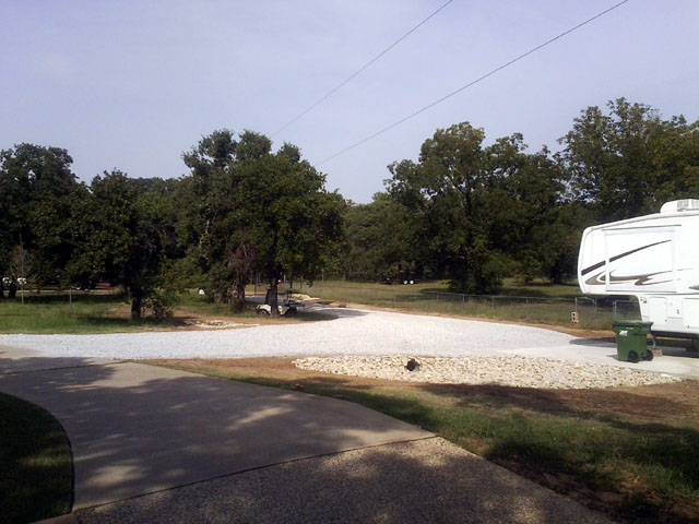

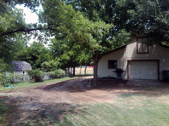

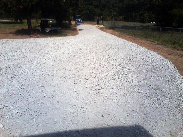

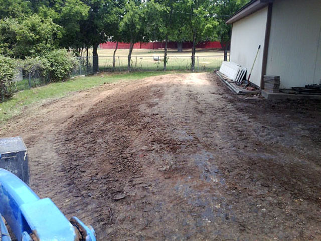

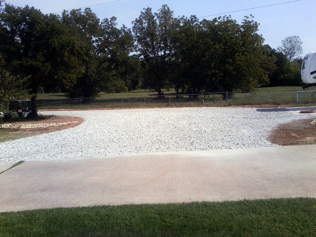

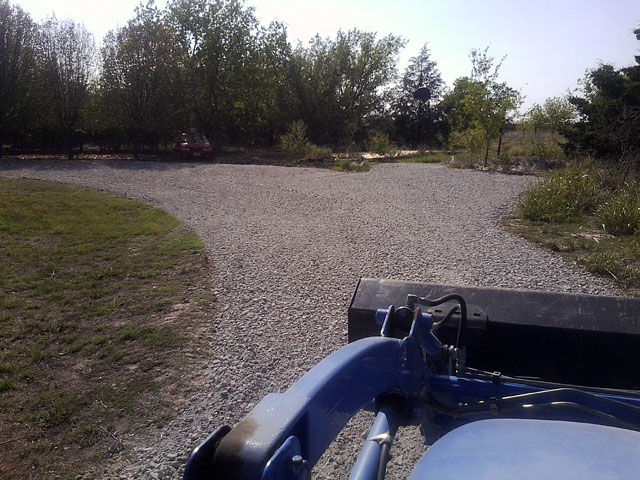

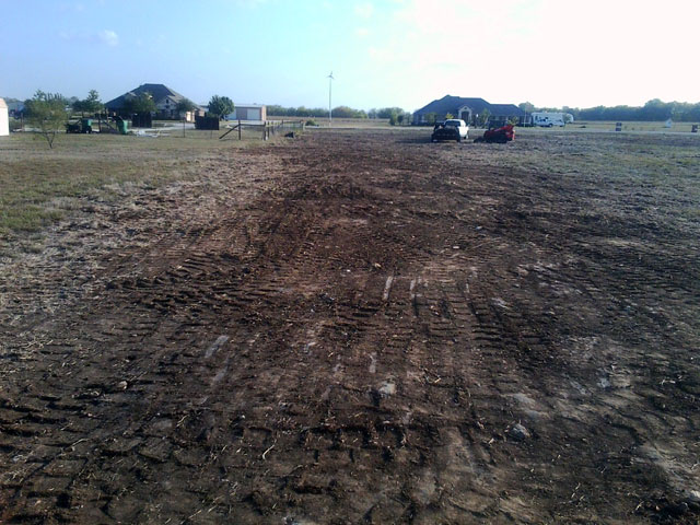

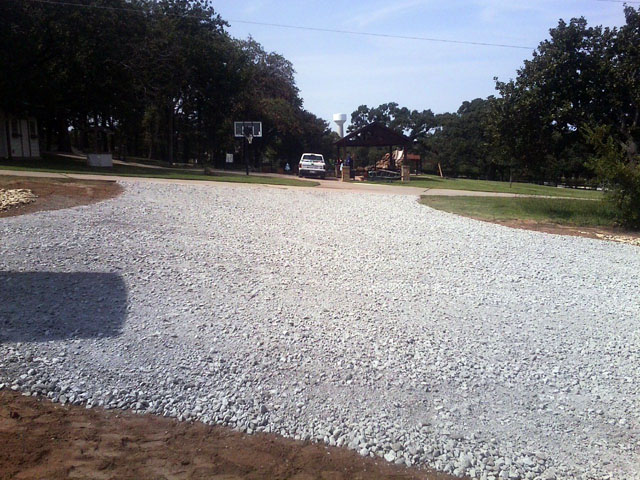

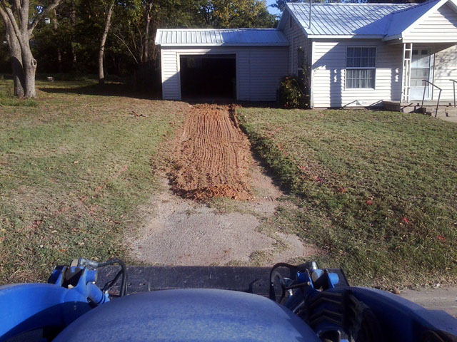

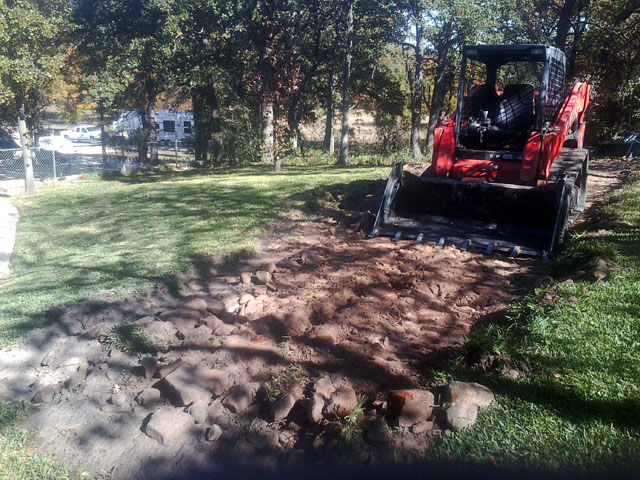

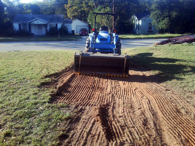

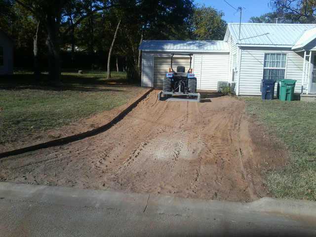

Finished up a little driveway in Denton today.

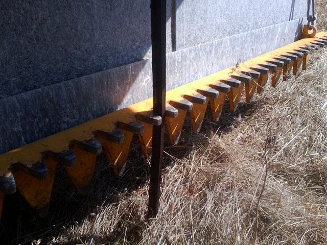

Here's the start of the job and using the Rachet Rake to remove sod.

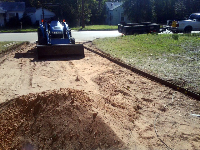

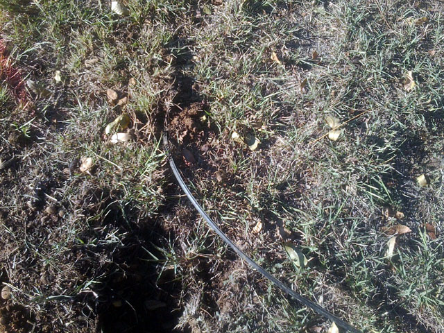

Verizon's line buried 2" deep and 6' from their mark.

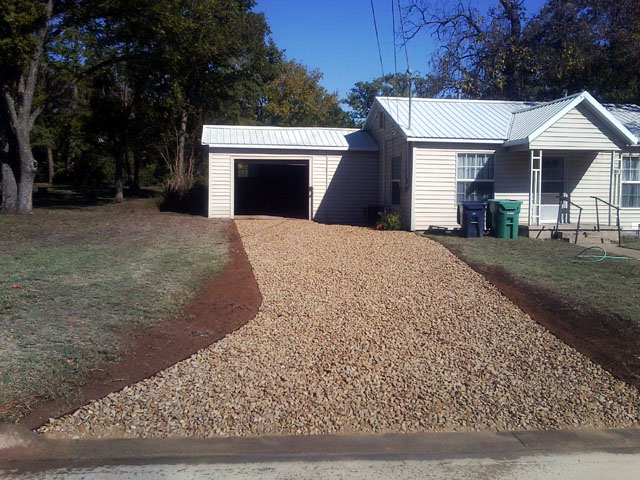

Denton now requires some type of border, so I decided to use "usually easy to install" metal edging. Sometime in the past someone had buried a bunch of rock and broken concrete where the borders needed to go, making it impossible to drive the stakes. I had to drive a steel stake using a single jack for each hole before replacing it with the little metal stakes. 14 pieces of metal edging with four stakes per piece. Lots of fun. :rolleyes:
Graded and complete.

How did you drive it with a jack?
Single jack is slang for a short-handled sledge hammer. I take a 15 pounder and cut off the handle to about wrist to elbow length.
View attachment 286912 View attachment 286913
View attachment 286916 View attachment 286917
Another nice looking job I am sure these sell themselves when people drive by and see how nice it looks.

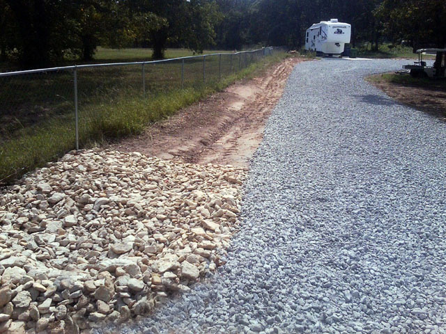

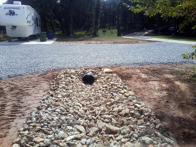

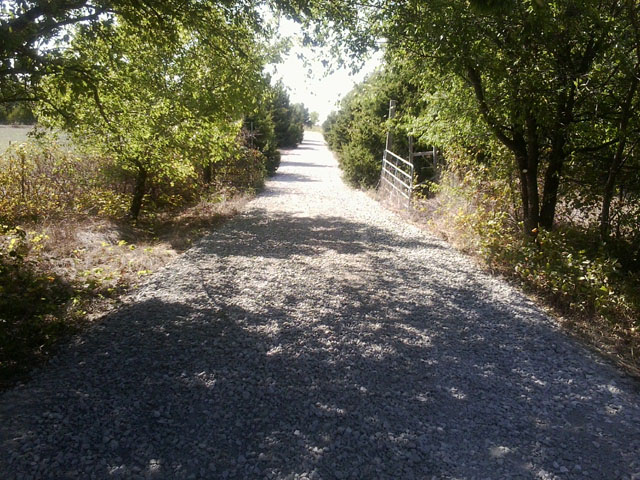

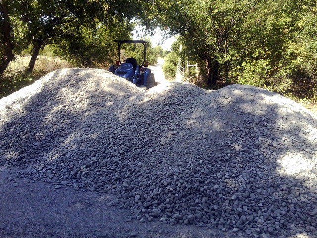

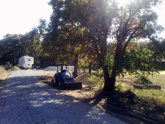

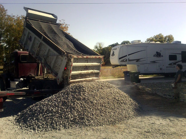

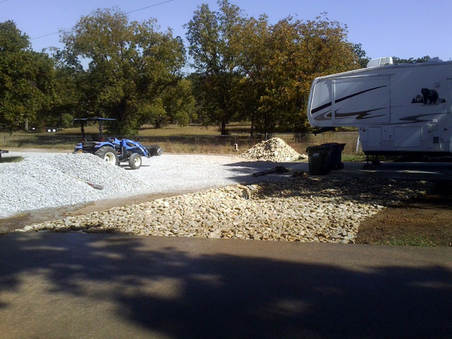

Started phase two of the RV access job and did some additional work on the bottom section today.
Stockpiled road base for the upper road, gravel for a french drain and rip rap for more culverts.
Started grading out another drainage swale.
Removed a couple of feet of rip rap for access to the geotextile, graded, then added additional geo and rip rap, doubling the size of the main catch basin.

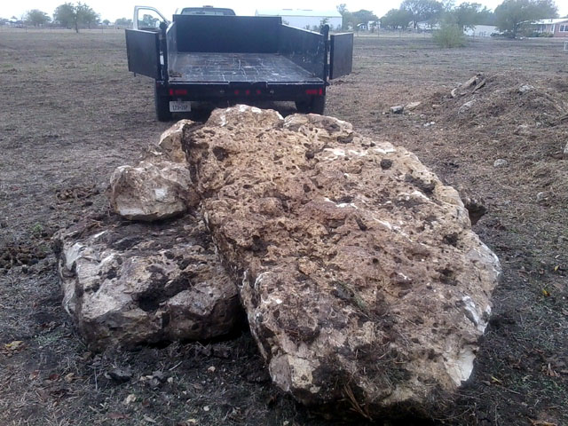

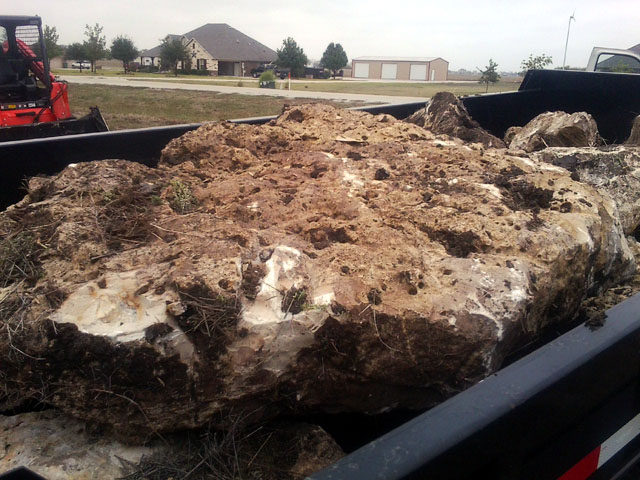

Cool! Is that your Pete & pup?

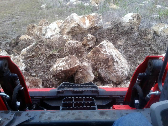

BTW, where I come from rip rap is a whole lot bigger, like, small boulders & takes an extra-heavy gauge truck bed as not to leave big divots. And it still will if the loader operator lacks finesse. Slight thread drift, sorry - harkening back to my glory days. :)

LJH - Not my Pete but I wish it was!
I size the rock for the job. Since I do a lot of the smaller stuff I use a lot of 4-8" rock. Back in the old days we used to place a lot of the large rip rap you mentioned and pump concrete between the boulders for containment banks. Some of the drivers that didn't have rock boxes would line the bed floors with wet clay to keep down the divots. It didn't work that well. I guess that they really needed the work!

About that border... Is it to keep the edges neat? I just can't understand why they require it?? :confused:
/ RDrancher's Photo Thread
#95
From what the code violation lacky told me, its to keep grass from creeping into the driveway. Guess they've never seen it grow in the center?
The City is really on a roll handing out violations for fences and driveway / parking areas. A lot of folks getting the violations really can't afford to repair anything in this crappy economy. Maybe someone should get a petition going to cite the City for potholed roads and missing street signs.

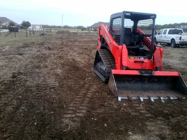

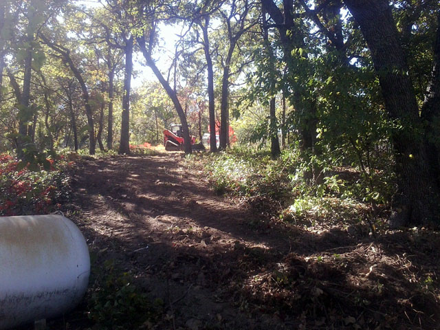

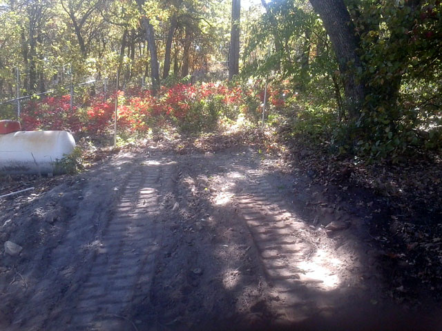

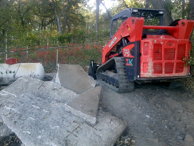

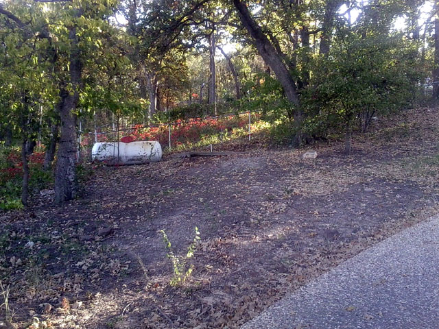

Started working on the upper driveway and parking area today.

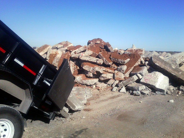

Here's where the road will be located. I pulled out an old slab that wrapped around a propane tank and hauled it off to the crusher.

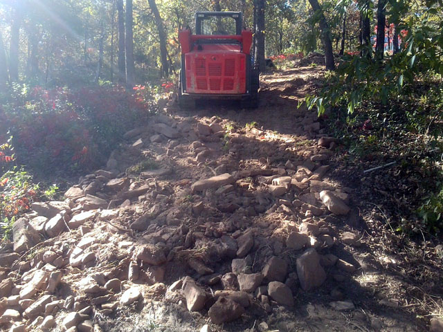

Removed the fence and started up the hill.
Benching in the parking pad.

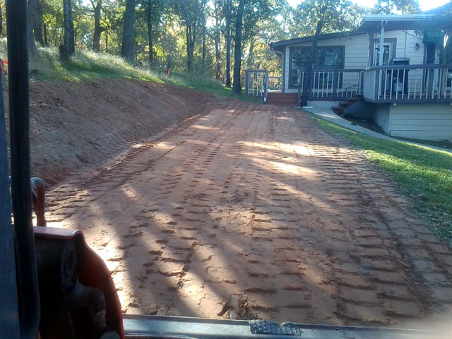

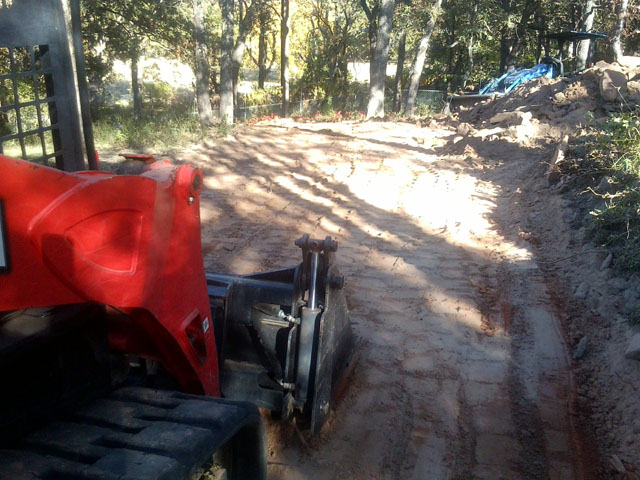

The ground is more sandstone than dirt and a pain to grade. I wasn't too happy with the looks of the slope either.
I decided to dig out next to the slope and sift through the junk, hoping that I would create enough decent dirt to dress up the slope and compact the area where I would be cutting a swale. While digging it out I hit some nice decomposed sandstone / clay mix, so I hogged it out and made a stockpile. Then I dressed up the slope, cut the swale and compacted the area back in.

Stoopid newbie question -
So, that beautifully smooth & graded sifted material in the last picture is covering up the extra-chunky stuff in the first picture, right? Pray tell, how did you sift it? 'Cause I need to do something very similar in an equally rock-rich area. Backdragging it either bounces the bucket or digs furrows with the chunks (and of course, I don't know WTH I'm doing, that always helps :confused2:).

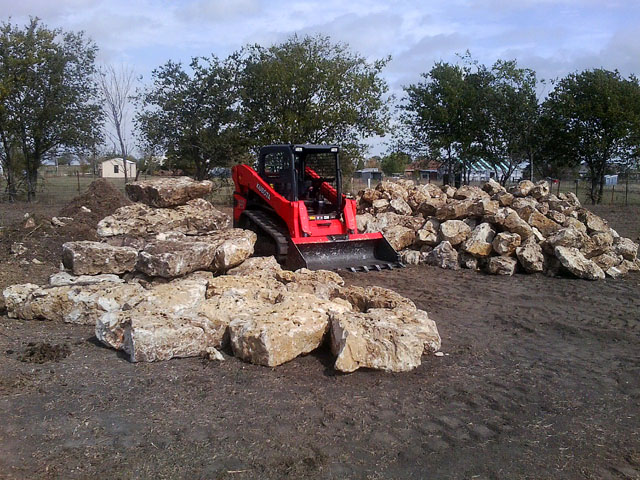

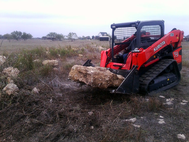

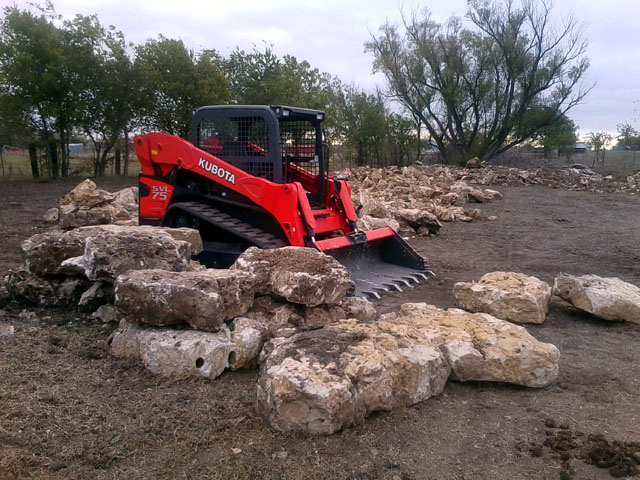

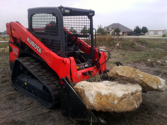

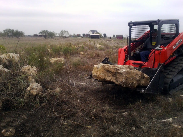

Sorry if I missed this but is that your Kubota? Either way how do you like it? I've not had the chance to run one but the cabs seem like they are a mile wide. If I ever bought one I'd look hard at the Kubota and the one armed JCB.
