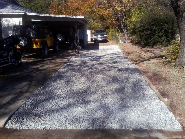

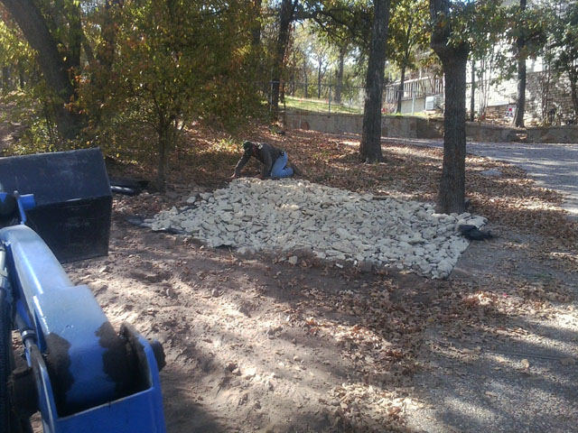

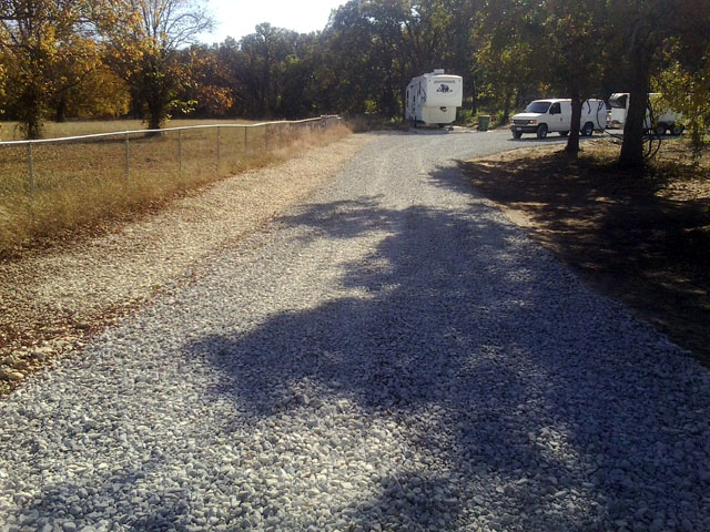

Finally got back to finish this job. The entrance and exit to the culvert looks weird in the photo, but its just the angle of the shots.
Skyline55.jpgSkyline56.jpgSkyline57.jpgSkyline58.jpgSkyline59.jpgSkyline60.jpgSkyline61.jpg
And finally, laid some river stone in the swale that I cut earlier.

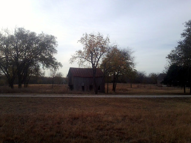

I love old buildings, so I took a pic of this one next to the job.

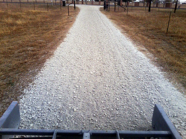

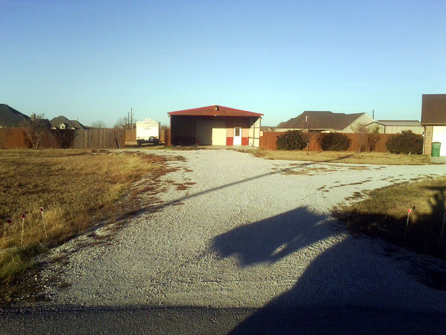

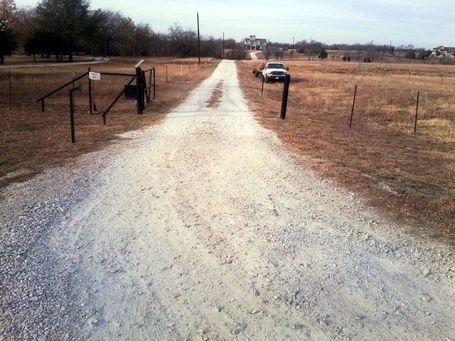

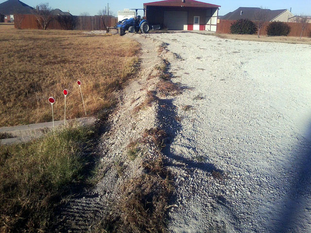

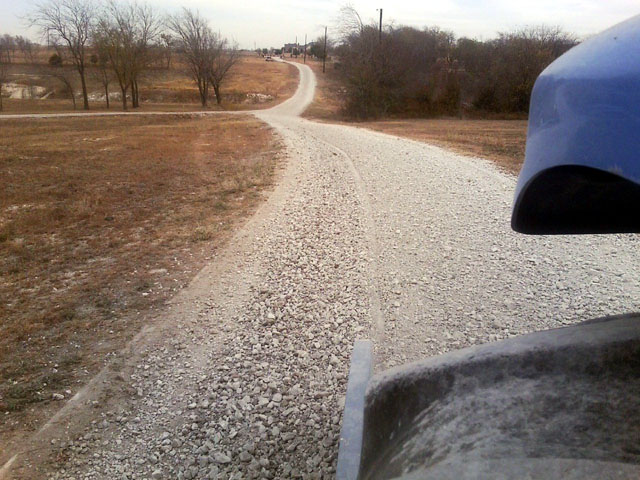

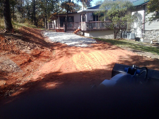

Here's a few before, during and after pics of my 1/4 mile driveway re-grade today.

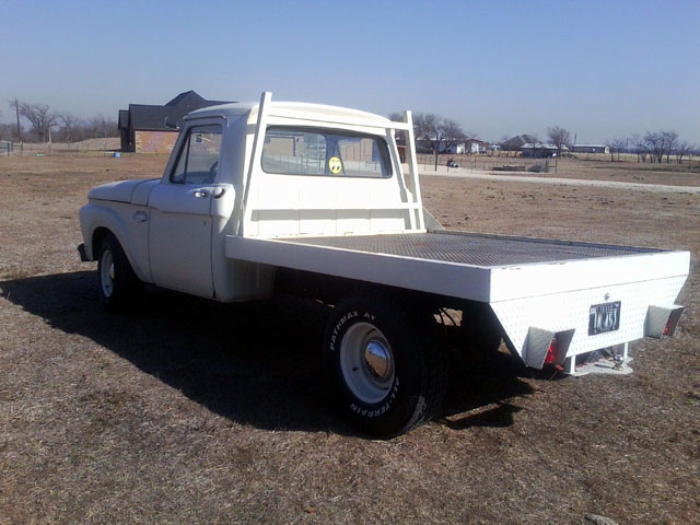

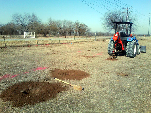

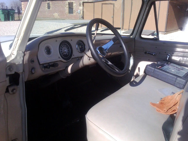

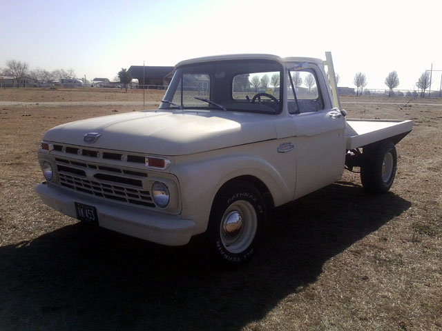

Did a few postholes. The customer had a cool '66 Ford that was purchased new by his grandfather and passed down to him. It has a swapped-in 302, the bed was built by his father and it has just 46K and change on the odometer.

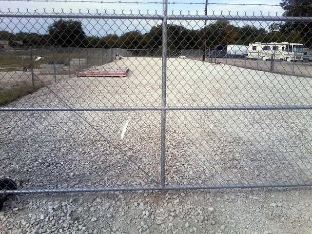

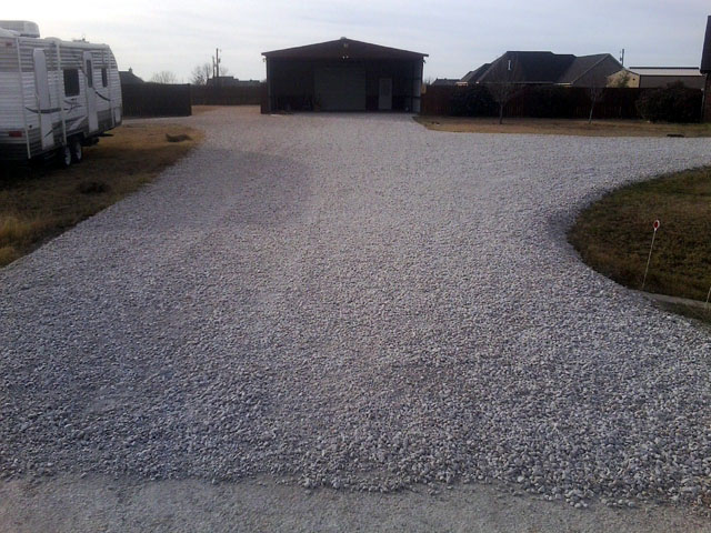

Another re-grade and an RV pad.
Here's a before shot.
Working the edges with the Ratchet Rake.

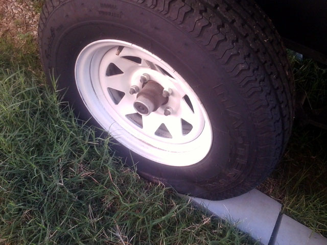

The owner didn't have time to move his trailer. Figures it'd have a flat.
RV pad graded and done.
Job completed.
