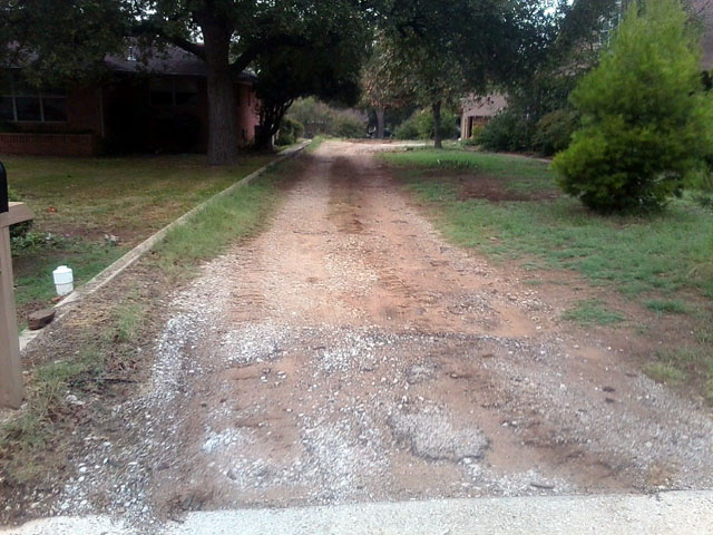

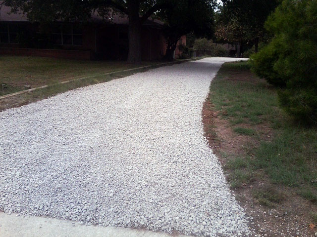

Yeah, you're out in God's Country as far as material goes Jim! The 4-6" I used here comes out of Sanger, so pricing is pretty good.

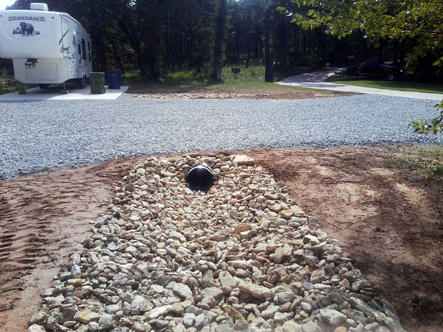

Finished up today.

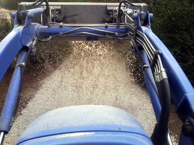

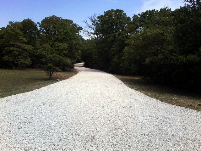

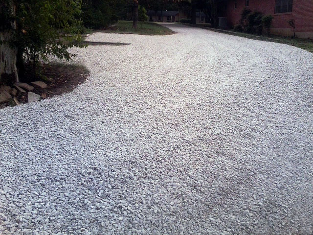

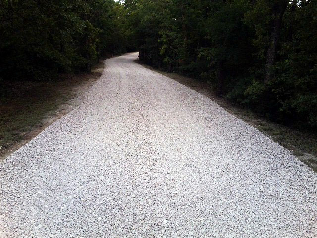

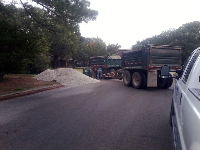

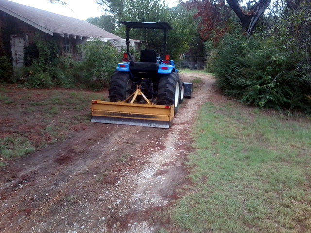

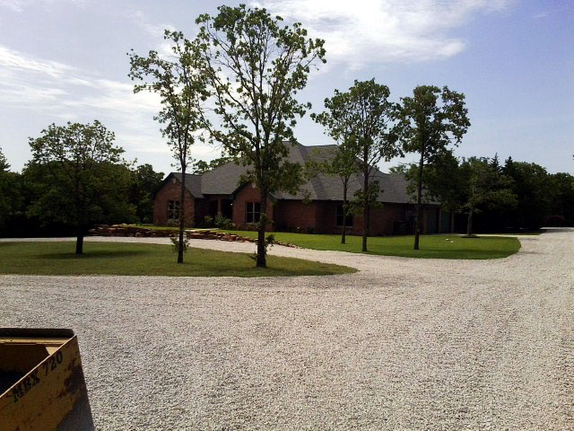

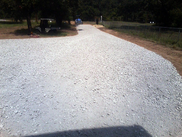

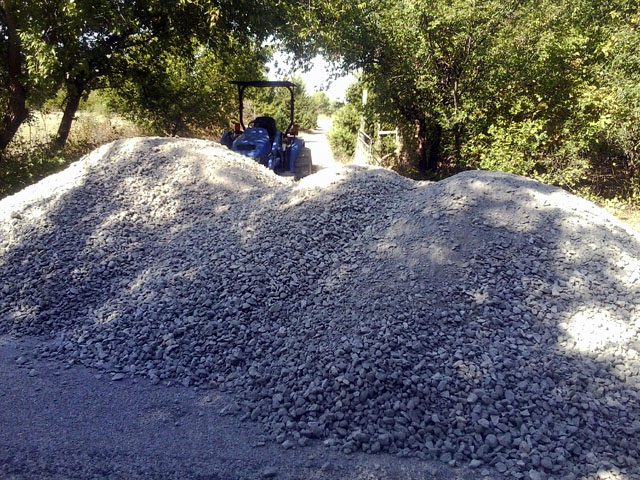

Re-graded and topped a 450 ft driveway today. The driveway had veins of limestone here and there and I pulled out quite a few basketball and larger rocks to get it to grade and repair the potholes. Then I mixed and placed 73 tons of road base over the whole thing. Unfortunately the driveway access and street were too narrow to back the truck and pup in, so I had to shuttle it all from the street. While I was grading I recovered a lot of road base in the garage area, so I used it to make the customer an area to turn their car around. Lots of poison ivy on both sides of the driveway to stay away from.

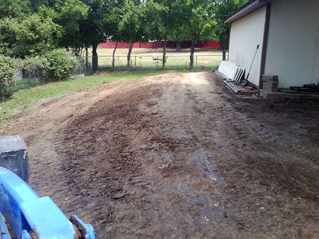

Working in the office today, but thought I'd share some grading photos and random stuff.
The homeowner got this "dirt" (and I use the term loosely) from a pool dig down the street. It wasn't real fun to try to grade it out. Unfortunately, he paid the driver for this junk when he was actually saving the guy money.

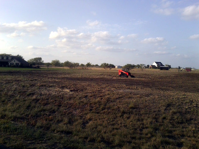

Here's a 2 acre build site before I brushogged it a couple of months ago. I'm back there now hauling rock out and I'll be back the first of the year to grade it. The builder used the lot for a dump site for all of the other lots. The buyer was a bit surprised when I give him my price. He thought that there were maybe a couple of dump truck loads...not quite.
My dump site is less than a mile from the job and isn't 10-wheeler accessible. I could have used a bobtail, but my rental place just got a 14k / 14 ft dump trailer in. It's not new anymore! :D Fifteen very heavy loads so far and a few to go. I'm leaving as much soil as possible and separating out the rock. Some of the rocks showing were just the tip of the iceberg.

Finished up the rock clearing project today. Separated and hauled off roughly 160 tons of rock, two loads of concrete and a few loads of rock/soil mix.

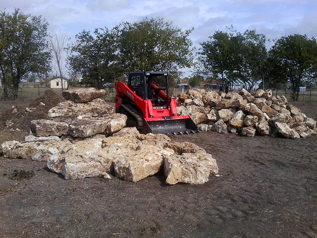

I got about half of the limestone slabs and boulders separated this morning, then headed out to look at a couple jobs. Hoping for rain to come in!

Do you have a market for those?
This limestone is pretty common around here, so usually there's not much of a market for it. Since the slabs were pretty decent, a local stone yard purchased them and they'll be coming out to pick them up tomorrow. Right now all of the rock is sitting at a future jobsite where I'll be excavating to double the size of a pond and stacking the stone semi-vertically on one of the banks so they can see it from their back porch.

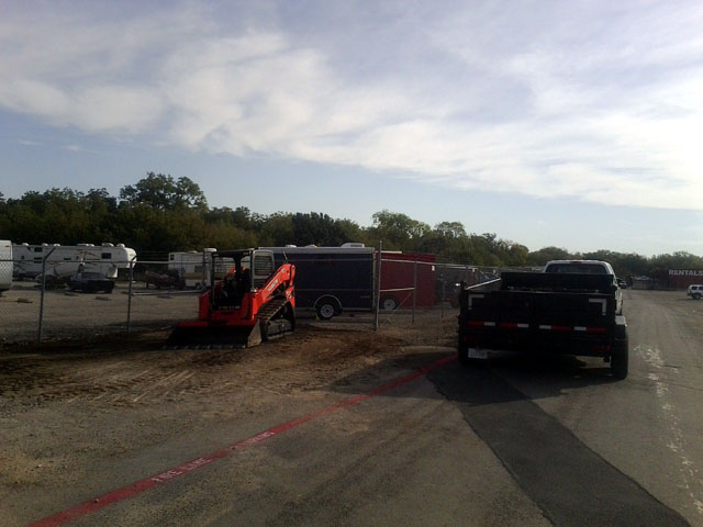

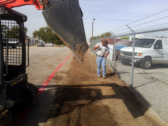

Started a project at a storage facility today. I had a friend call early this morning letting me know that he was out of work, so I had a helper! :thumbsup:
I found out two things today that I don't like about the Kubota CTL. The most annoying is that when the bucket is flat, it will not go lower than the bottom of the tracks. This is a real pita when spreading gravel since you can't use the heel of the bucket. This forces the use of the bucket edge which rolls up the larger rockl and separates it from the fines. The second is the slow dump mode that the bucket has. It makes it almost impossible to "flick" material.

The storage folks decided that they didn't want the material they chose for the topping in front of their new building (the last one burned to the ground). So I loaded it up and sent it back. The 3/4" road base they decided on couldn't be delivered until today, so I took the SVL75 back and I'll finish with my tractor which is supposed to be ready by noon today.

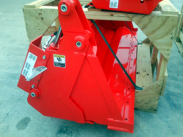

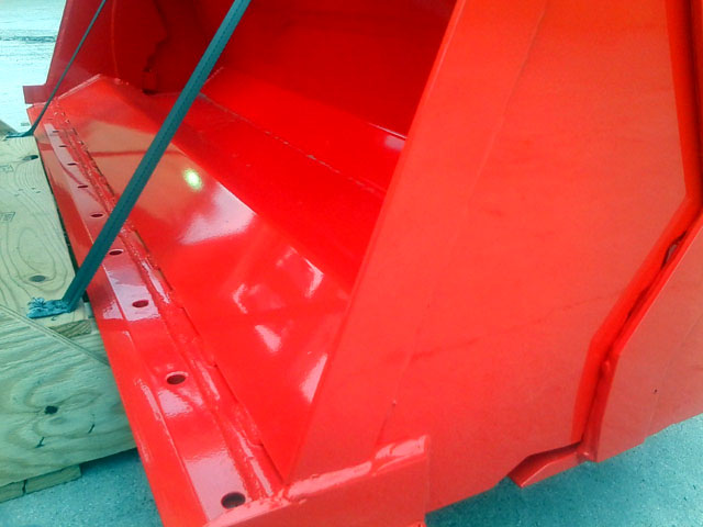

While I was at the Kubota dealership I took a couple eye candy photos. I really like the stout v-brace in the bottom of their 4in1 bucket and the plates protecting the cylinders.

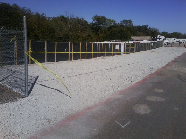

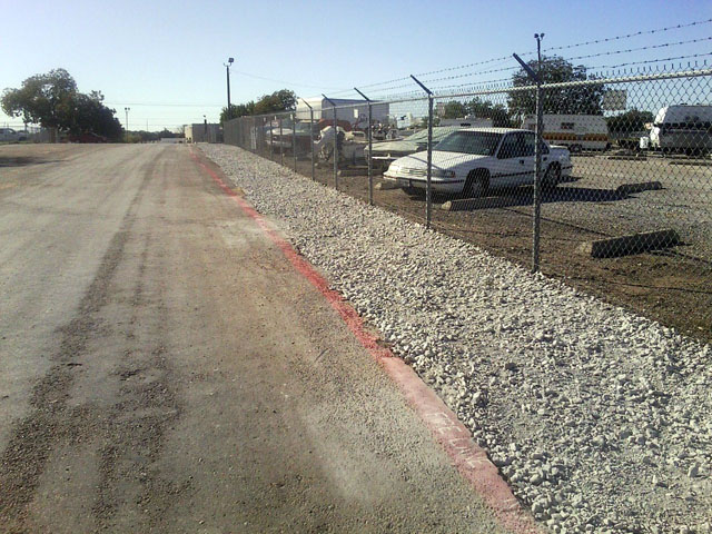

Back at the storage facility today. This job is very frustrating for me since I like all of my work to look...well...perfect. At least as perfect as I can make it. There is no straight edge to work with on the asphalt. It's been patched and broken off so many times its a mess. Some areas have poured concrete and asphalt underneath the road base. Thin here, thick there. I swear the guy that painted the red line was drunk. To paraphrase one of the members on another forum...If it looks like crap when I get there, its gonna look like smooth crap when I leave!

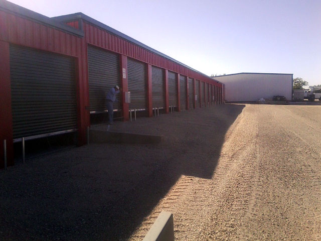

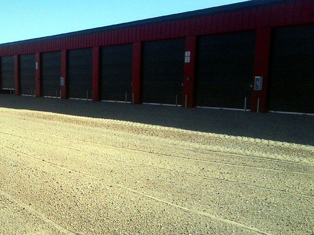

I spread some 3/4" road base about 15 ft wide in front of a new storage building. The last one burned down so I removed about 2" of whatever was there. It looked like flex base, broken asphalt, recycled concrete, 5/8" stone and pea gravel. It was full of burned junk the fire department pulled out, demo material, and screws and debris from the guys working on the new building. Then I spread the new material and blended it into the existing. I experimented with the blade depth on my landplane a bit. Works pretty good!
I'll go back in the morning and roll everything. Seems like this job is taking forever. This storage place is really busy during the daytime. While I'm trying to work people keep parking in my work area and even in front of my material piles.
