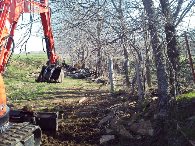

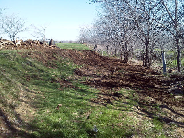

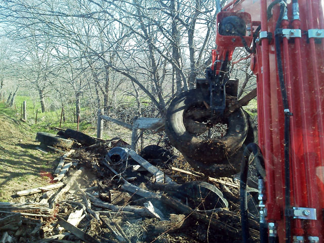

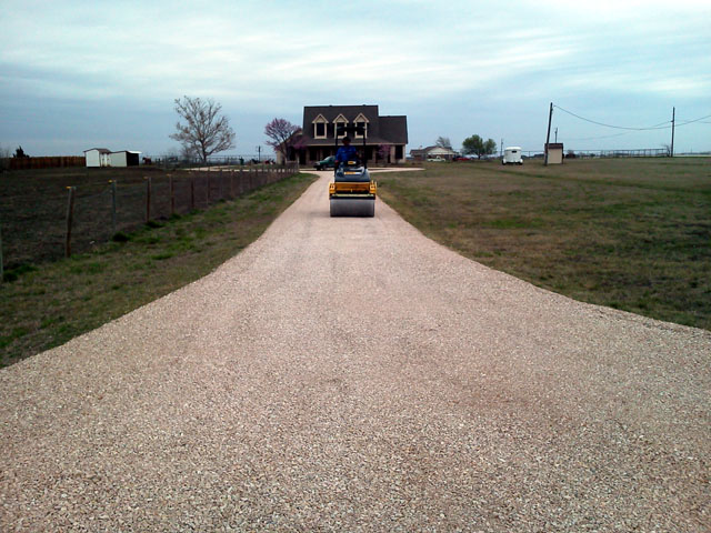

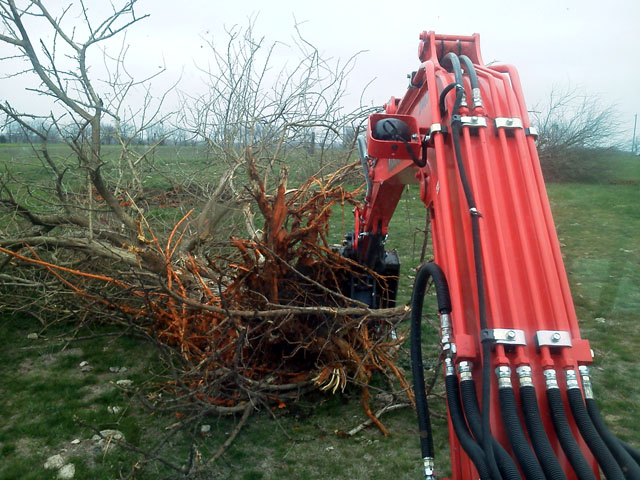

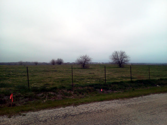

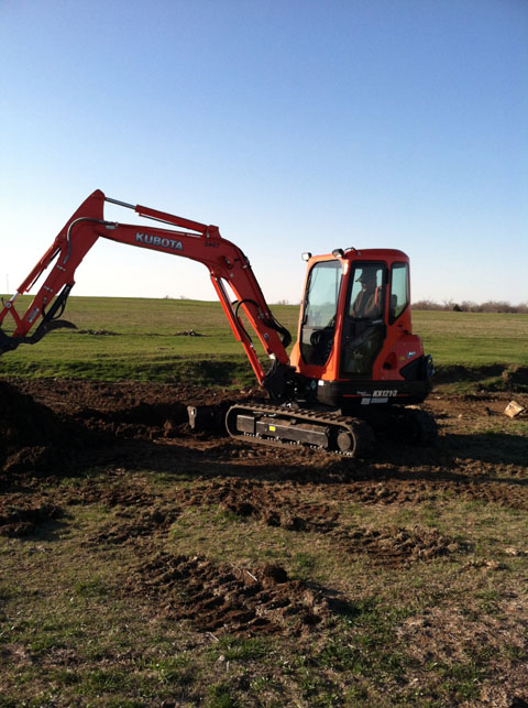

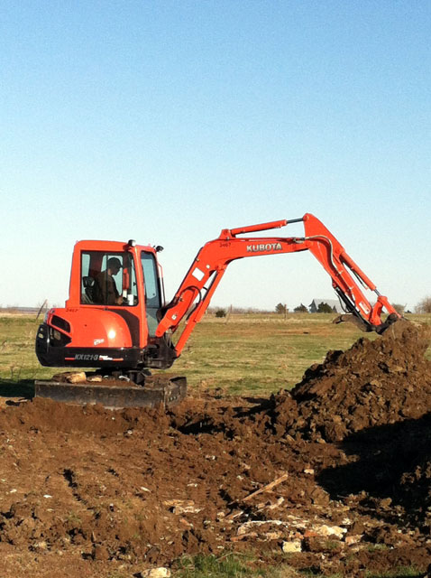

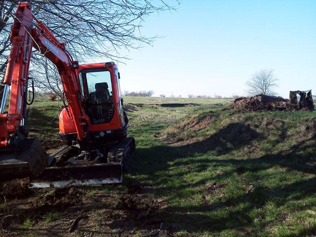

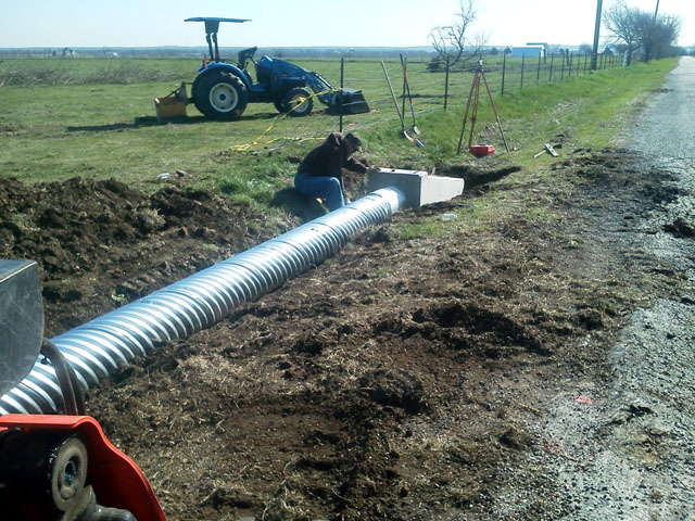

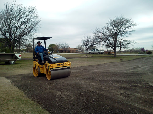

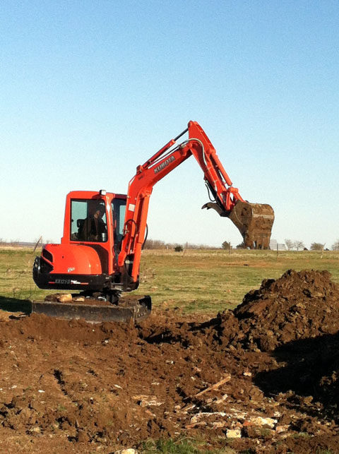

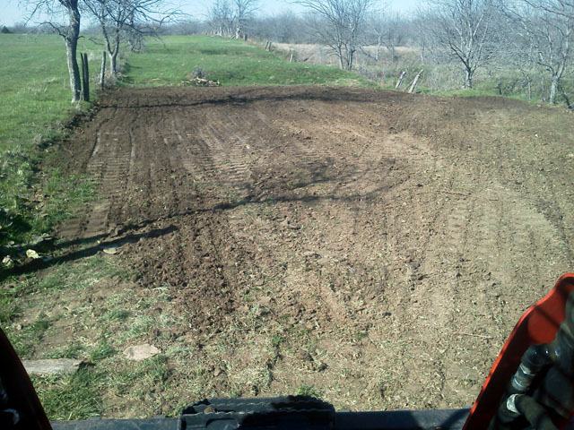

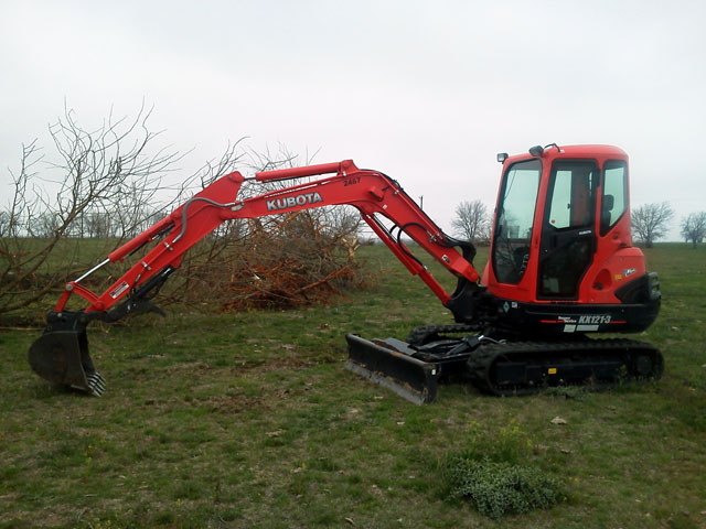

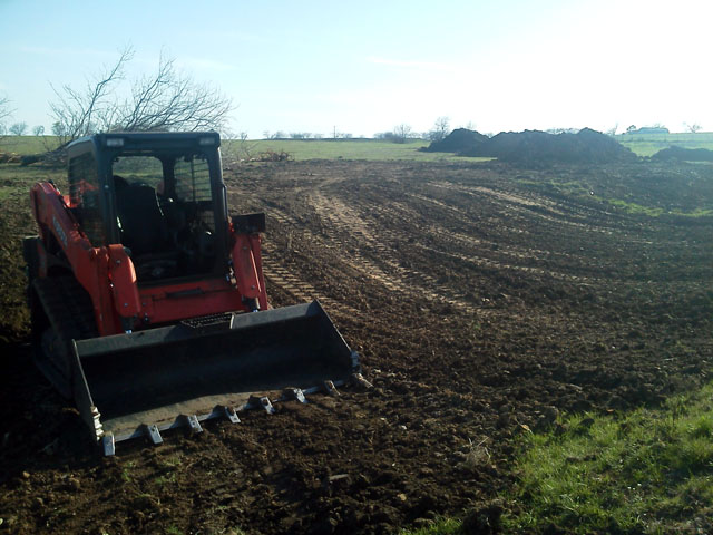

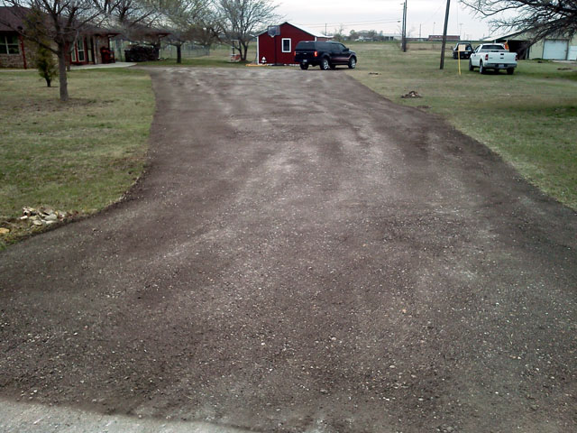

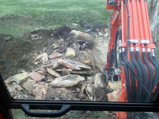

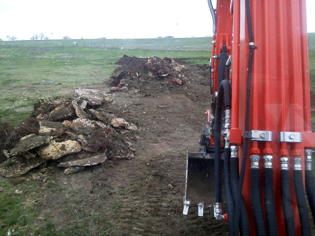

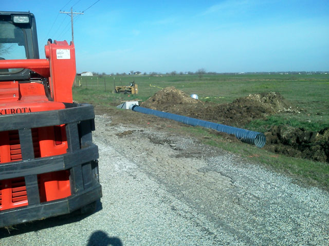

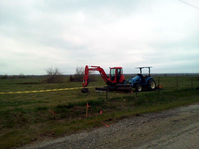

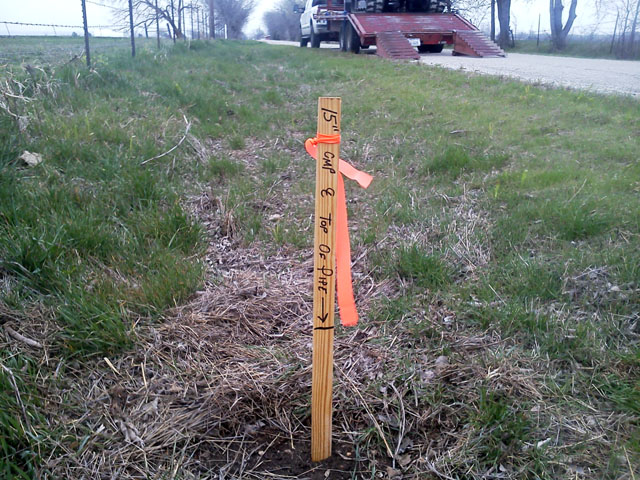

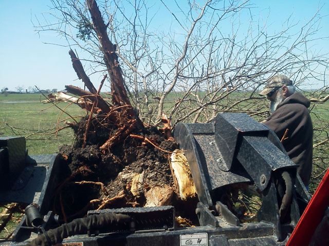

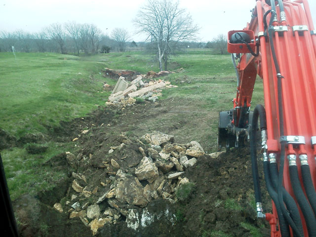

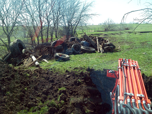

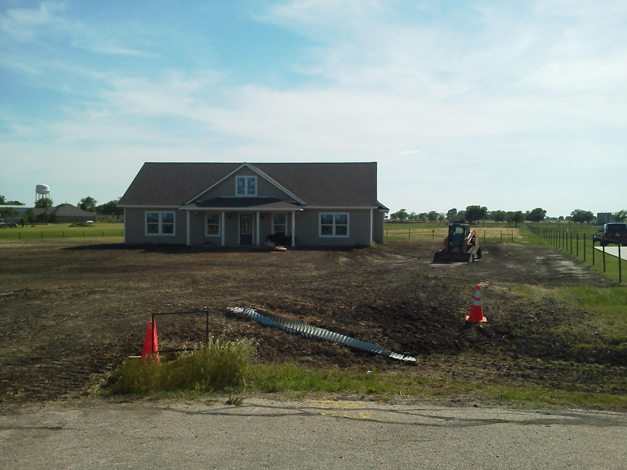

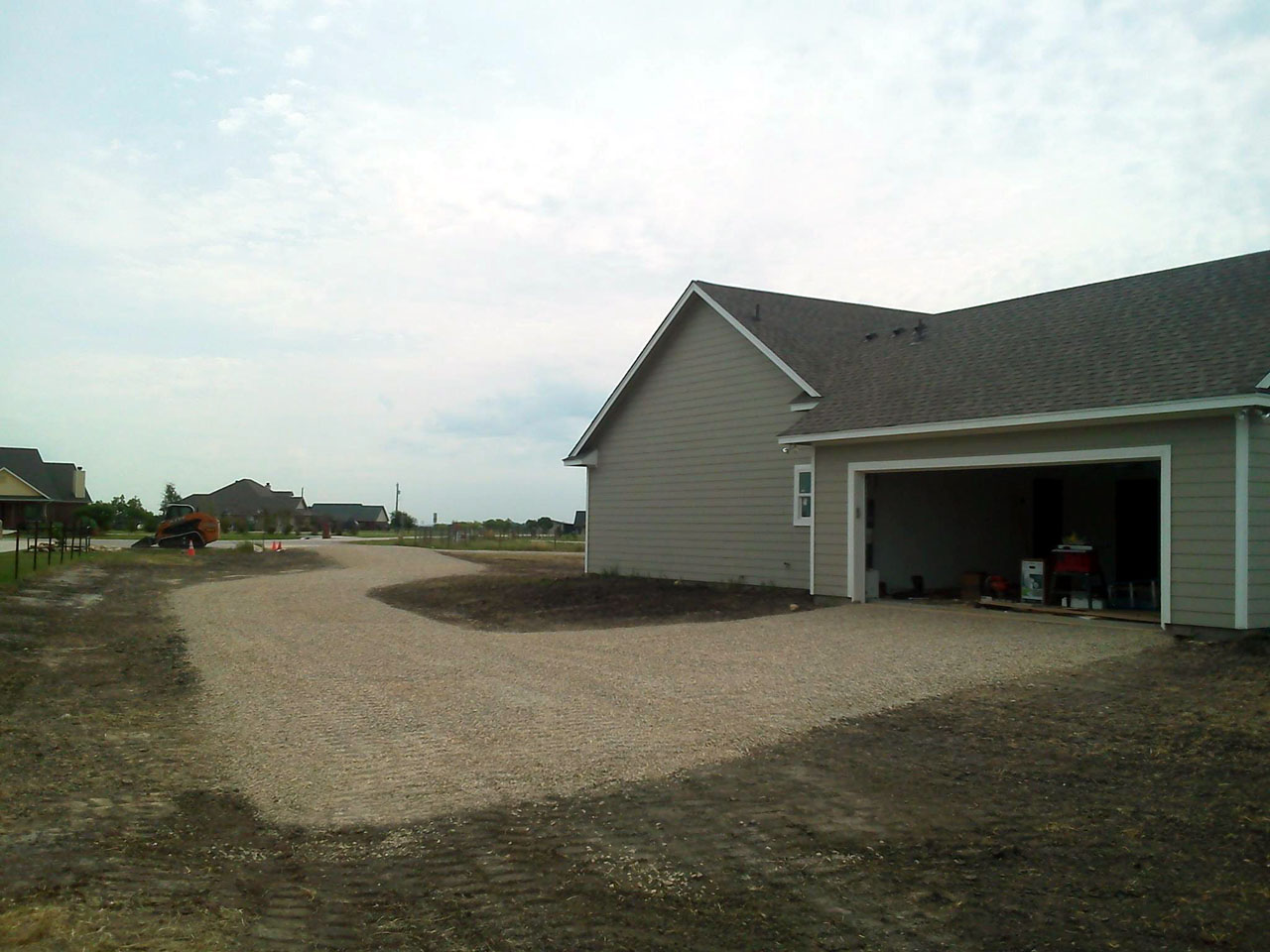

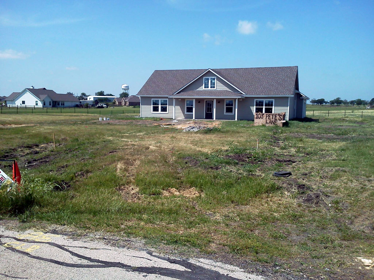

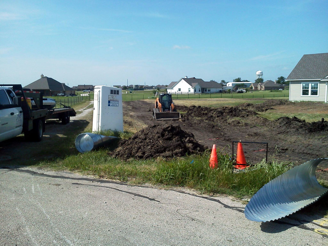

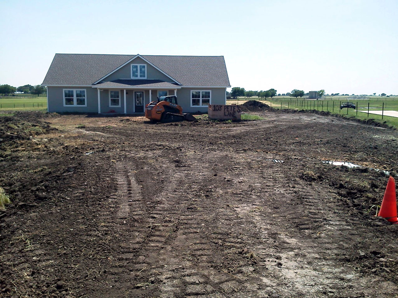

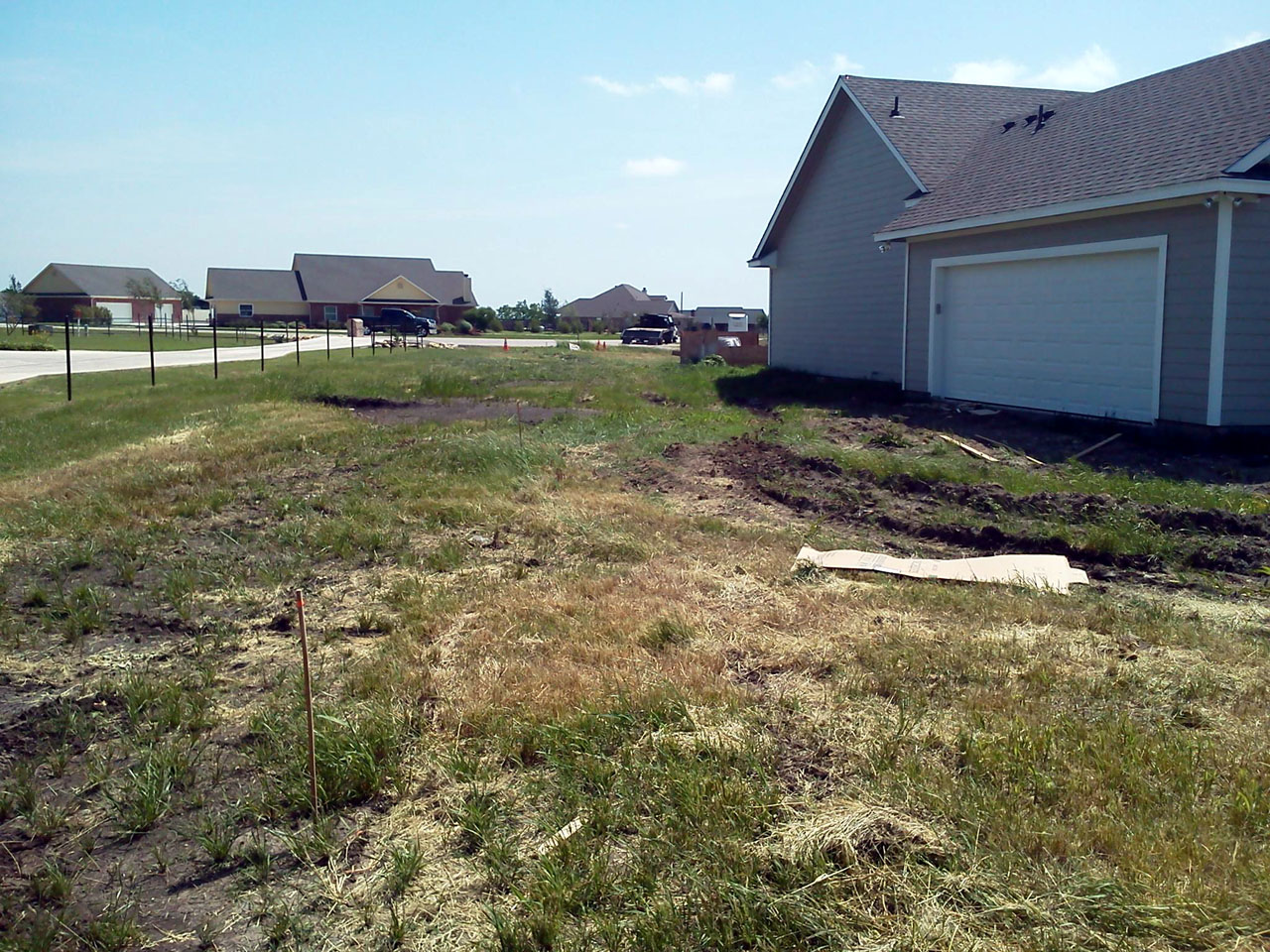

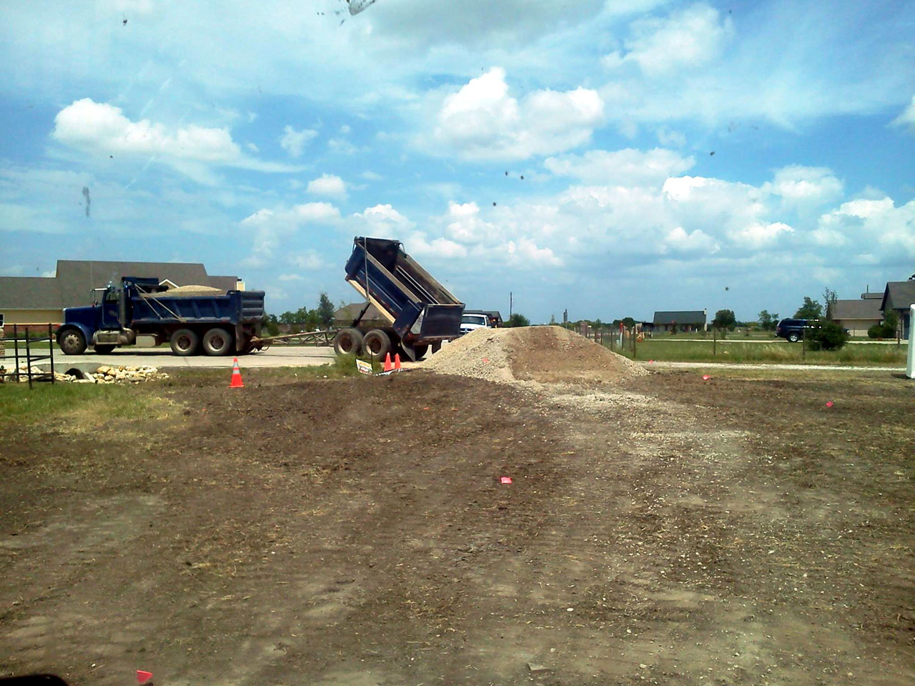

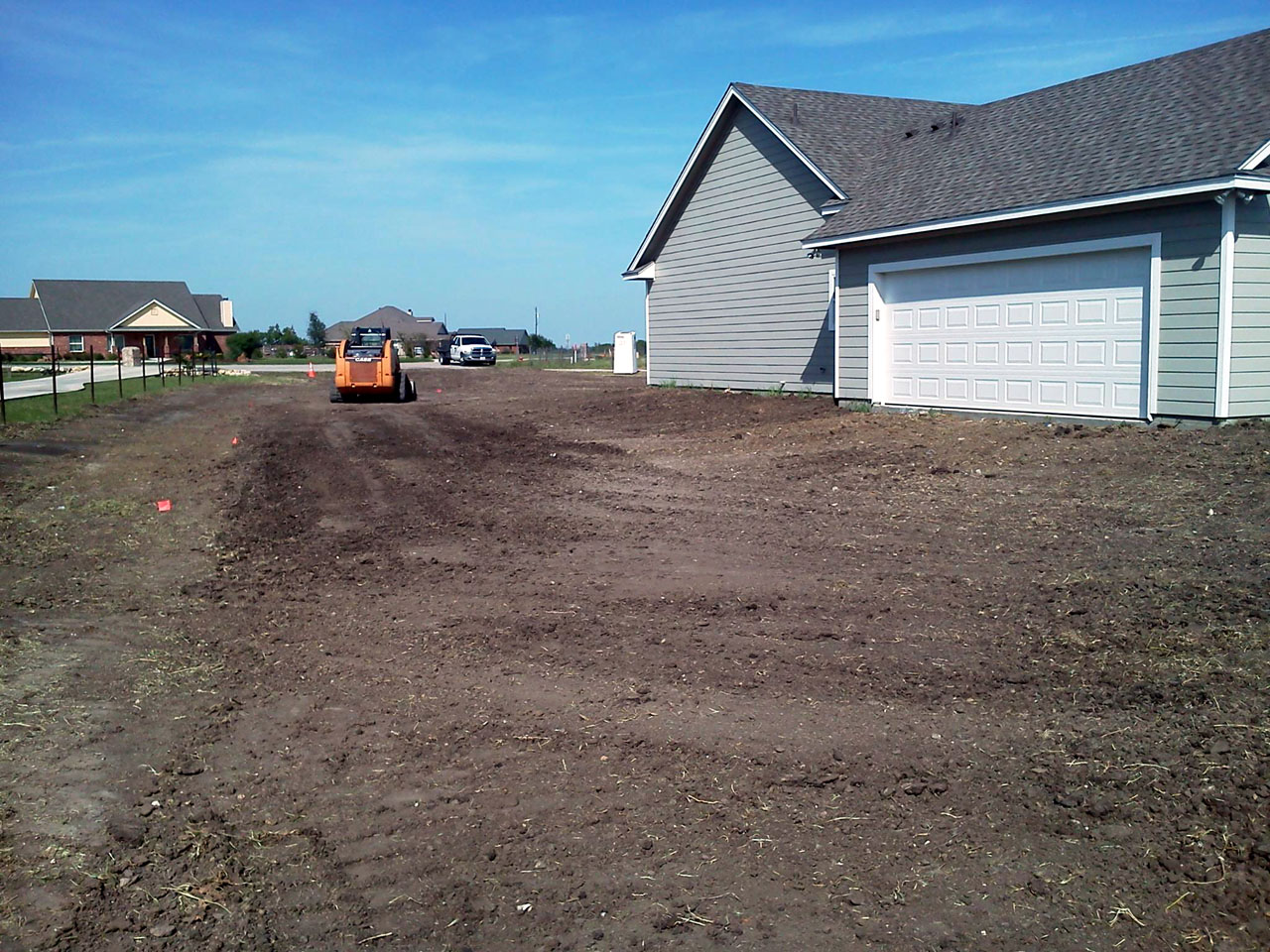

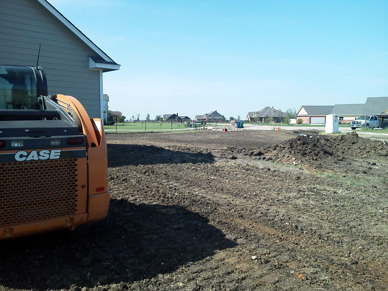

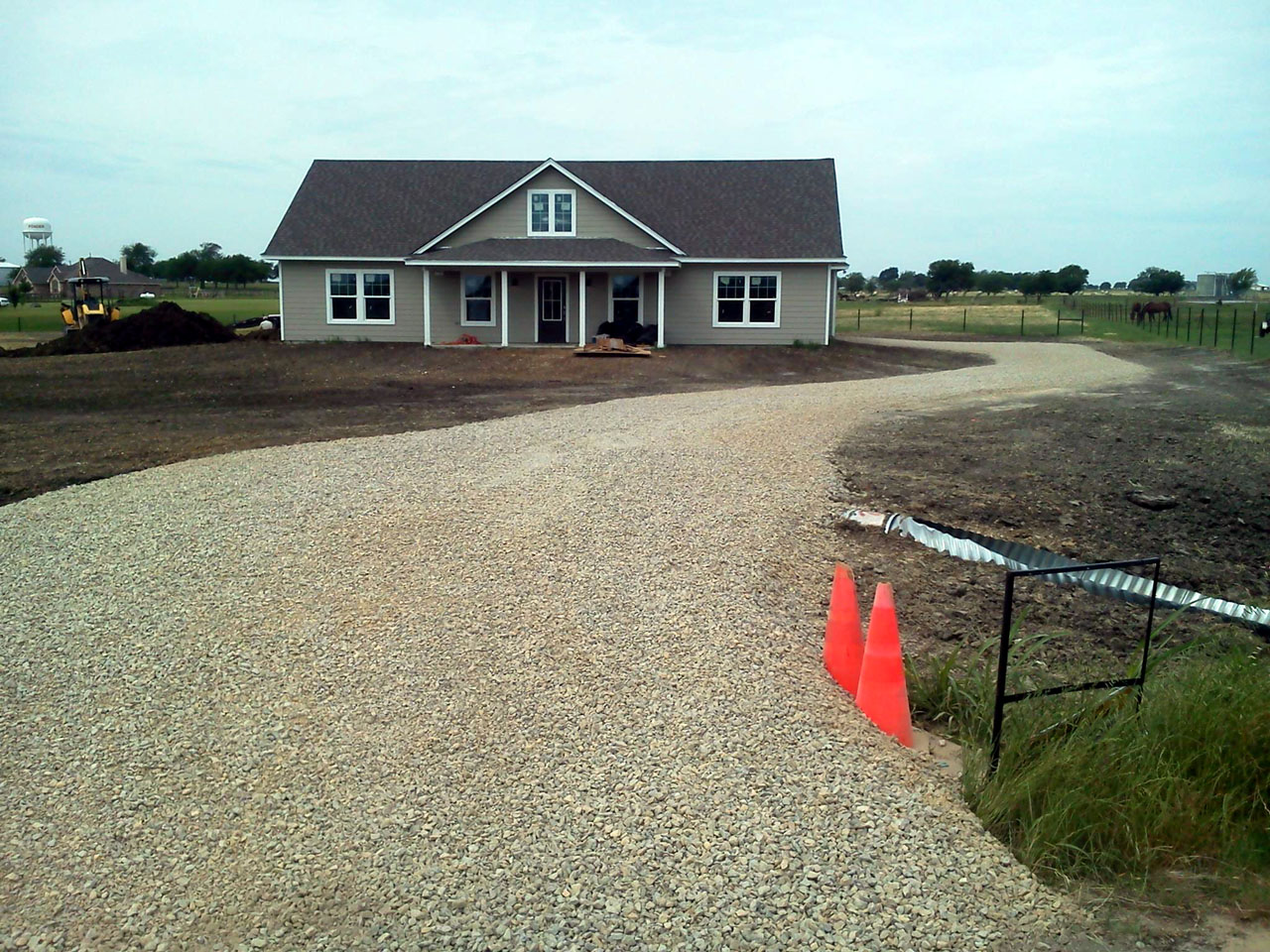

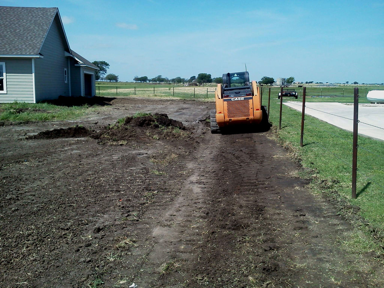

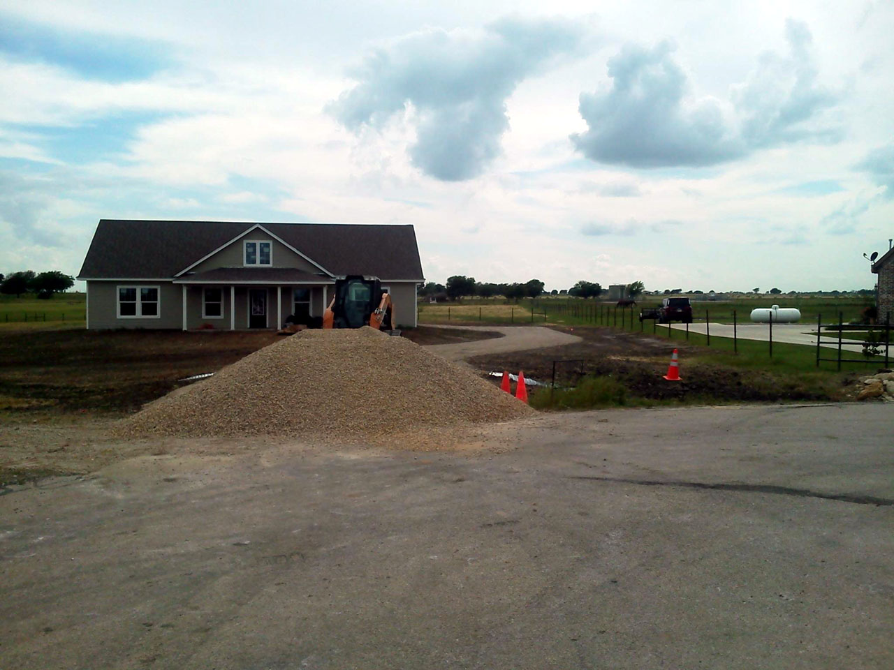

Here's a few from a grading, culvert and driveway job last week. My mission...get it done with no imported dirt. And in a first for me, the homeowner will be pouring the concrete culvert ends himself.

Assuming the topsoil gets put back (on the top) once you get grade, si?

The black clay in this area is pretty fertile down to about 8". It's a real expansive and a pita to grade, which is why lime is mixed in on commercial jobs where importing good dirt would be too expensive. If you cut it right to grade and run over it with a compactor, it's full of lumps and bumps. For yards and such I cut it down about 4'-6" below my final grade, pile it, mix it, then spread it back out heavy and cut it one time.
Any decent soil without organic in it gets stacked and used to profile the driveway.

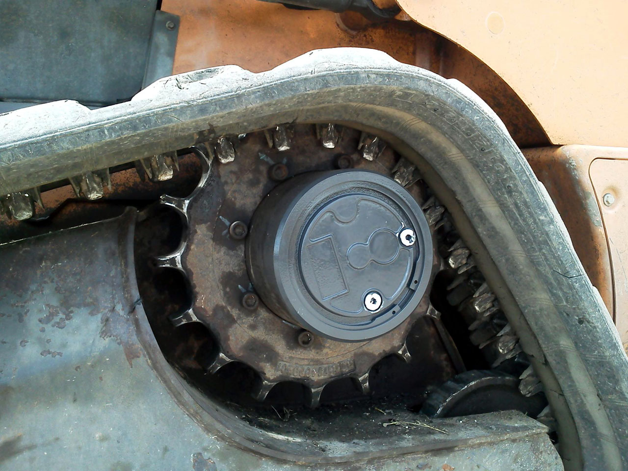

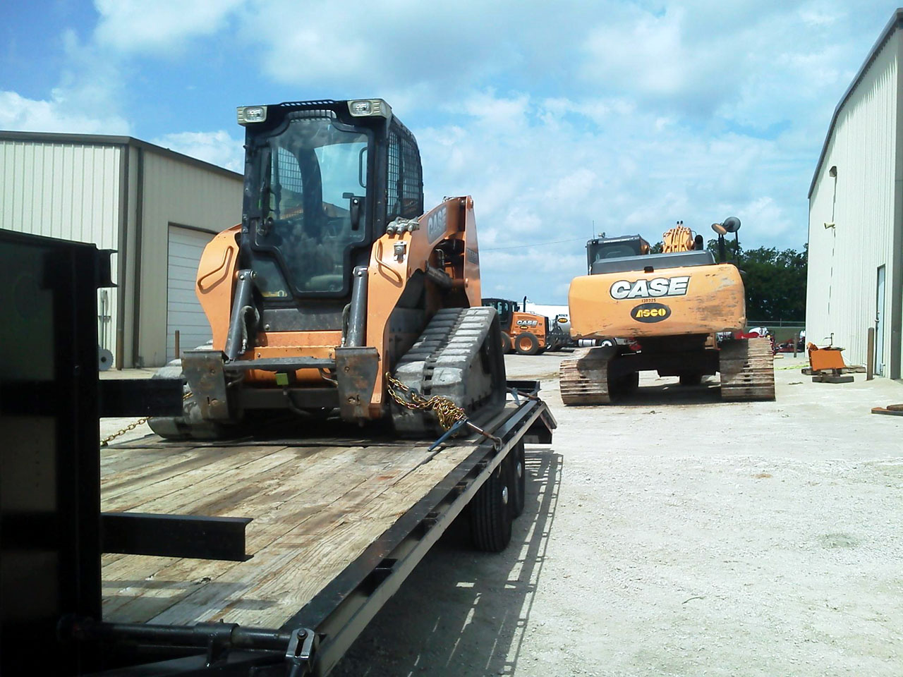

I picked up the TR today.
Here's what a $5400 repair looks like.

Yes it does, but it could've been worse. It pays to shop around...and country boys got your back. Two ASCO dealerships, one in Euless and one in Sherman. The estimate from Euless...$7k+. From Sherman...$5.7k. Sherman came in $300 under their estimate and threw in a few freebees including the latest joystick software update and sleeving the hydraulic hoses that blew. The machine was ready to pickup the same day the drivemotor came in too. They also provided a cab equipped rental for $275 a day. They've earned my business, that's for sure.

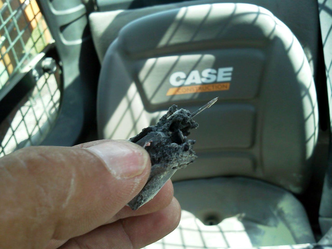

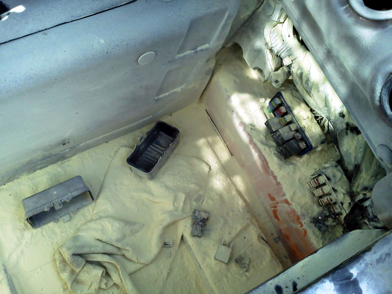

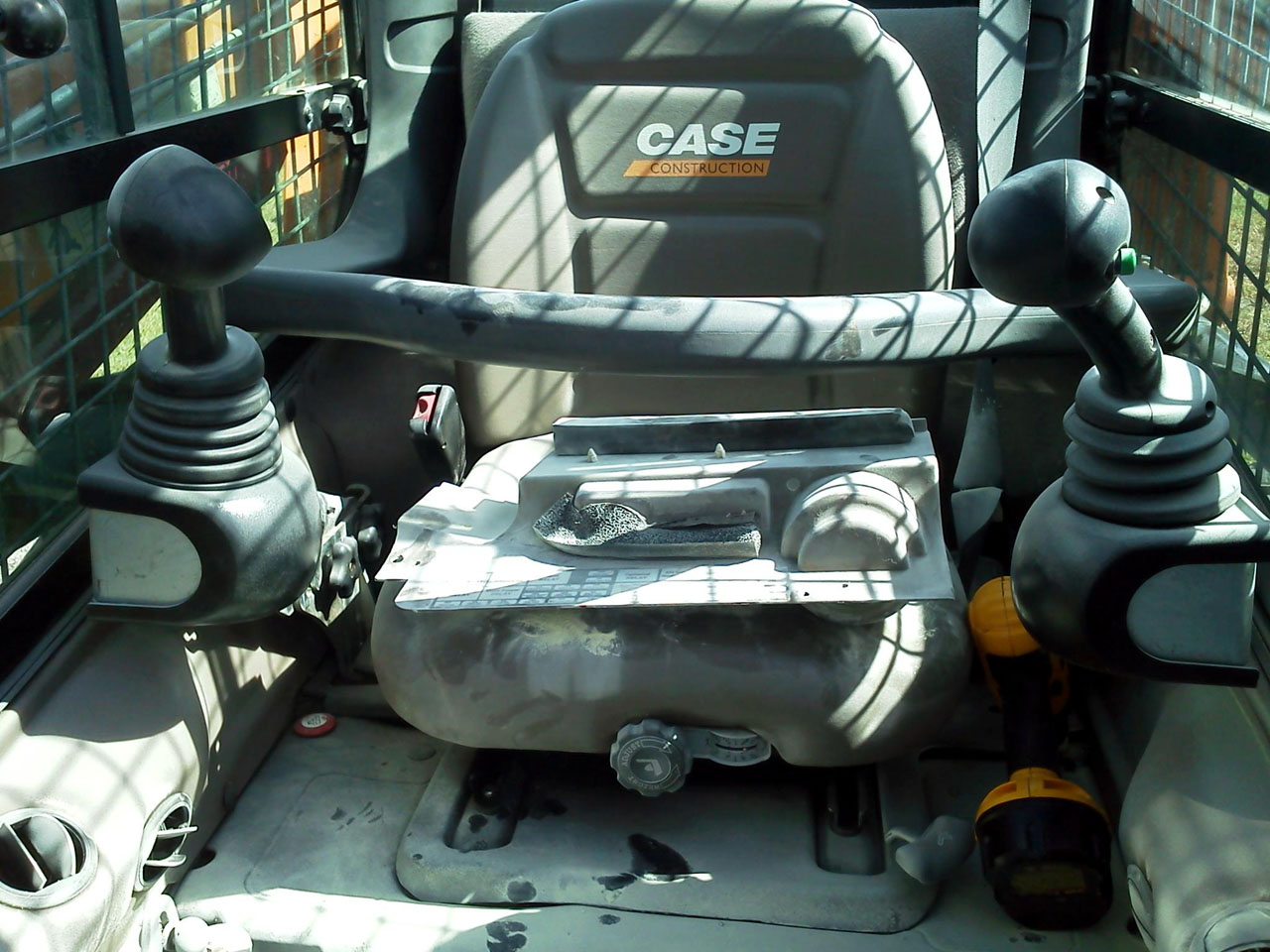

Unloaded my CASE TR320 from the trailer after the drivemotor/hydraulic hose repair, hooked up the bucket and parked it last week. It's been sitting there ever since. The total cost for the repair including the service tech call and towing of the dead machine... a shade over $7k.
This afternoon I walk out to the shop and hear the hydraulic cooling fan on the engine lid of my CASE TR320 CTL running. Since it rained last night, I thought that maybe the connector at the fan motor had gotten wet. When I opened the cab door I found the HVAC motor running and smelled burning electrical. At that moment smoke started pouring from behind the cup holder! I grabbed my fire extinguisher from the shop and shot it in there and removed the cup holder panel. The smoke was coming from the front (accessory) fuse/relay distribution block. When I removed the cover flames started coming out of the distribution block!
While I'm trying to pull out the burning relays, my wife's grandfather was trying to get the positive battery cable unhooked. After burning the heck out of my fingers removing the relays and dosing the area with fire extinguisher contents, he gets the battery disconnected and I get the fire under control.
#1 My fuse blocks are both mounted upside down, so it took me awhile to figure out which relays had fried. Turns out it was the EH (electric/hydraulic) Control Module relay and Option Relay. In the upside down configuration, the relays are mounted directly underneath the door seal.
#2 The accessory fuse box melted. The dealer tells me that to repair it they have to replace the entire harness, which includes removing the engine. $5000 minimum for the repair!!
I'm so ******* ****** off right now I could eat bricks! My lungs are full of fire extinguisher crud and smoke. If it was water that shorted something out, wouldn't a fuse blow? What about all of the machines without a cab? Those fuse boxes have no protection at all from the elements. Did the dealer pinch off wires somewhere when they had the cab up for two weeks? And just how do I prove that?
I'll call CASE once again to start an incident number, but them saying that they will help out is very unlikely. From my prior conversations with them they're about as helpful as **** on a ****.
This is a freaking 2012 machine with less than 850 hrs on it! One drivemotor/final and two electrical panel replacements under warranty...Now a blown hydraulic hose to the drivemotor, one more drivemotor/final drive replaced AND an electrical fire!
