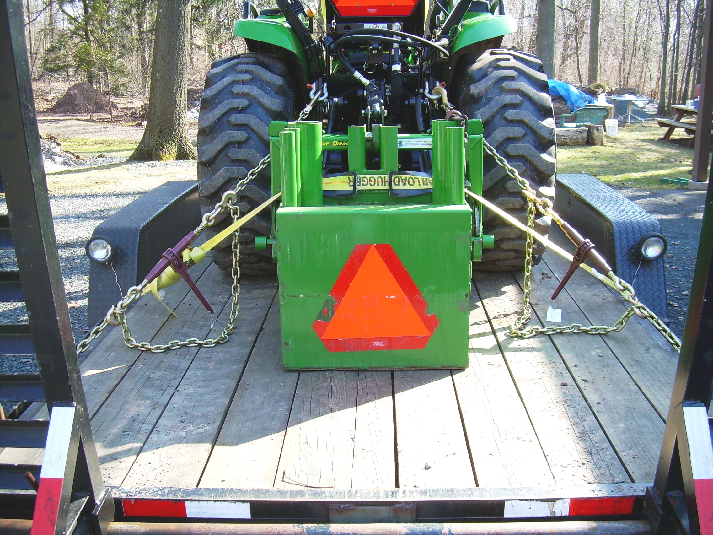

Many of the tractor trailer rigs I see on the Interstate are now using straps where they all use to use chains exclusively. Where I bought my tractor, they sell and recommend straps. I rarely haul mine anywhere, but when I do, I use straps, when I haul a big tractor or truck, I always use chains and binders though.
/ Ratchet straps or chains? #44
Which is better- a ratchet strap rated at 3500 lbs or a chain rated at 3500 lbs?
In my opinion, they both are.
It depends on what they are used for and how they are used based on load specs and the work that needs done. Straps work well for me. Chains work well too. They each have their purpose. One is not just "better" than another.
If a strap breaks because of improper use, don't blame the strap!
Any edge will cut through a strap with a load on it.
Best to go hook to hook without the strap contacting any edge.
IMO, strap failures are caused by the wrong application, not because they are nylon.
2.5" nylon ratchet straps have been used without problem when trailering my BX2200 .
Read the specs when buying either straps or chain.

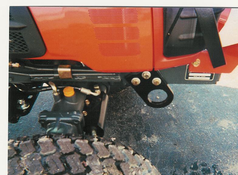

My machine is in tow every week so i installed brackets to chain through.
That looks like a really good idea, I am going to look for someplace on mine to do the same.
Yeah, that looks good, nice and high, better than the draw bar where I see alot connected to. with it higher up your really pulling the machine down when binding, not just sideways.

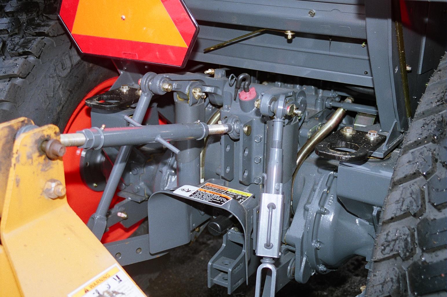

Mine is similar.
JB.

Front brackets.
