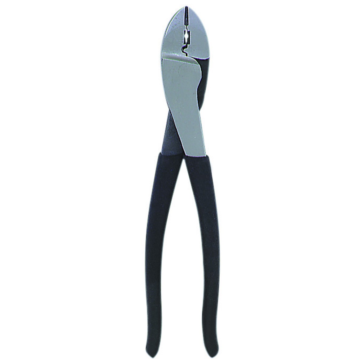

Since the area is not exposed to weather, I would get a box of name brand butt splices. Stacon or similar. A wire stripper and a crimper.... add a few inches to the harness to ease your working area.... go to town on it.
Remember. you can use a bigger wire size but not a smaller gauge wire in your splicing.
