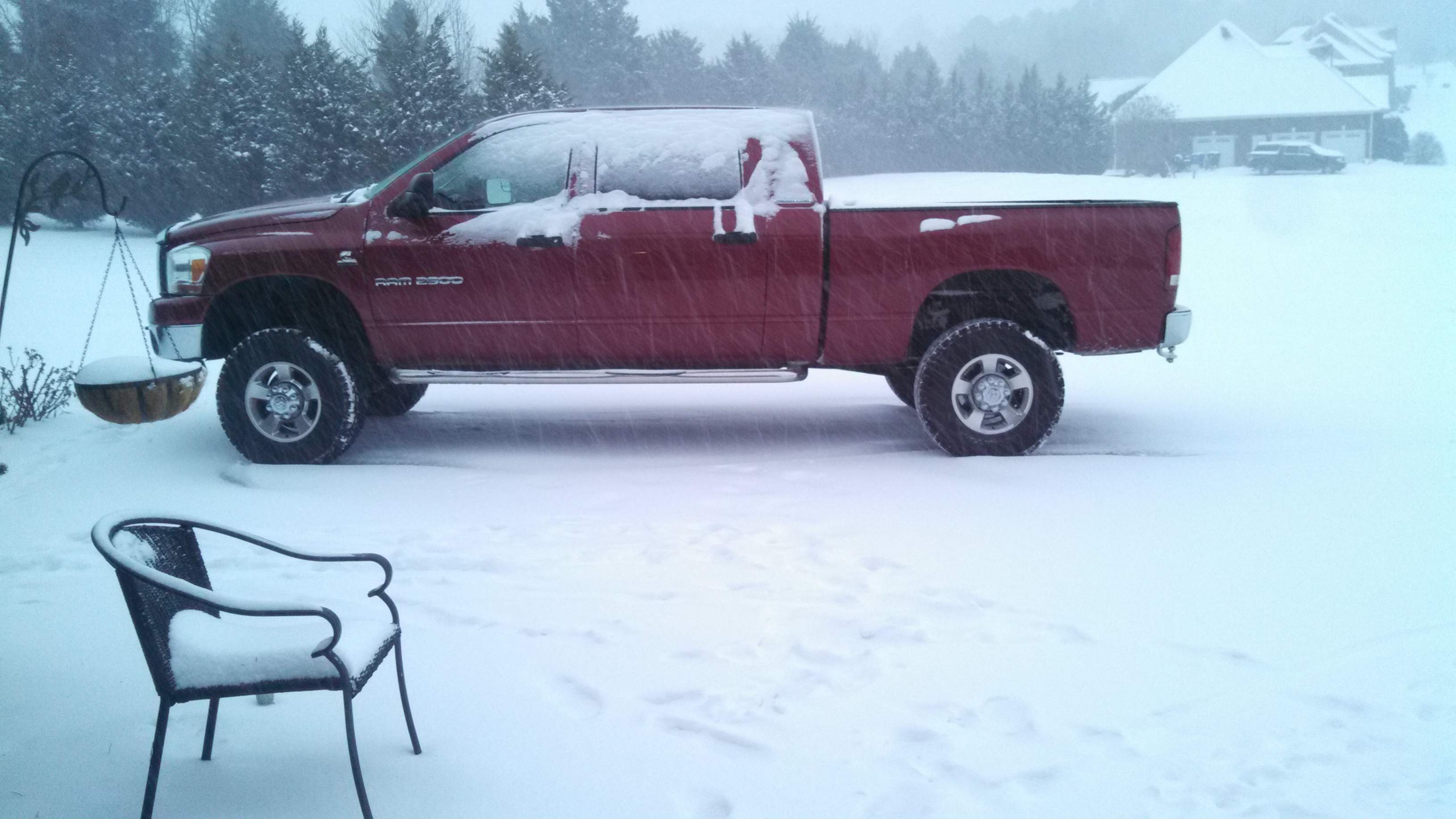

Congratulations! Good looking truck. Do come back and keep us posted on how it does over the next 10,000-50,000 miles.
Figured I'd give an update. The truck has a little over 288,000 mi on it now. Last summer I replaced the u-joints in the rear drive shaft. Last Fall I replaced the rear pads (due for the fronts soon I think). New tires in August and due for a new set about a month ago.
I need to change the front diff pinion seal, all of the ball joints, and the seal at the rear drive shaft / transfer case connection.
The engine light cam on about a week ago, so I need to see what that's about, but it came on when I activated the engine brake. I figured I would take a peek at the air filter and noticed that the air intake tube where it connects to the filter box lid was half off (not sure how that happened as I never took it off). I got that back in place, but the light is still on, so I'll stop and get it scanned at the parts store to see what is says.
I use it as a daily driver and to tow my 16 ft gooseneck dump (4,200 lbs empty). I think I tend to overload the truck at times and have had to keep it in 1st gear to make it up one of the roads by my house. I really wish it had 4.10's at times instead of the 3.73's.

Seems like it's wearing good for how you use it. Take care of them 10 small items ASAP or it will mound up and lead to bigger issues. These are the Nickel and Dime items I was speaking of.
Chris
/ RAM 3500 Question #59
I'm not sure if this works on the newer trucks or not, but you can cycle the key on my truck to get the codes out of it yourself. You turn the key off and on three times leaving it on the last time. Do this without starting it and it will display the error codes in the odometer window.
Funny you post this but someone is replacing my rear u-joints at this exact moment, took it in the shop toady. Its one of those things I could do myself probably but don't feel like it.
Good luck with the truck and thanks for the update and pics.
