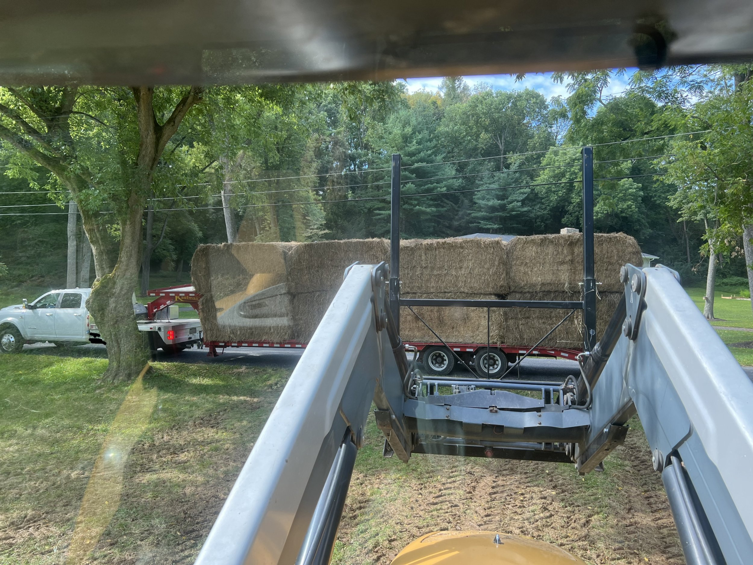

As far as jumping from Ford to Ram, you will probably be happier. I was long time Ford or GM in smaller trucks and made the jump in 2020 to Ram.
I’m sure I would have liked any of the 3 in 2020, but Ram was cheaper and in my opinion better and the specs were better. GM version of 5500 too big and lacked GCWR that I needed. Ford was a bad experience for me, so a change was warranted.
These Rams were built to tow and they can tow massive amounts of weight. I never suggest anyone overload their truck, but I have had to on several occasions and the truck never skipped a beat.
14K bumper pull or larger 5th wheel is nothing. Here’s mine with 19 tons of hay and a GN trailer.
