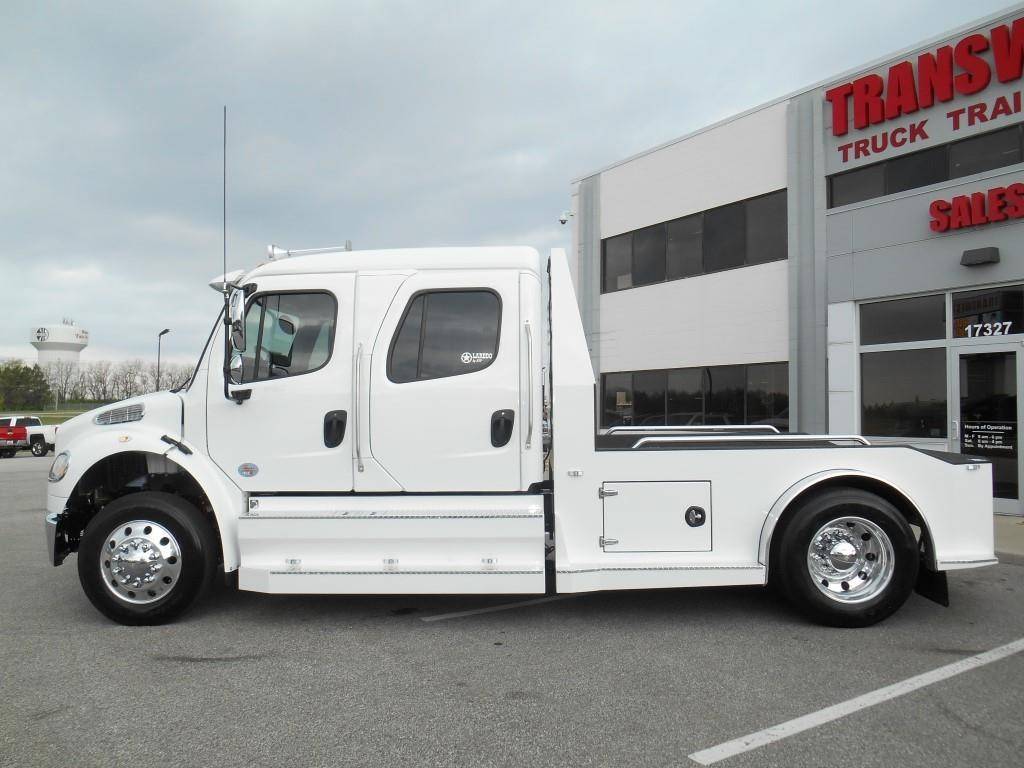

The medium duty trucks are a lot better value for towing. And tow way better than a pickup. I see pretty nice daycab road tractors for 10k or decent ones for 5k. And no CDL needed for private RV use.
This is the pleasure horse industry and most of them are pretty spoiled.:p My ideal truck is about 65k new, the M2 is 155 :shocked: oh yeah, crew cab and 4x are necessary standards cause we usually park in someone’s hayfield
