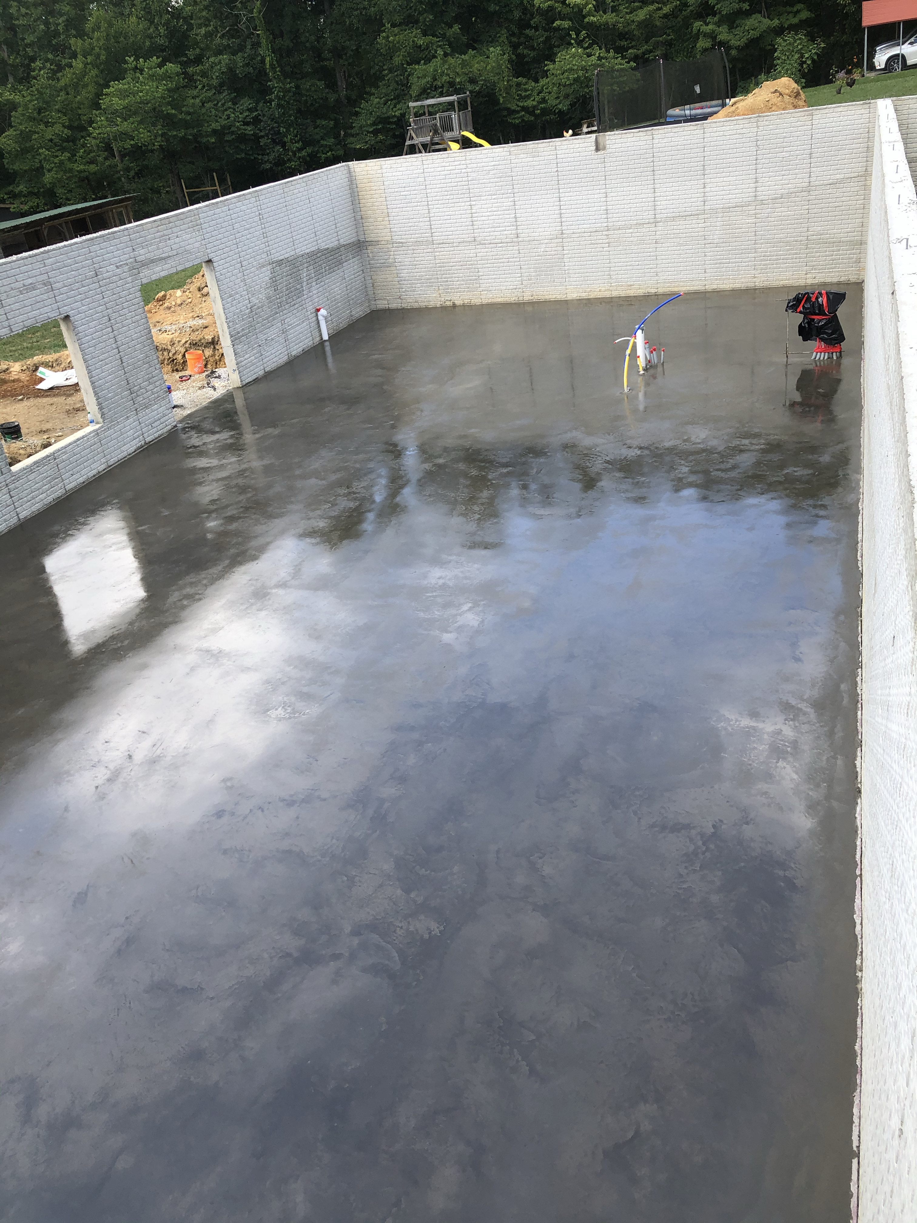

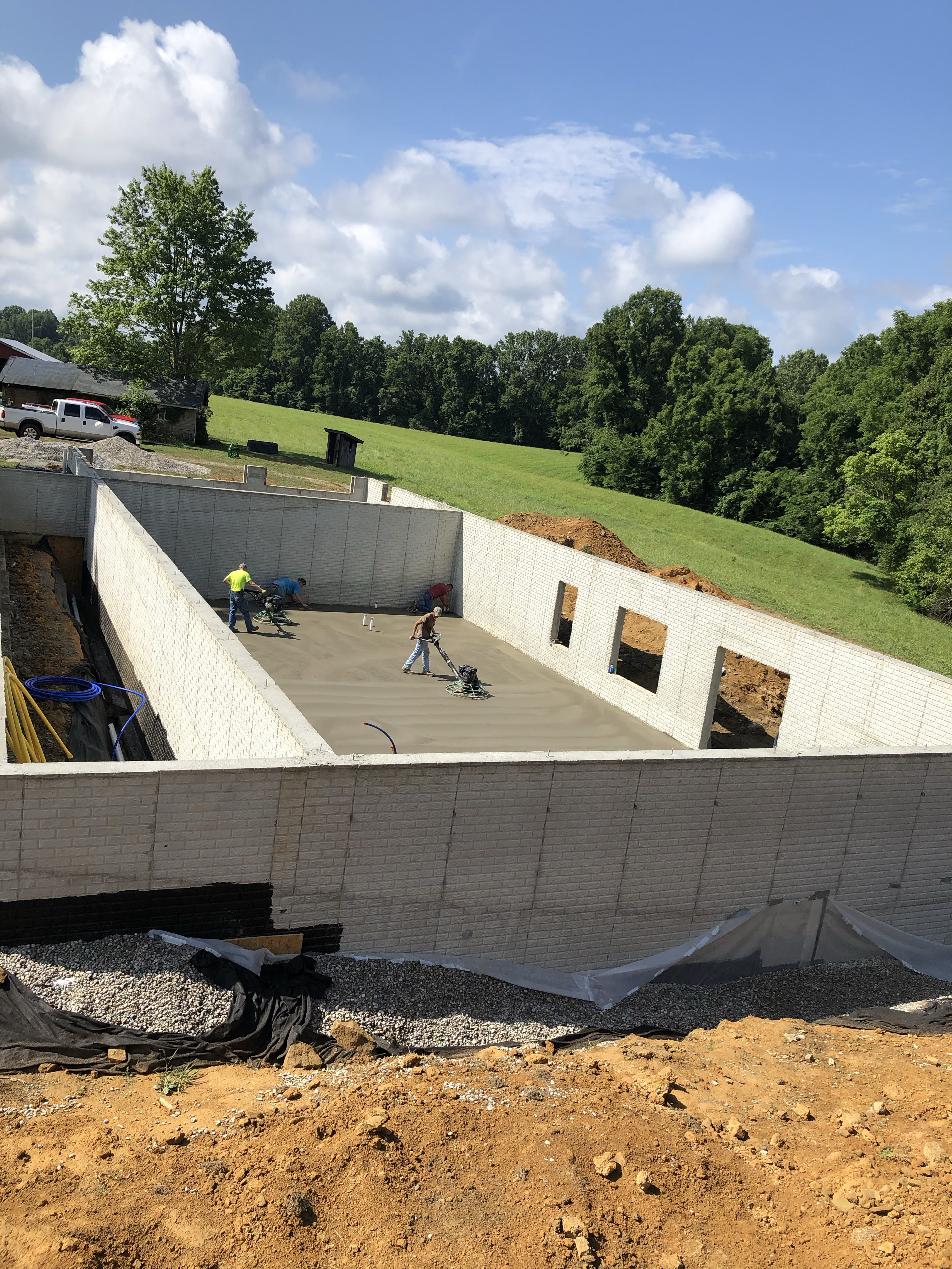

I purchased part of the insulation yesterday, but no one has enough in one place, so will accumulate the rest by the weekend. Pex will be delivered tomorrow, again, no one local carries more than one or two 300’ foot spools in stock and the pricing locally is insane.
This weekend I will begin the installation and hopefully it goes well since concrete is scheduled for next Friday. I’ll be relieved when it’s done, moving all the gravel has been exhausting. Lumber shows up next Tuesday so it’s just about time to move on to the next step!
Thanks for all the advice! I’ll get to starting a build thread as soon as I can get in the house before 10pm!

The ground is sloping all around the basement with about 40’ of the back being full daylight with a French door and a couple windows. There will be a 10’ deep porch over the daylight portion.
The radiant is just to make the basement comfortable in the winter without a separate furnace. I probably could have gotten by with a couple wall mount gas heaters, to be honest, but just like the idea of the radiant and figure I might as well give it a go since it cannot be added later.
We have a main natural gas pipeline crossing our property, and get near free gas, so heating with anything electric, like mini splits, is out. If I were doing an electric system, mini splits is likely the way I’d go, or maybe geothermal.
A nice efficient natural gas system should serve me well and cost very little to run, heat wise. I may still run radiant loops under the main floor bathrooms at some point to warm the floors, but that is down the road if I find it’s needed/wanted.
Finished running the 6th pex loop just before dark, will do the last one tomorrow morning before work and hook the manifold up tomorrow evening to test with air. May have to take Thursday off work to get everything finished up. Concrete, pumper, and a crew to pour/finish are scheduled for 6am Friday. Now just have to hope for no rain.
We are building the house our selves and only hiring out the things that we simply can’t do, or just wouldn’t be timely to do, like shingles, drywall, concrete, etc., but I’m hoping after Friday I will have time to start a build thread with pictures and all that. A big load of lumber arrived today and a second is scheduled for Friday afternoon, and will be everything to get me to the top of the walls ready for trusses, so won’t be a lot of rest going on here for a while.

I definitely hope the heated floors turn out to be enjoyable. We won’t use the basement for full time living but we do have plans to regularly make use of the space.
Last pex run is complete, I’ll tidy up where they come through the floor and install the manifold this evening.
I appreciate all the advice given.
Unfortunately, I probably won’t get to see how well it works until late this winter or the following winter. I hope to be in the house by Christmas, but with the amount of work we are doing ourselves, that could be optimistic, depending on how much help I can round up throughout the building process.
I’ll get a build thread going this weekend, so anyone who wants to follow along can do so.
