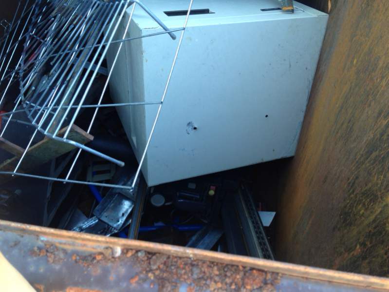

The more I thought about it, the less enamored I was with the idea. (Sorry, Shiny Steve) Did a major shop clean up last week and well...this is where it now resides
image-695265188.jpg Terry

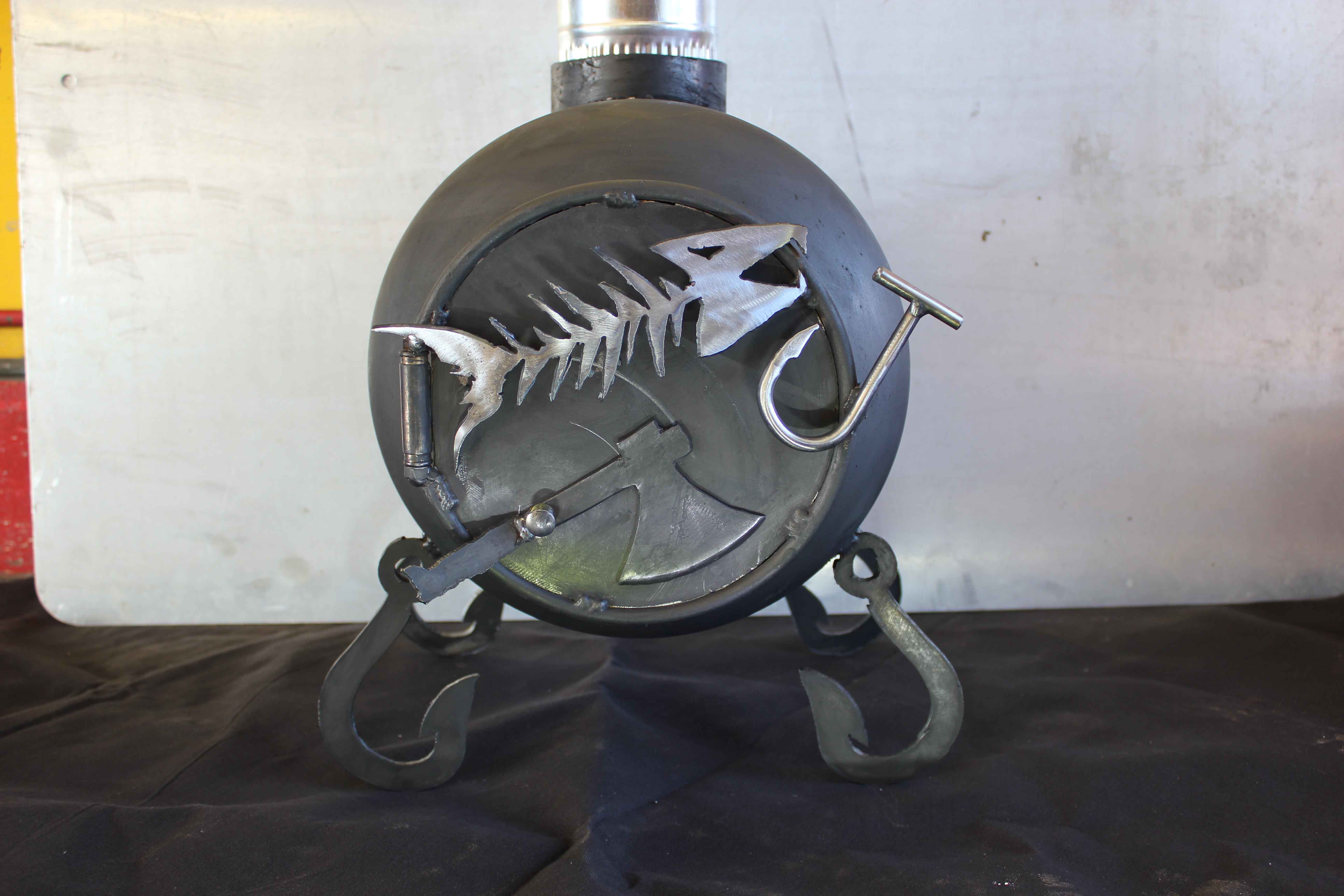

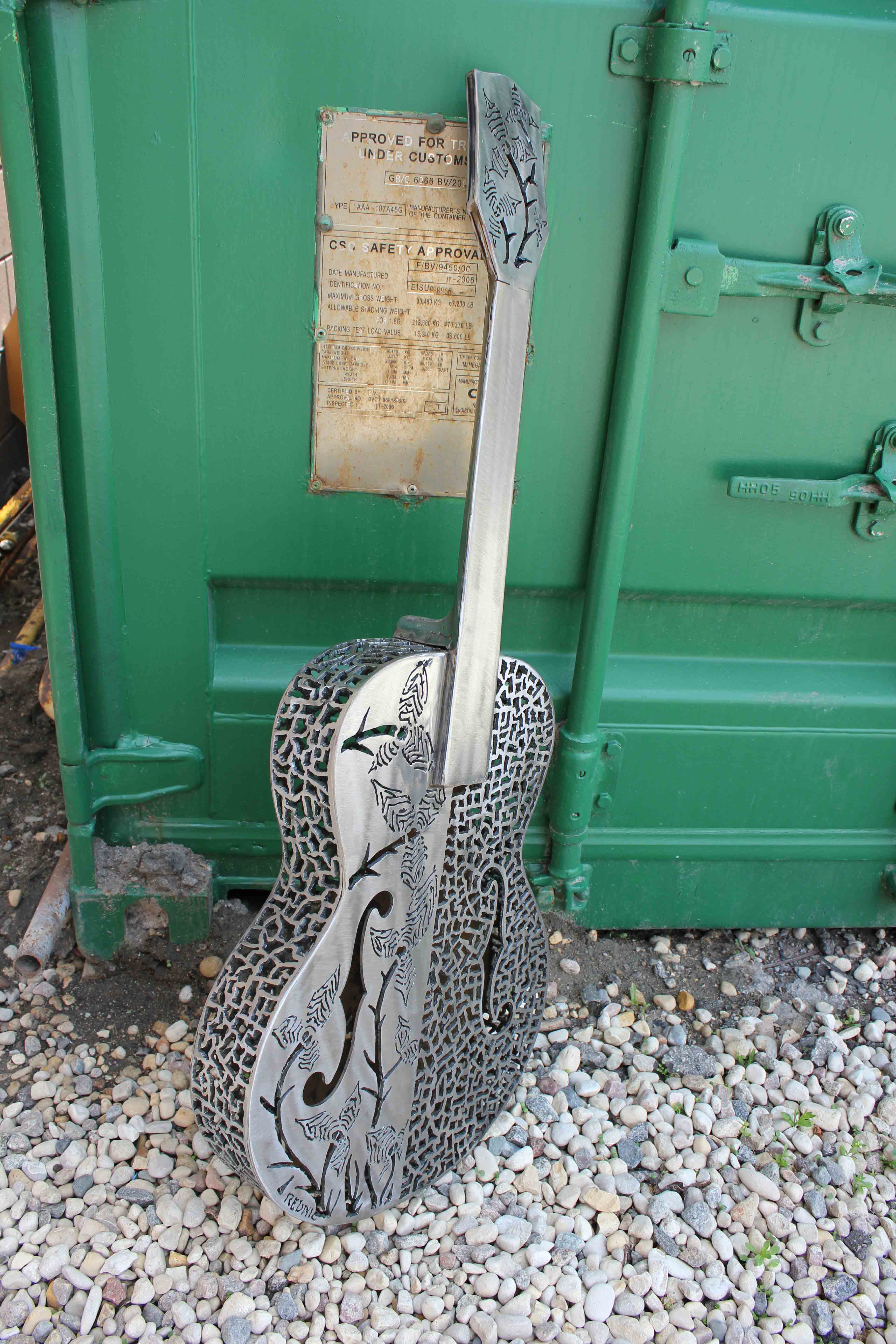

well, off hand a have these. i make quite a few ice shack wood stoves from 20lb propane tanks, and the guitar is an art piece i made for my uncle as well, its made from 1/8 plate all welded and cut using wood templates
