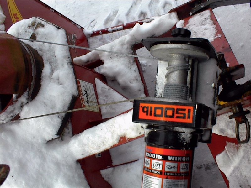

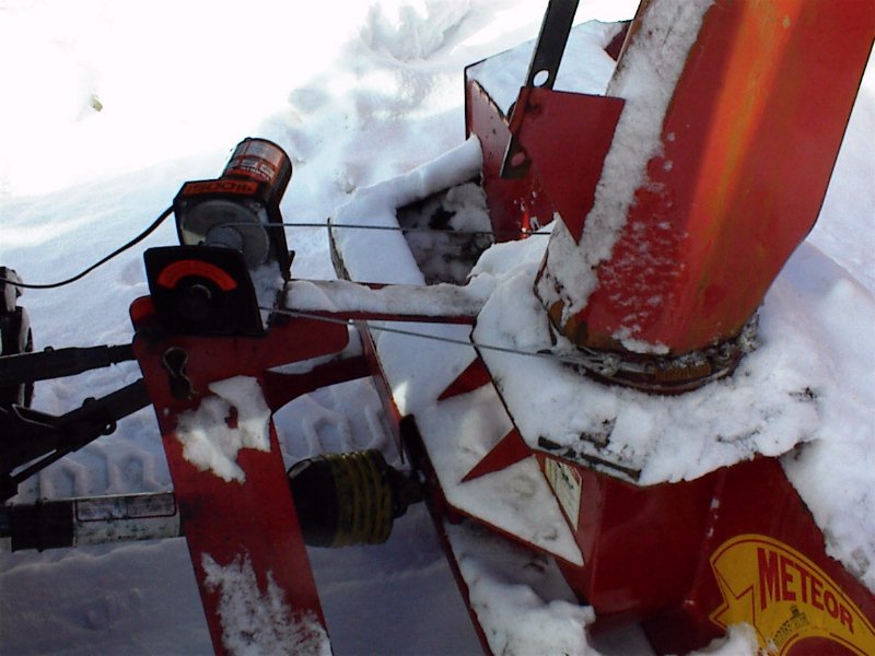

/ Rad/Bervac Factory Hyd Chute Rotator #2
Other owners have gone with an electrical chute rotator - In fact I am going to do the same thing..
I picked up a new 1500lb 12V electric winch that I will mount on the top of the auger box on my 73" blower. All I have to do is adapt the cable and winch drum, to rotate the chute. Also, there is the remote switch that can be mounted up near the instrument consul - allowing remote electrical operation to turn the chute in the desired direction.
The cost of the winch on sale was $48.99 - which is a steal. Works out cheaper than hydraulic and replacements if needed, readily available.Add maybe $25.00 for wire, connectors etc., for a total of $75.00 installed.
I only found out about this by scanning previous post and stumbled across the set up. Thanks to orevious poster, I should have my chute rotating easily for just $75 all found (my labour being free).
Cheers
Jim
/ Rad/Bervac Factory Hyd Chute Rotator #3
Here are a couple of photographs of another owners set up.

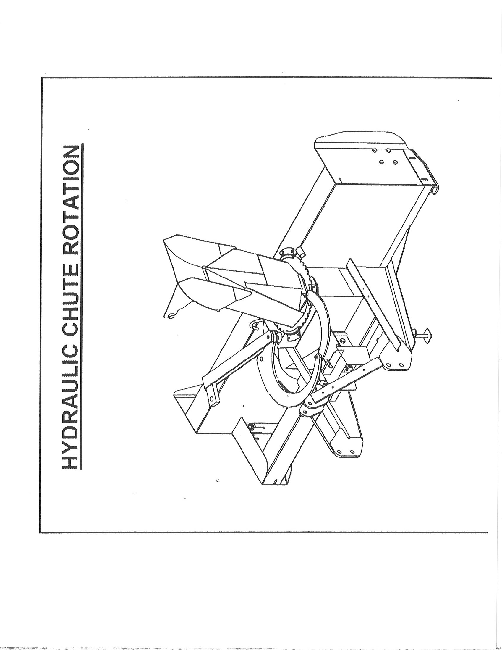

/ Rad/Bervac Factory Hyd Chute Rotator #10
No its a little different. I've included a picture of the dwg from the owners manual.
And I thought mine was a wacky setup.
One advantage of the one in your drawing is that it could double as a torture device.
#11
Mmmm I don't know... it's no more wacky than the linkage on the back of a backhoe bucket. From a manufacturers standpoint, hydraulic cylinders are cheap and fast. Linkages are simple, rugged, and virtually idiot proof.
