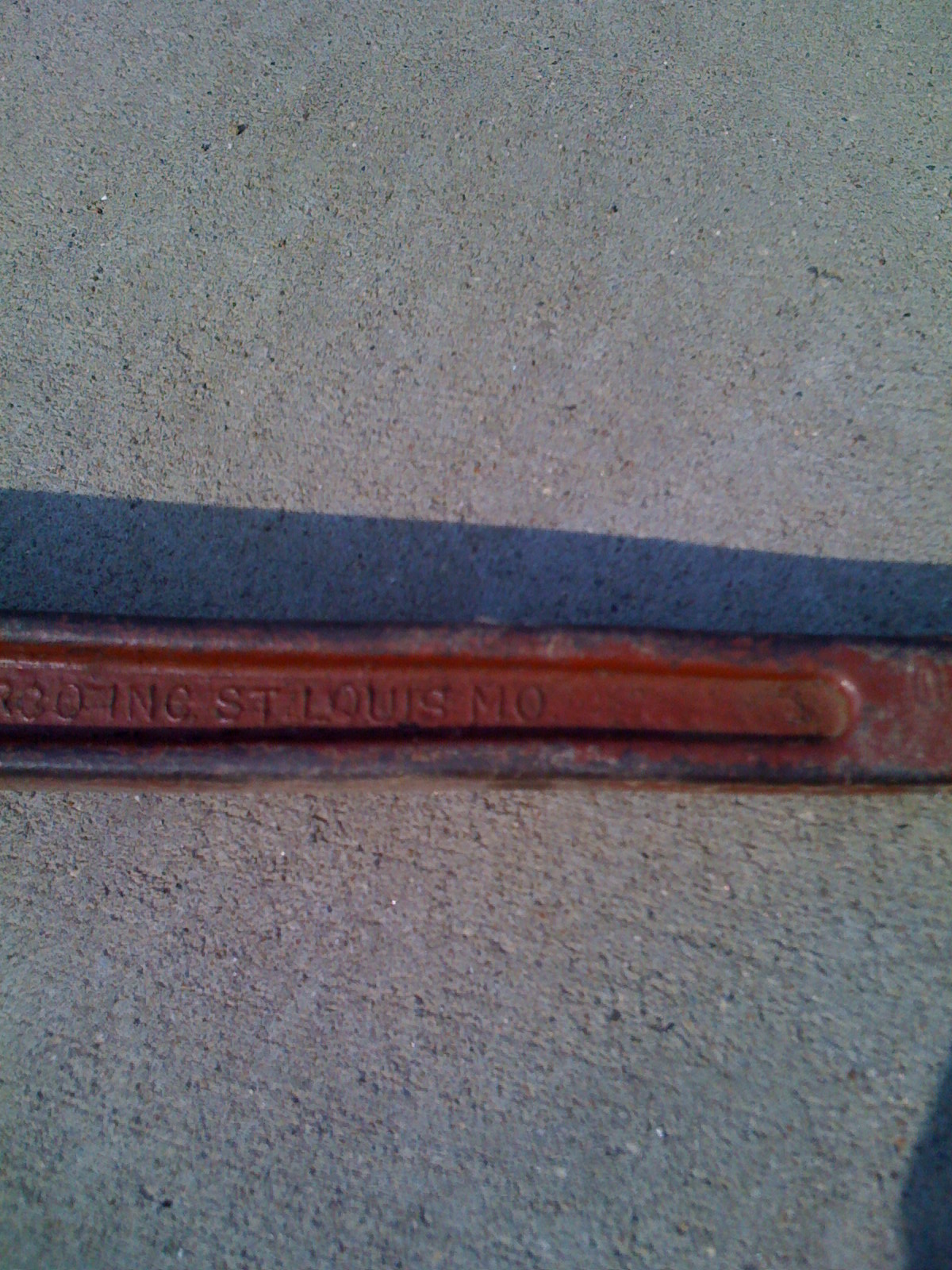

I'd like to know where you can find U.S.A. made binders?
I bought mine used but they have "U.S. Steel Duluth" forged into the handle. I am told that they were made around the St. Louis area.
*edit*
I walked out to the barn and just happen to notice the binders hanging on the wall and took a picture of the handle of one of them with my phone. Now I see my photography isn't great with my phone, but you can clearly see the St. Louis, MO part.
