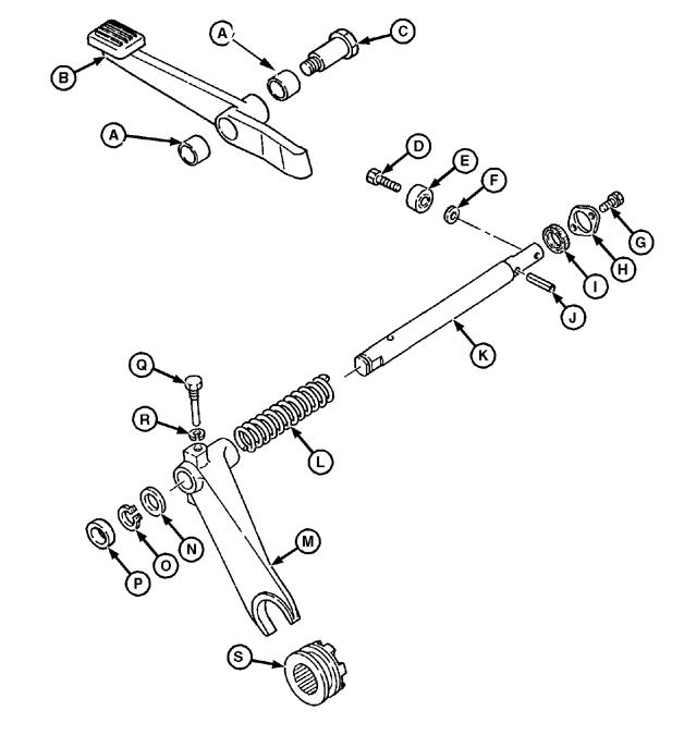

hello all,
i have been having a problem with my tractor that i can't quite nail down.
the traction lock lever is difficult to engage and consequently it seems difficult to disengage. now this never presents a problem unless i am mowing the pastures and choose to pivot on a rear wheel to make a sharp turn by splitting the brakes and spinning around on the braked wheel. when doing so it will make a gear on gear grinding noise. not good.
the dealer has looked at this but to no avail - but - it wasn't making the noise until recently.
anyone else experience this before? anyone else have trouble engaging the traction lock?

/ R4344 - split brakes and traction lock #13
simonsben said:
i am starting to disagree now that it is displaying a noise that is not melodious but more metalic/gear grind with the lock in the fully up position.
I am not an expert here, especially in Montanas, but I am inclined to agree with you. It sounds like the grinding might be the teeth on the differential lock collar almost but not quite engaging.
A diff lock is a fairly simple device. It is just a pedal (B) that moves a fork (M) to slide a splined collar (S) across the differential carrier to lock the two axle shafts together. Here is a diagram of mine.
I'm still going with the mis-adjusted or unlubricated linkage. It sounds to me like your lever is just sticky. Can you disconnect the linkage right before it goes into the differentail housing and at least make sure all of the external stuff moves freely?
Unless you're a rather stout fella literally jumping up and down on the pedal, I doubt you've done any damage.
i have (along with the dealer a couple of times) taken all the linkage out, cleaned and lubricated the linkage, and checked the action of the lock (sans linkage).
they say it works as expected once everything is lubricated but i could not get it to easily engage literally saturated with PTFE. i have since cleaned any excess lube as to not attract debris.
i will be taking it to the dealer in august and i'll watch them try it out this time instead of leaving it for them to evaluate. this way i can be schooled on the proper action of engaging it... or i can school them on how difficult it is to engage.
i am not stout by any stretch of the imagination - i'm 5'7" and 130# with Muppet arms and a red neck - what i lack in size i make up for with patience and determination :eek:)
Ben
#17
Sounds like the best plan. Please share your results here. We're invested now. ;)
ok - got the tractor back last week.
verdict from the dealer: the brakes.
apparently when i step on the inside brake to "throw the anchor" in a turn i am hearing the outside brake trying to (their word) "synchronize".
the dealer adjusted the brake and the pedal is quite a bit higher. when i tried the technique on their lot it seemed better and the noise was imperceptible. the service rep said this is a normal sound.
i was mowing this weekend - range selector was set on 3rd gear and the transmission was in 2nd gear and throttle was set to pto 540 RPM with pto engaged. i turned left, hit the left brake and the noise was still there - gear on gear scraping sound. it is virtually unchanged.
the traction lock was clearly not engaged and appears to be working normally (though it is still difficult to engage).
i feel like i want a second opinion on this but am unsure where to take it - would a heavy equipment service center be a good choice? should i take it back to the dealer? i am in the North Central Florida area.
