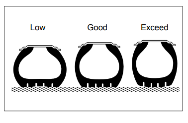

I've looked through the owner's manual for my MT357HC to find nominal tire pressures for the R4's I have on this tractor. Nothing listed for the size of R4's installed. About the only recommendation I found in the manual was a drawing showing the tread to be flat with the ground and not cupped in either direction.
The max tire pressure listed on the tires is 40psi. I'm not using the loader right now so I'm going to play around with tire pressures to see if there is any improvement in traction or ride. Any recommendations? Front is a 12-16.5 with a 17.5-24 rear.

I've looked through the owner's manual for my MT357HC to find nominal tire pressures for the R4's I have on this tractor. Nothing listed for the size of R4's installed. About the only recommendation I found in the manual was a drawing showing the tread to be flat with the ground and not cupped in either direction.View attachment 753752
For a softer ride I adjust tire pressure to the point where the tires bulge slightly with the maximum load they encounter. R4s have a stiff sidewall (mine do) and have rated pressures 3-4x the total weight of the machine. One of my pet peeves with tractor designers.

I look at the tread where it meets the ground. If it looks cupped, like the tire is only touching in the middle, its too much (not exceeding the sidewall pressure if listed, mine is not). If the sidewall on the ground looks squished, and the tread is in full contact, its not enough air. A good contact patch all around does nicely. It's easier to see if you park on concrete or asphalt.
