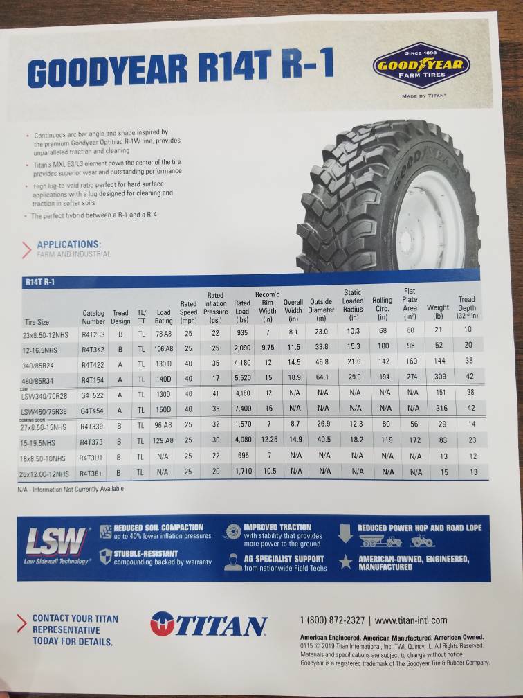

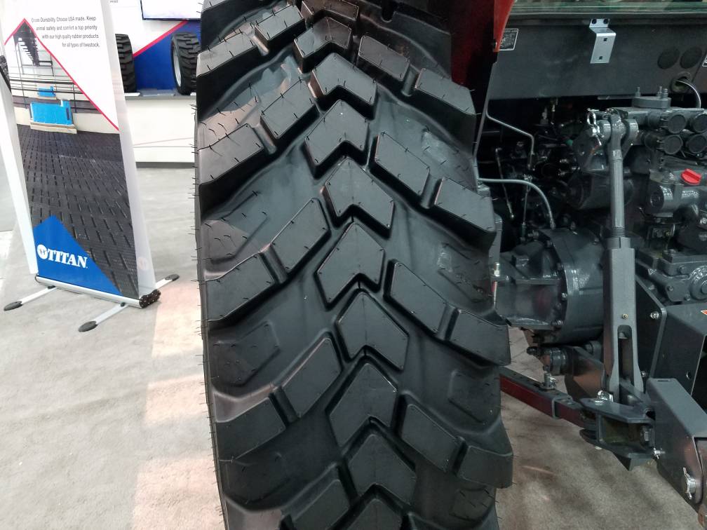

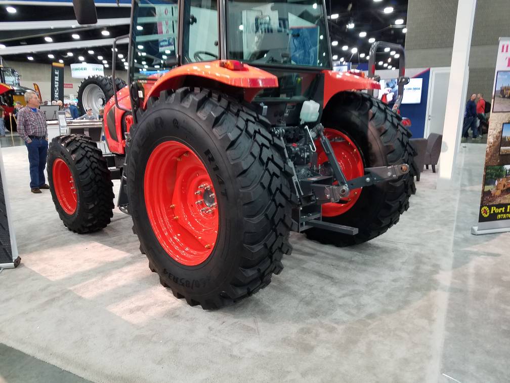

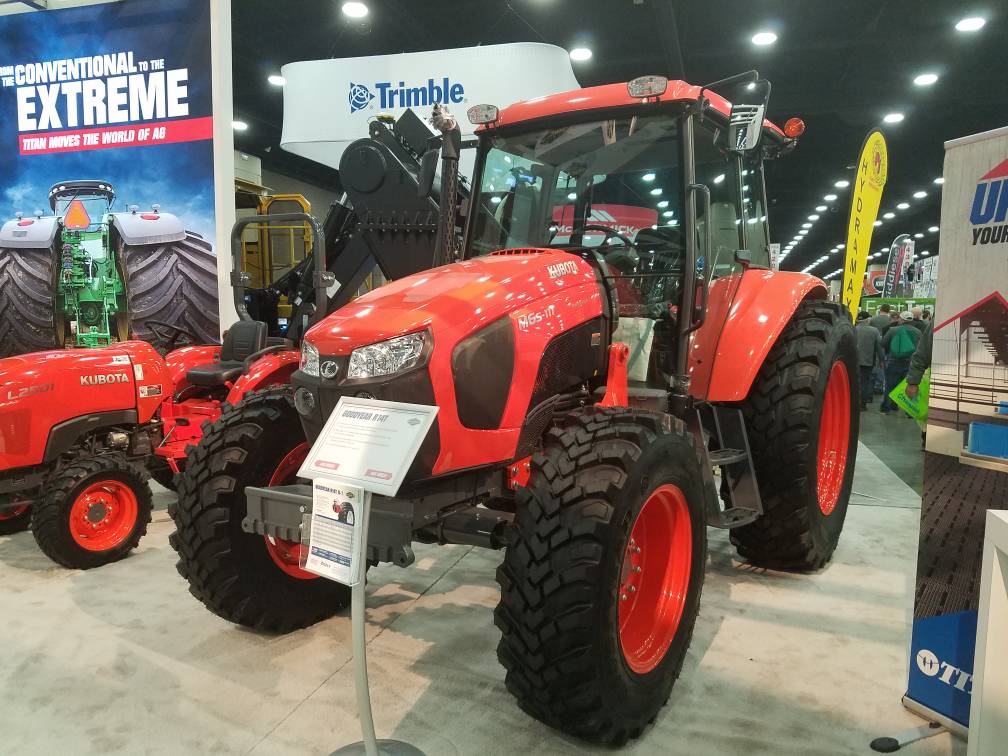

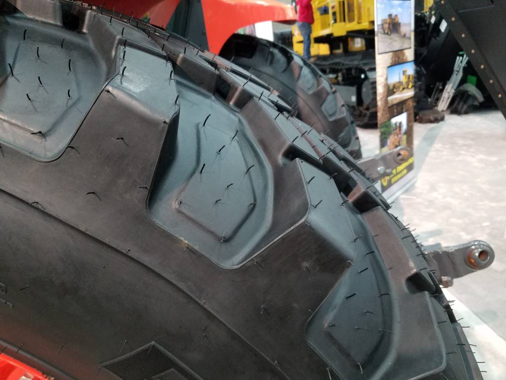

Was told that in testing the R14T only had about 5-10% more slippage in field applications than R1 lug. Similar to R4 performance. Roading much better than R1 lug. Technically R14T is an R1 with a unique tread pattern that they are calling R14T.View attachment 591872View attachment 591873View attachment 591874View attachment 591875View attachment 591876
That 5-10% number can mean the difference of accomplishing a job or not. I don't see them nearly as effective for high traction work R1's are designed for. The reason is two fold. 1. The centre of the tire is filled with a tread pattern. This will prevent the tire from sinking in and grabbing hold as the bars attempt to dig in to gain traction. 2. An R1 tire's lugs are higher from periphery to tire center allowing for increased grab.
Basically, I feel this tire is a compromise attempting to capitalize on all parameters especially travel smoothness. May be the Weimaraner of tires.
