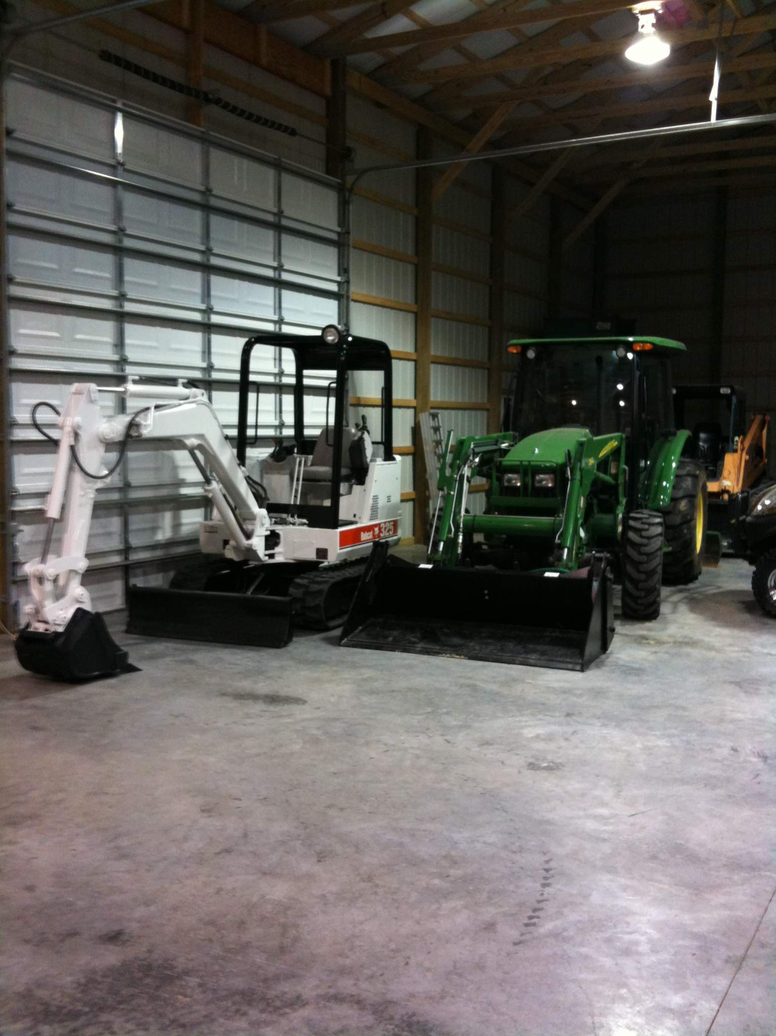

Correct. I have both R1 and R4 tires for my JD5525 tractor. I even think I asked on here a couple of years ago about where to find rims since they were crazy expensive at the dealership. I don't recall if it was here or somewhere else, but someone suggested Hey Equipment to me and I went to their Hey Wheel Hey Wheel Home site and called them. They were some of the nicest, down home people with the best prices anywhere. I bought the correct rim sizes for R4's from them and some factory blems (the DOT notice printed on the side of the tire wasn't entirely legible) from another place. All told, I was several hundred less than just the rims only, from the JD dealer, for a new set of rims and R4 tires.
Running in a wide variety of areas, I have a set of loaded R1 tires and a non-loaded set of R4 wheels and tires for that tractor. I probably have about 200 hours on each set now. My only difficulty is that the loaded R1 tires are a bit to handle. I cheat and use a forklift to put them on a pallet and up on the shelf when I'm not using them.
As a matter of fact, here's a picture of a JD5525 with R4 tires on it that I just took with my phone last night in my barn. I'm sure you've all seen JD 5525 tractors with R1's on them since that's the only way I've ever seen them on a dealer's lot.
