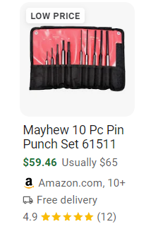

Using a dedicated roll pin punch such as Mayhew makes R&R of roll pins much easier. Roll pin installed inside roll pin was intended to give added strength to original roll pin.
/ R&R Roll Pin on Mower deck. #8
I actually have a set of Starrett roll pin punches and they were a bit north of 65 bucks but the Mayhew punches work fine. My Kuhn rotary rake on the arm bosses uses the double roll pin setup. If you size the larger one, it will drive the smaller one out at the same time. I believe they do that to insure pin retention, not sure however. When I put them back in, I always apply some Never Seize first and grind a short chamfer on the end as they go on easier that way.
