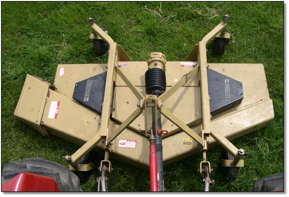

I know exactly what ymarianne is talking about. This spring I bought a new Kubota GL3540 with a Land Pride QH. When I went to hook it up to my Farm King RFM, there was no way that it was going to "mate up". I had the PTO shaft hooked up as well and the QH frame barely cleared it. I was trying to figure out what kind of mods I would have to make to the mower when I decided to go on the Buhler website to see if there was any mention of QH compatability. I looked up the RFMs and on-line operators manual to discover that there was an adaptor kit I could order.
The 1st pic is the mower as original, the second and third pics show with the kit installed (all the black parts). This made all the difference in the world, and works "just like uptown". I really like the QH. ymarianne, I don't think that it would matter which QH brand you have, at least all the ones I have seen are primarily the same, except Pats, and JDs top link is rigid.
When I ordered the kit, I had to get some other parts as well, including a new PTO shaft as the other one was too short for this setup,..... anyways I beleive the kit was $100.00 ish Canadian.

If original poster's mower is anything like Jakes, one can see where there are going to be problems. In the first picture, it is obvious the 3pt lower attachment points are substantially lower than one normally finds on implements, thus placing the pto drive-line higher than normal. Also top link attachment point is much higher than normal 3pt spacing. Looking at pic 2&3 one can see the adapter corrects these abnormalities. Lower attachment points are higher and upper attachment is lower.
The question I have is, why would the mfgr of the mower design it with non-standard 3pt spacing and location with respect to the drive-line?

This was my late Fathers' mower, and the first time I had much to do with it. In the 1st pic., the lower lift pins are bolted onto two brackets on either side of the weldment on the mower. (Actually it should be bolted to the lower hole on that weldment). After you unhook them from the tractor 3 pt., they drop straight down like a pendulum. When operating they would be pretty much horizontal, this is how the deck is able to float. Of course trying to hook them up on a QH would be like hooking up to a piece of rope, and as you can see on the top link, it just was not possible to hook up. But you are right as far as stating that obviously by having the bottom pins higher, it certainly made all the difference with the PTO. Dad used it on his Ford 800 up until last fall (bought new in 1996) without any issues.

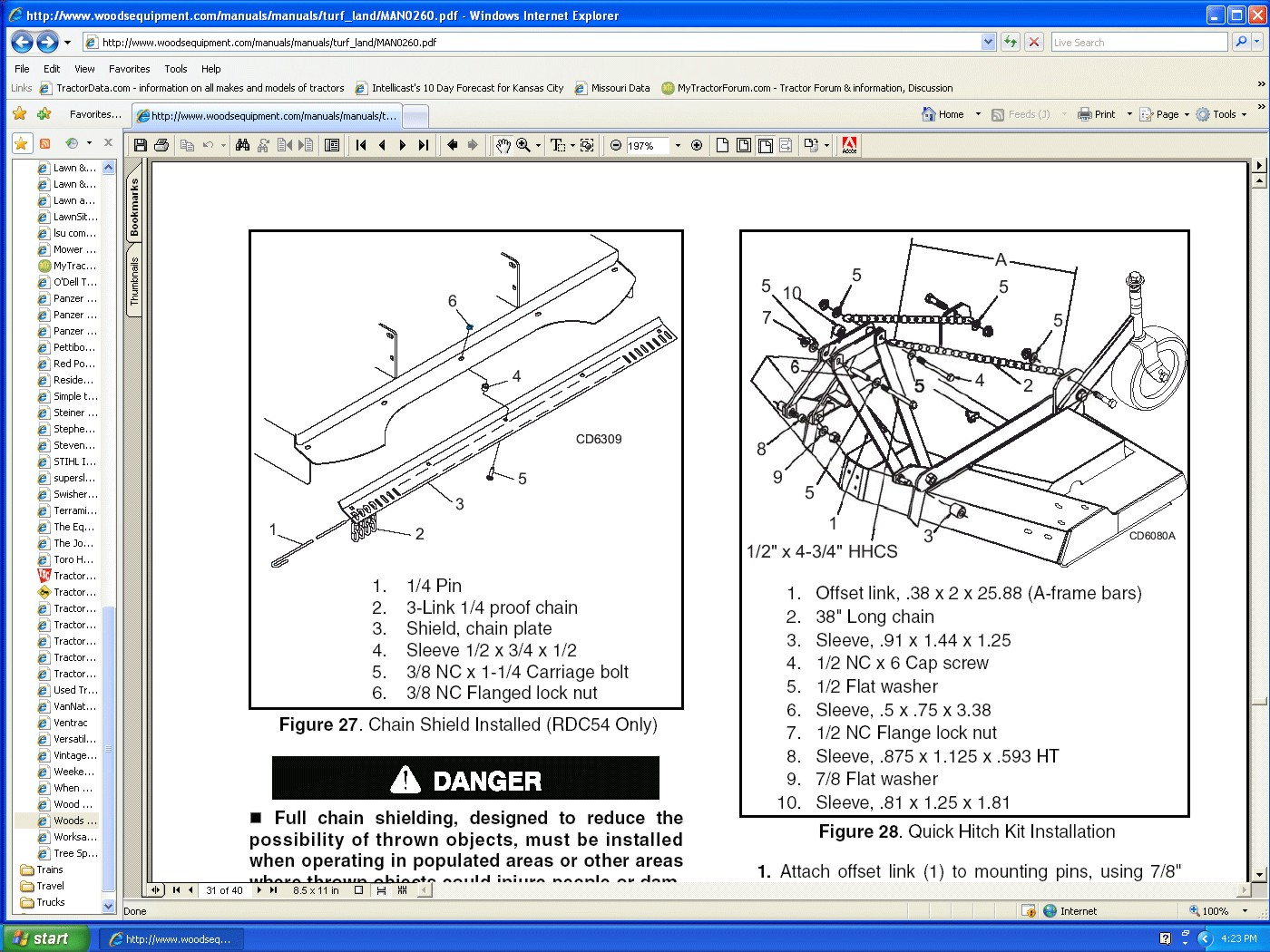

Sorry I'm so late getting in on this one. Here is a picture from a Woods manual of the parts needed for a quick hitch adapter for their mowers.
With the pics of the before & after conversion, it makes sense now.
In order for the mower to 'float', either the top link or the bottom links must be flexable. If the top link is flexable (a chain in it instead of flat iron) then there is a remote possiblitiy the mower can hit something and flip up vertical & cause a lot of liability issues.
So their solution was to put the lower pins on flat iron that can pivot quite a bit. Works well I'm sure and actually makes hooking up to a regular 3pt very easy.
But all that flex in the bottom pins means it doesn't work with a quick hitch. Those bottom moving pins are not a standard 3pt thing, I hadn't seen that design before.
The $100+ solution is to build a new frame for the mower that keeps the flex link in there, with an outer frame that hooks onto the quick hitch. That puts the $$$$ cost onto the user, rather than re-engineering the thing to work with both 3pt & quick hitch.
This mower could be 'fixed' by putting the lower pins into the solid hole - throw away those little short arms. The top link would need to have the strap irons going to the back cut shorter, and place a few links of chain in the place of the shortened iron. This would allow the flex at the top instead of the bottom, but would not allow the mower to flip up very high if it caught something, and probably should be the real fix from the company?

The way you describe is exactly the way that the adaptor kit works. It takes the "flex" or float capabilities out of the out of the bottom links to the top link. The red A frame in pic #3 is connected to the strap irons as you describe going to the rear of the deck. These strap irons are slotted at the rear and slide on a bolt attached to the frame. This gives the "flex" as the red A frame and the black A frame pivot at the top (If the red goes up, the black goes down, etc.)
You are right on the before picture, where the lower links attached to the flat irons acted like two little draw bars to pivot as irregular ground conditions were encountered.
