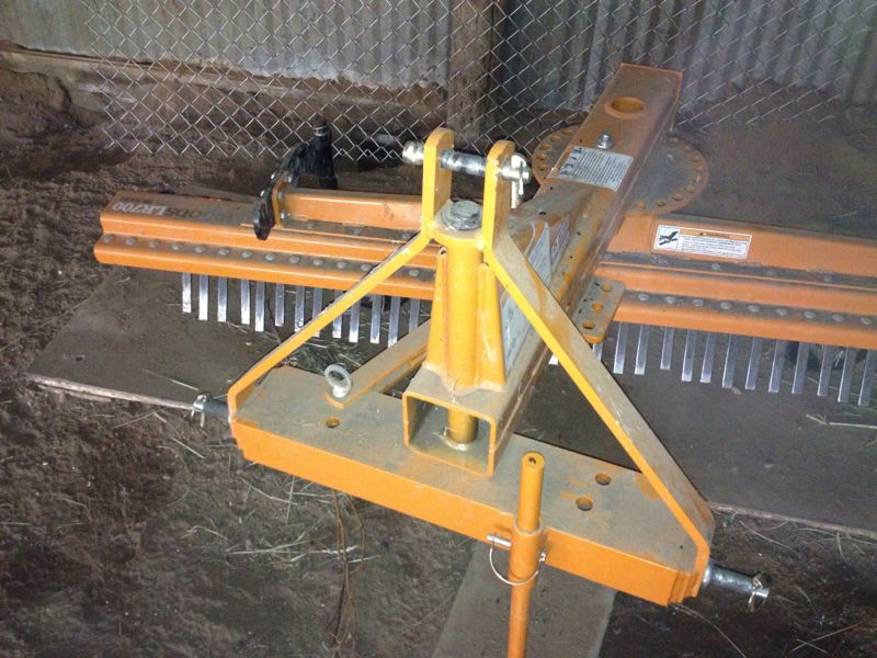

/ Quick hitch other than Harbor Freight? #83
Also, who is the best supplier for top link adapter for non-quick hitch compatible implements?
You don't need the "Y" shaped adapter. I made two flat straps, about 2.5 by 3/8 by 10, with several pin holes in them. They go on the outside of the top hitch of the implement, not the inside.

/ Quick hitch other than Harbor Freight? #85
It is the top, center PIN that needs adaptation -- not the turnbuckle top link. My apologies for the confusion.
/ Quick hitch other than Harbor Freight? #86
OK...you need a bushing that is .625" ID by .75" OD by 2.5" or 2.75" long (measure between the QH brackets for your QH for the exact length. A little short is better)
These bushings aren't normally supplied with QH bushings kit (except by Deere...but Deere's kit is outrageously expensive!!). You can get the required bushing at Tractor Supply, Agri-Supply and, quite likely, your local hardware store.
/ Quick hitch other than Harbor Freight? #87
I think he needs this adapter for implements with no pin access from the bottom. But two flat straps can be used, instead.

/ Quick hitch other than Harbor Freight? #88
Bruce,
Is that picture correct? Looks like that adapter would possibly work, but appears to be backwards. shouldn't it be attached to the implement, with the pin ready to connect to the QH top J-Hook?
/ Quick hitch other than Harbor Freight? #89
Bruce
Could be, Bruce...maybe he'll respond.

Read my post from yesterday at 8:03. I am pretty sure that will work for the rake.
Sent from my Samsung SPH-L710 using TractorByNet
/ Quick hitch other than Harbor Freight? #92
Adapter used on a non-compatible implement:
Bruce
/ Quick hitch other than Harbor Freight? #93
Agreed. Adding the "forked" adapter might permit me to hook-up without getting off the tractor, but the adapter will introduce floating behavior which might not be helpful when using ground engaging equipment. Might be easiest to do as you suggest!
(BTW - hello to anyone searching the Internet hoping to hook-up and get-off)
/ Quick hitch other than Harbor Freight? #94
It won't float. Bottom hooks stabilize up-down motion, the top link stabilizes front-back motion.
Bruce
/ Quick hitch other than Harbor Freight? #95
Bruce - do you leave your set-up that way and use for all implements -- even if the QH J-hook fits?
Thanks
/ Quick hitch other than Harbor Freight? #96
Not my photo (found on the internet to illustrate), but I left my homemade link on the rake after each use, when I was doing ground work. Otherwise it stayed on the carryall. The others fit the top hook.
Bruce
