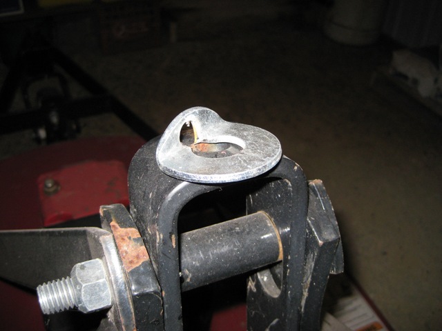

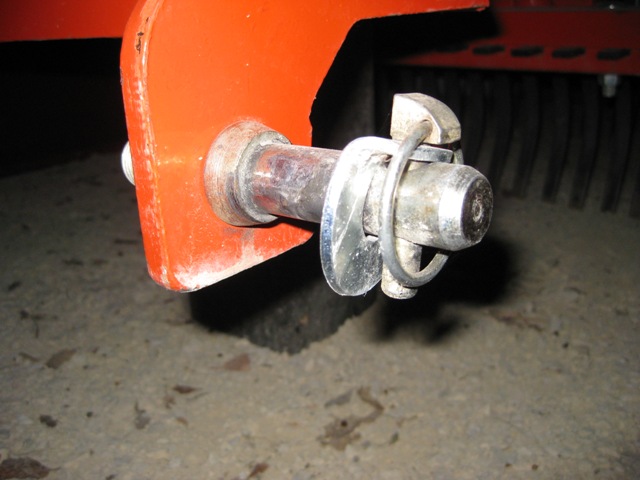

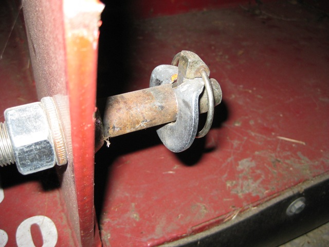

There are special washers that need to be pined on to the lift pins for Pat's system. They are included with the purchase. But more can easily be made. If I think off it, I will run out and get a picture of them. They are nothing more than a bent washer with an additional hole drilled in them.
One other thing I forgot is that you need something to hold the lower lift arms apart when backing up to your attachemnt. Pat sells a telescoping rod assembly, but I know others have just made their own.
Addendum: Here are the pictures I promised.
BTW, I have no affiliation with Pat. Just a satisfied customer.
