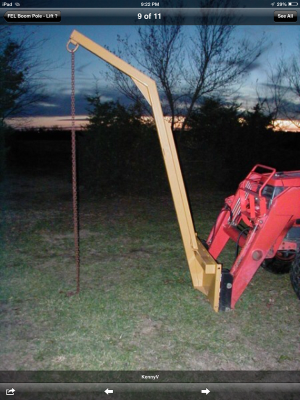

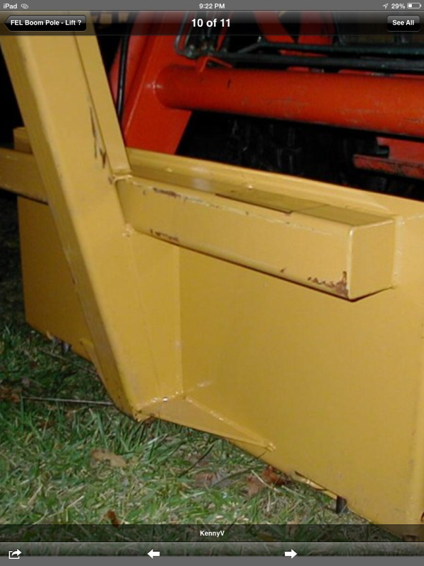

Here is an idea for bracing the pole to the SSQA plate:

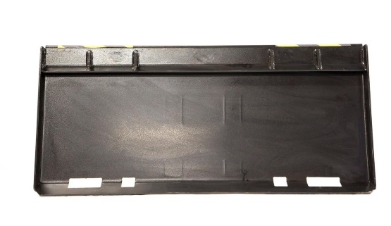

And a major heavy duty SSQA plate: Eterra Hitch Attachment for Skid Steer Loader | Skid Steer Solutions

Thanks! The re-inforcement is a great idea... I will have my welder do that to the plate.

Thanks for the pictures!

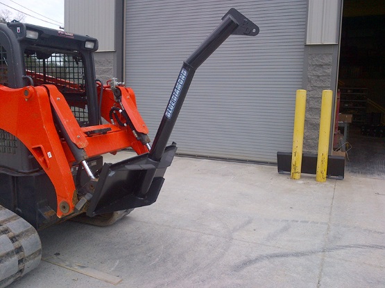

Super nice boom crane there! How much does that boom crane weigh by itself?
Basically, I'm taking a lightweight man-basket (about 250 lbs) and wanting to put it on the end of a 15' 4x4 boom (about 260 lbs)... attached to the quick attach plate much like the boom in your picture. I'm considering about a 15' boom length which would give me about a 23' deck height when the FEL is lifted to maximum in the vertical position.
It would primarily be used in the vertical position but it would be great if it could be used in the angled position as well. (Not sure if this is too much stress on the connection to use it in an angled position).
Thanks again.
