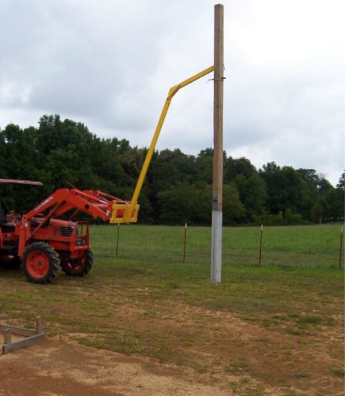

/ Quick Attach Forces Questions #14

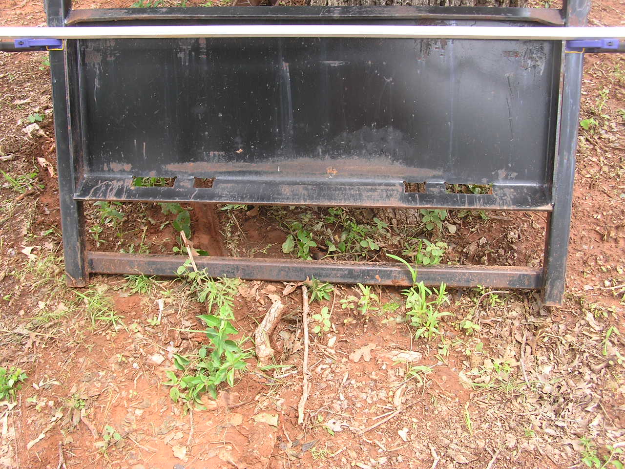

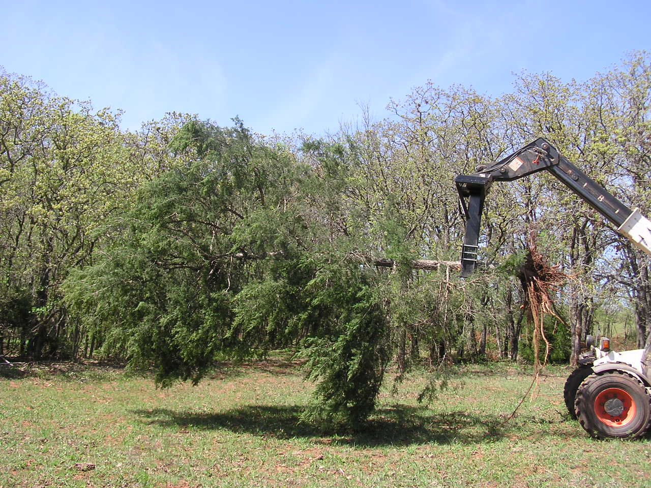

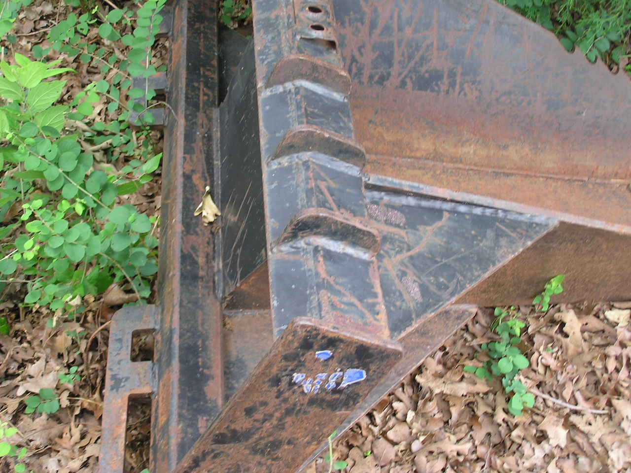

Looking at Bryan's pic and/or mine below you can see that we don't put stress on the lower pins. By keeping the FEL QA plate in a vertical situation the load is always carried by the top angle brackets. Bryan's is an excellent example of a properly built boom pole designed to apply the stress properly on the Quick Attach.
To see how inefficient the SSQA is with the mounting plate in a horizontal position raise your Bucket until you can easily see it from the tractor seat. Then dump the bucket as far as it will go. Then jiggle the curl function and watch the bucket. You'll see it "slopping" in the brackets. It's not designed to carry load in that position. I've read horror stories here on TBN of operators putting stress on their attachments in that position and having them come unhooked. I'm very conscious of this when using my Grapple.

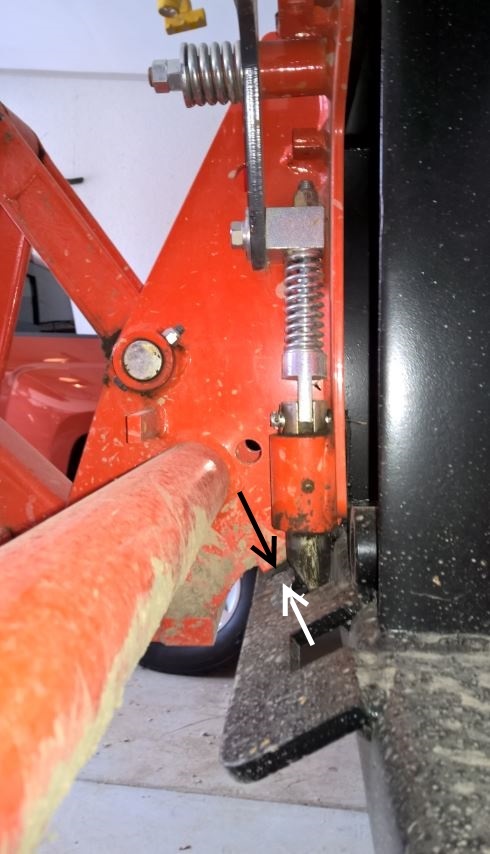

I have Quick Attach on my tractor. On any of the implements... the Quick Attach plate basically consists of the overhang on top and some holes on the bottom and the mateplate at the back. The FEL plates tuck under the overhang and the Quick Attach pins go down in the holes which pushes the FEL plates against the mateplate.
The overhang steel seems substantial (steel all across the top keeping the FEL plate edge from popping out). But the pin tips going down in the holes only go down a little bit... (I haven't measured but it looks like 1/2 to 3/4 of an inch).
(Seems to me that a for a better connection, the pins should go deeper into the holes? (Why don't they go deeper?)) Because they are spring loaded to go as deep as possible, compensating for manufacturing tolerances and wear in the slots.

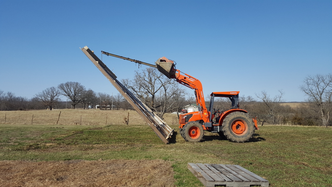

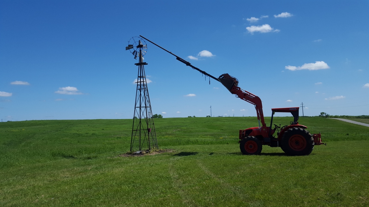

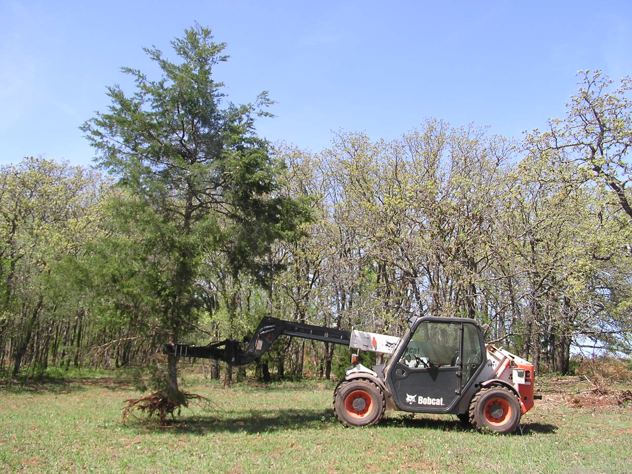

Here is a visual of your theoretical question with a 24' cedar:
The SSQA plate is still tight. :thumbsup:

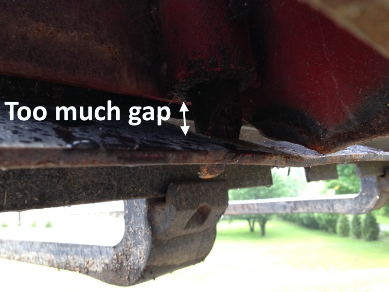

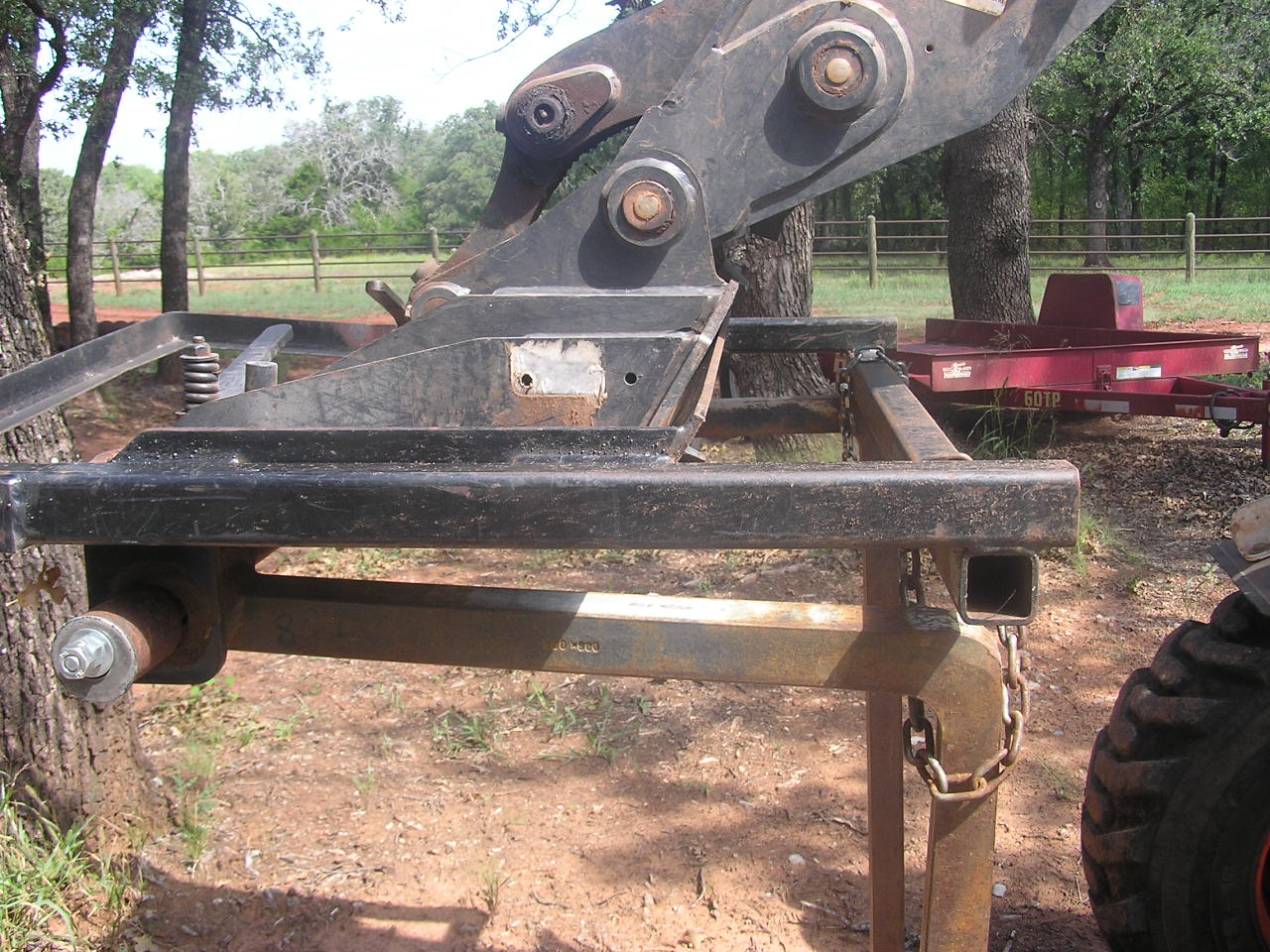

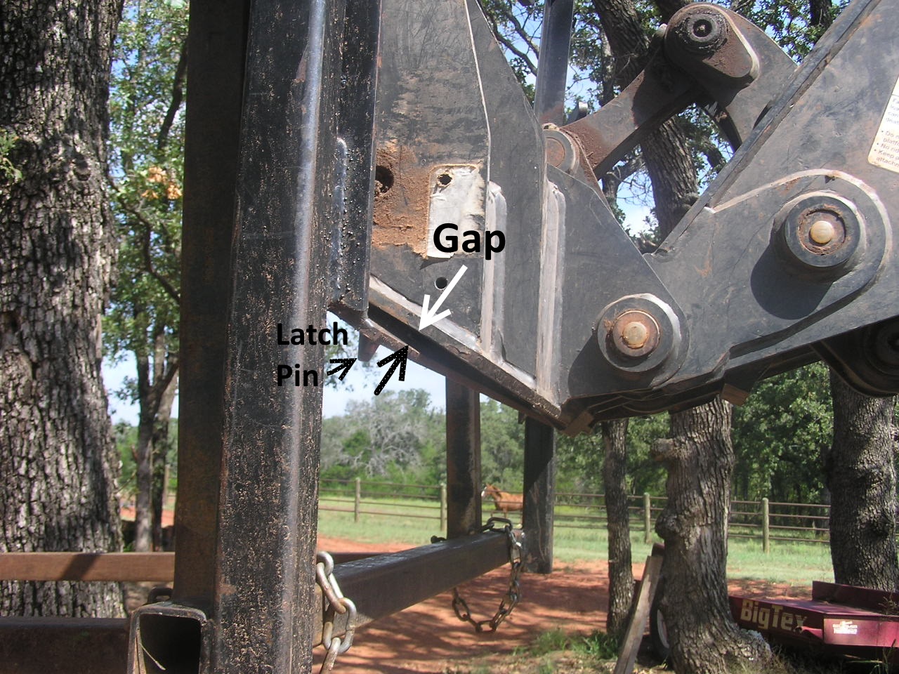

This is a light weight pallet fork frame that came off of the SSQA, when I tried to lift too much weight:
If there is too much gap at the bottom, the plate can slide up when back dragging and come off of the top of the SSQA, usually on one side, twisting the cross tube.

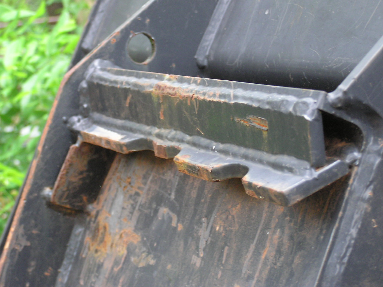

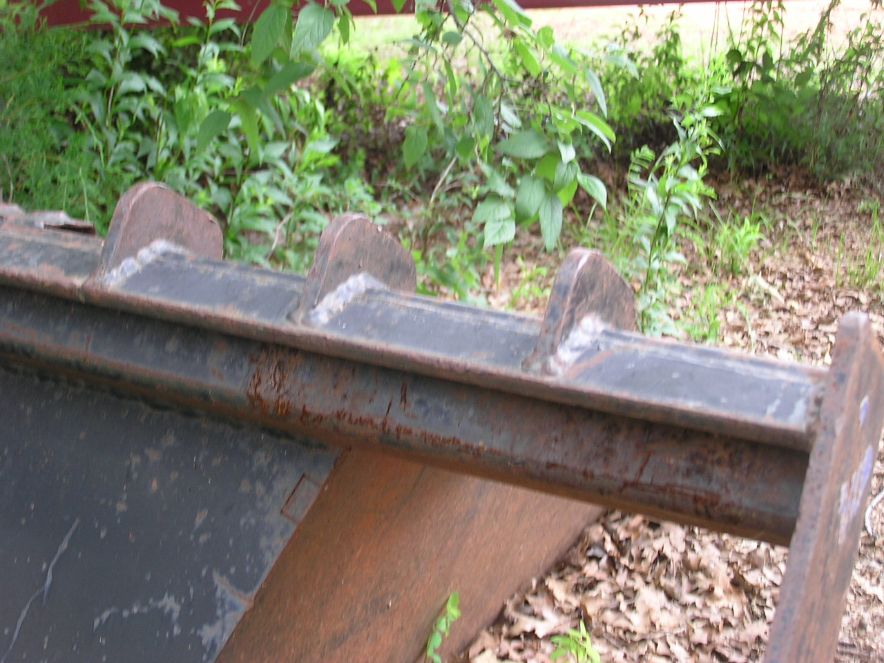

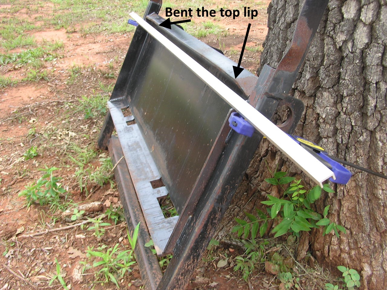

Back dragging or picking up the weight of the machine with the bucket/forks front edge put's the most "work" on those lower pins. I have bent the top edge like in xfaxman's pic on some, I'll repair by cutting out the (unnecessary) middle, straighten out the sides and weld in a new support about 12" in from the side's just enough to clear the machine side contact points. This cut's the span between support way down.

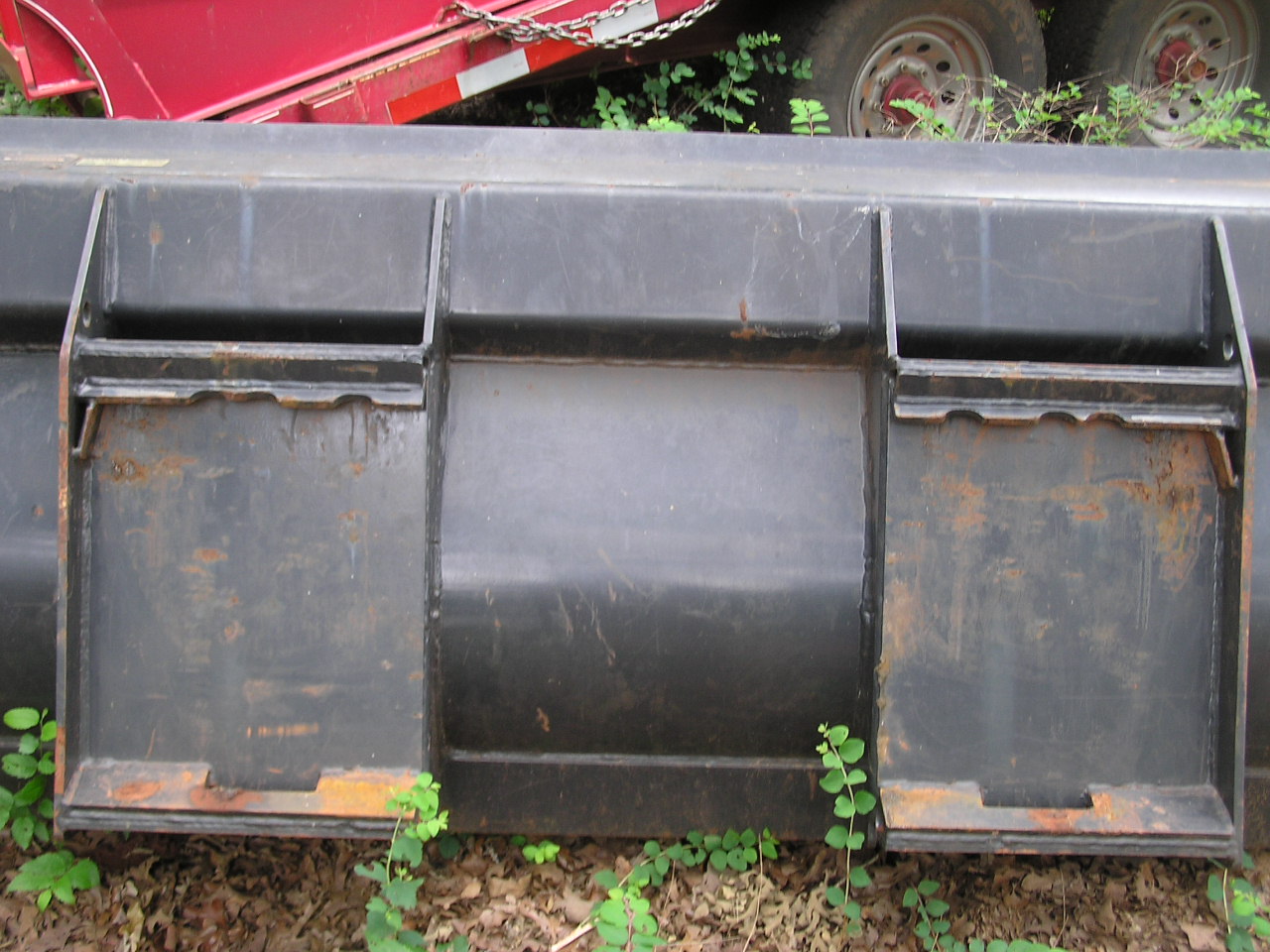

I recommend gussets or extra bracing so that the top lip can't bend when you are rotating the pole up to vertical.
Here are the gussets used on my stump bucket:
And the bracing on the bucket:

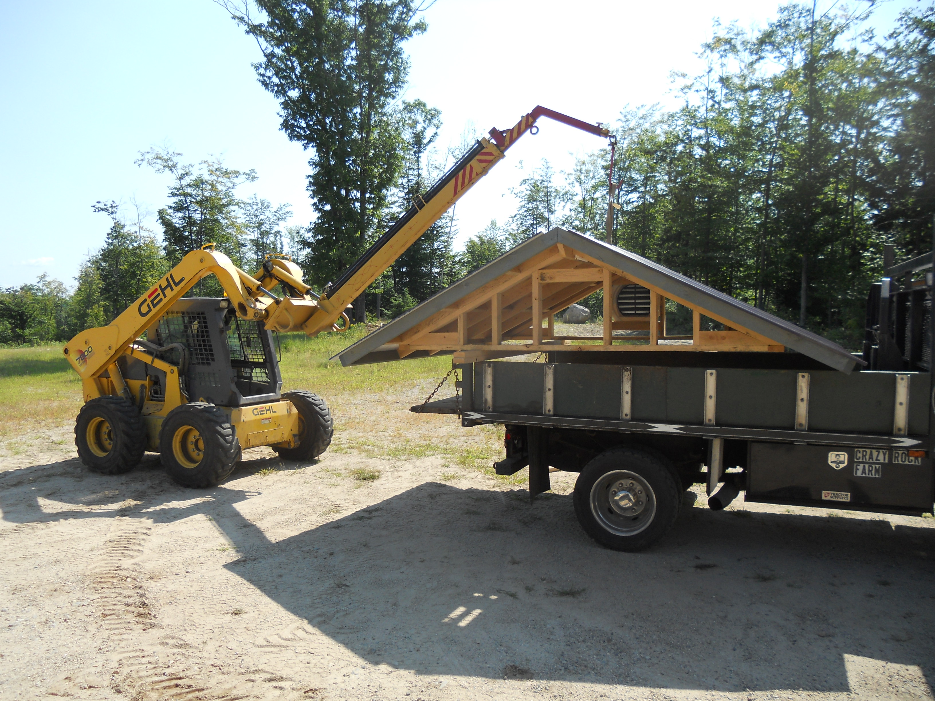

Did I miss exactly what you want to make & do in this "structural" discussion?
I knew a guy that built pole buildings that welded a 4x4 (20') to a ssqa plate and he used it to set trusses. Being able to drive into a building (on dirt, no foundation) you don't need the "reach" of a crain. Once the truss & pole were close to vertical the 200# truss was virtually no load to the skid steer or pole and he was basically right under it.
I took his idea and embellished it a little.
