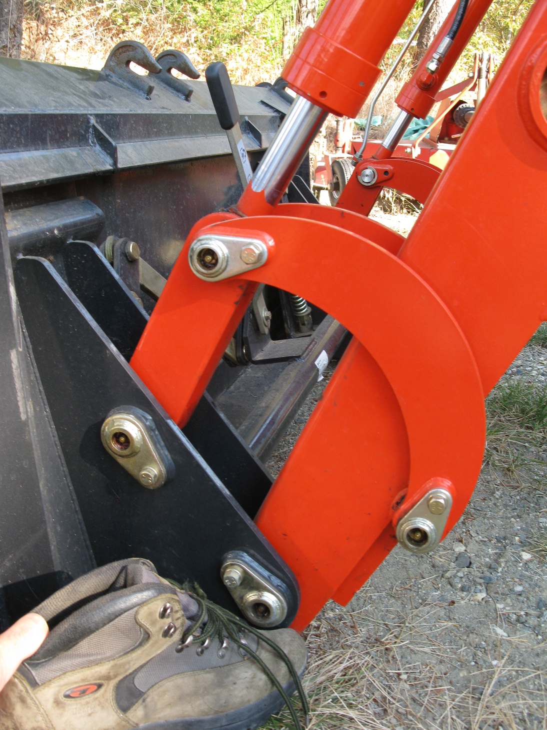

I had a lucky escape while detaching my Quick Attach bucket today. My first instinct was to keep quiet and hide the carelessness/stupidity. Reason prevailed, and I'm posting a photo (of the recreated incident) so others won't make the same mistake.
As usual, I placed the bucket on level ground and floated the hydraulics to relieve pressure. Then I stood to the side of the bucket and raised the lever to release the two QA bottom pins. The bottom of the QA rotated backwards causing the bucket arms to drop another 2" and on the toe of my right boot. Luckily it was just on the edge of my big toe and I was able to release myself by removing the boot and sock. If my foot had been in another couple of inches it would have crushed the top bones and I would have been trapped.
I finished my work(mowing the lawn) and decided to recreate the incident for a photo(with another boot) which I could post here. The photo is taken in the exact position where I removed the bucket.
It was careless and I was lucky. It is a big reminder. It will never happen again, and from now on I'll stand with both feet in the bucket while releasing the pins. Now I'll have to watch where I put my hands.

I had the same thing happen to me a few years ago. I was having trouble getting the qa to release and was doing everything I could to make it let go..
.it did ...with down pressure on the hydraulics. I thought it broke my foot for a minute - sure did hurt - and I had to dig under my boot before I could get out from under.
Bruised but not broken, and a memory that will last and remind every time. I figure we were lucky. Incidents we walk away from make us safer.

I leave the bucket up a couple inches and stand in the bucket to open the levers. This keeps the bucket secure and you can remove it from the tractor seat.

This is exactly what I do. I do not put either the bucket or the forks on the ground, but stand in the bucket and on the forks, that also helps make the lever very easy to move as you are "unloading" the pins slightly by your weight. You just need a couple of inches off the ground, then get on the tractor and drop the bucket. and go for your next implement, and do the same thing hook it up and leave it 2 inches off of the ground and again your weight makes it easy to work the lever.

Glad you didnt get hurt. I had a similar thing happen without getting my boot trapped. I started lifting the release levers after rolling the bucket all the way back and a little off of the ground.

This is what I have always done standing to the side of the loader arms.

There can never be enough emphasis placed on keeping all parts of your body out of "pinch points". Sometimes a person gets lucky and just experiences a little (or a whole lot!) of pain...but sometimes you get a lasting injury or "The Big Sleep"!
It never hurts when starting any task to ask yourself just what can go wrong. If you do that enough, after awhile it becomes second nature and you will do it automatically.

Safety toe boots are a good idea too, which I learned the hard way after working with trees/logs a lot. I'd never be without them when working around equipment if I can help it. They won't help for all situations, but are a good margin of safety for a lot of cases.

Thanks for the replies. I will follow the advice some posters gave about keeping the bucket a couple of inches off the ground while standing in it to release the pins.
