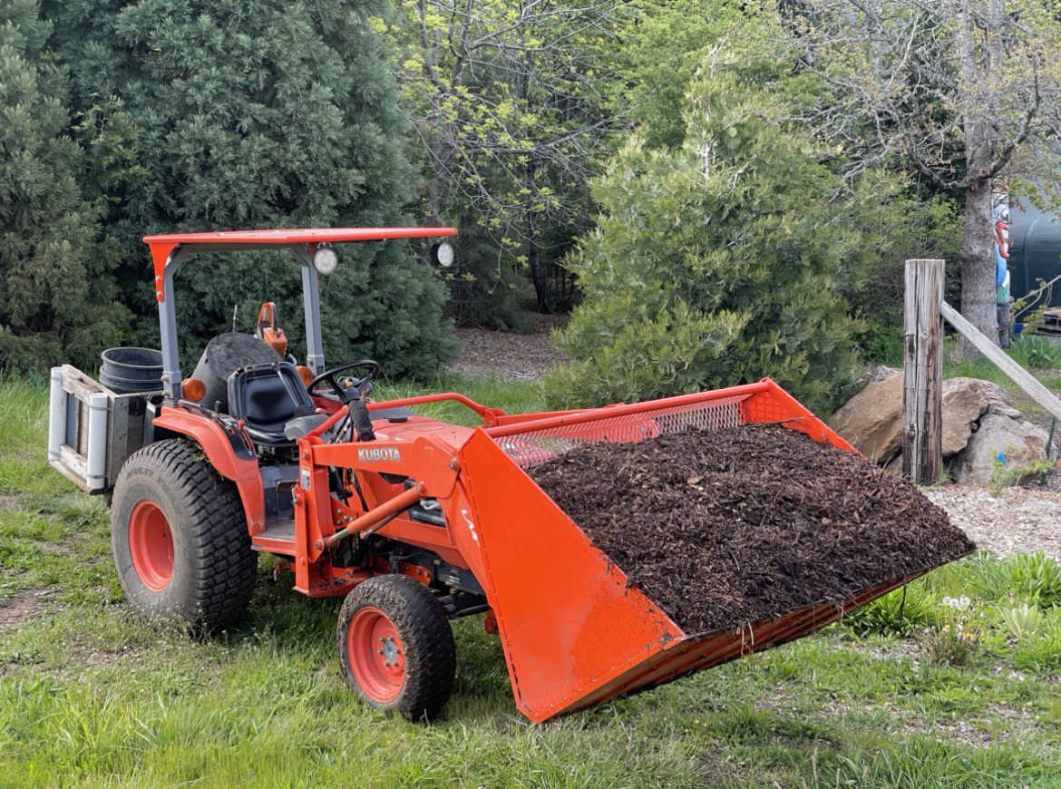

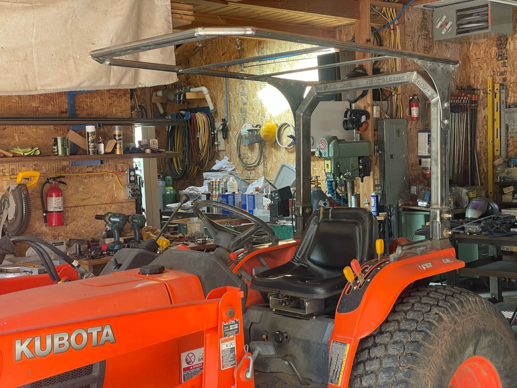

It’s been getting some use. Chips are a little wet still, but the b7800 still handles it pretty well. It’s a bit wider and has a shorter floor than my last attempt - similar volume, but helps a little with breakout force. Take a a gentle hand and a bit of technique to get a full scoop:

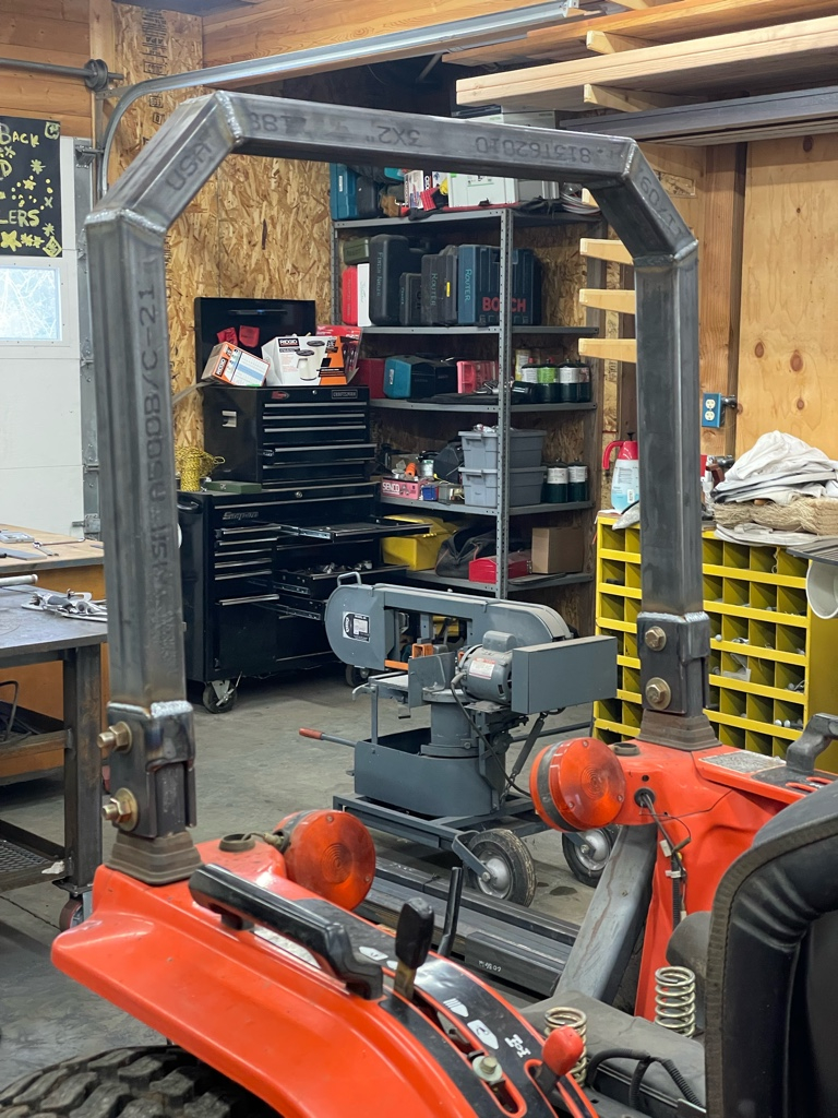

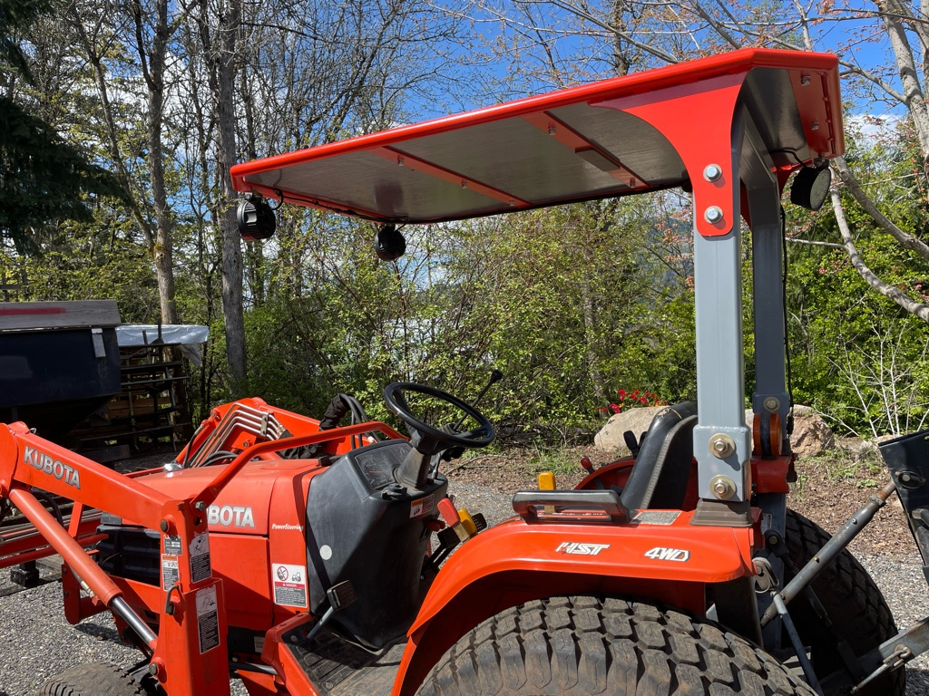

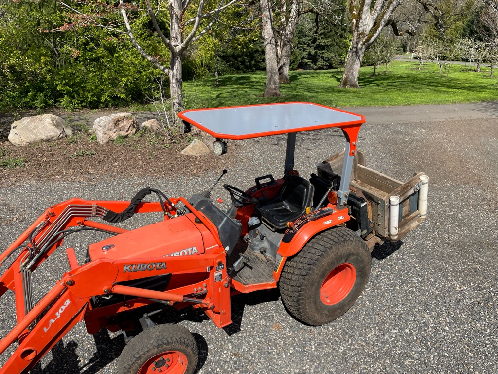

Also got a new roll bar and canopy thrown together:
   / Quick attach bucket conversion for b7800 #23
Buckets working out nice!
That rollbar/canopy looks fantastic too. Really nice fab work on your tractor.
Im trying to build a small rock bucket for my b6100&8200 right now. I'll be pleased if it doesn't break but i doubt anyone will compliment me on my fab work. :ROFLMAO:
   / Quick attach bucket conversion for b7800 #24

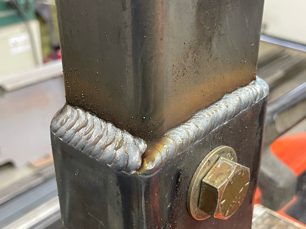

I wish you were my neighbor, we could have welding parties. That is outstanding work and some beautiful welds. Your fabrication skills are something to be proud of. You're my new welding/fabricating hero. Nice, nice work.
