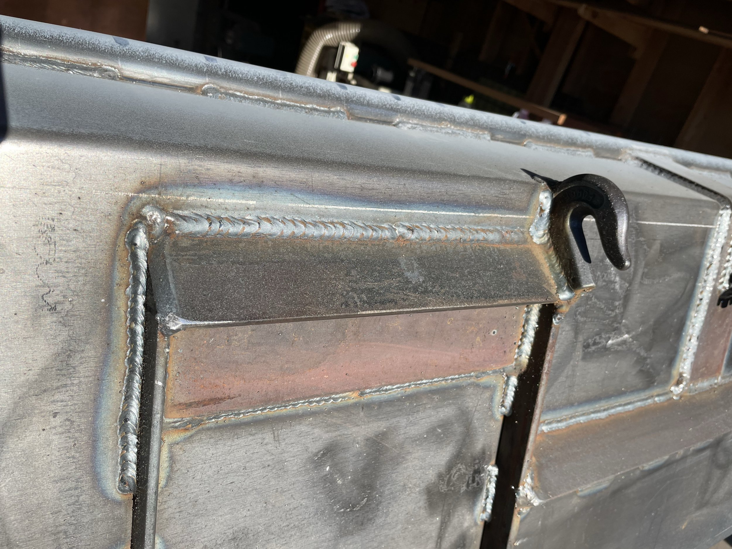

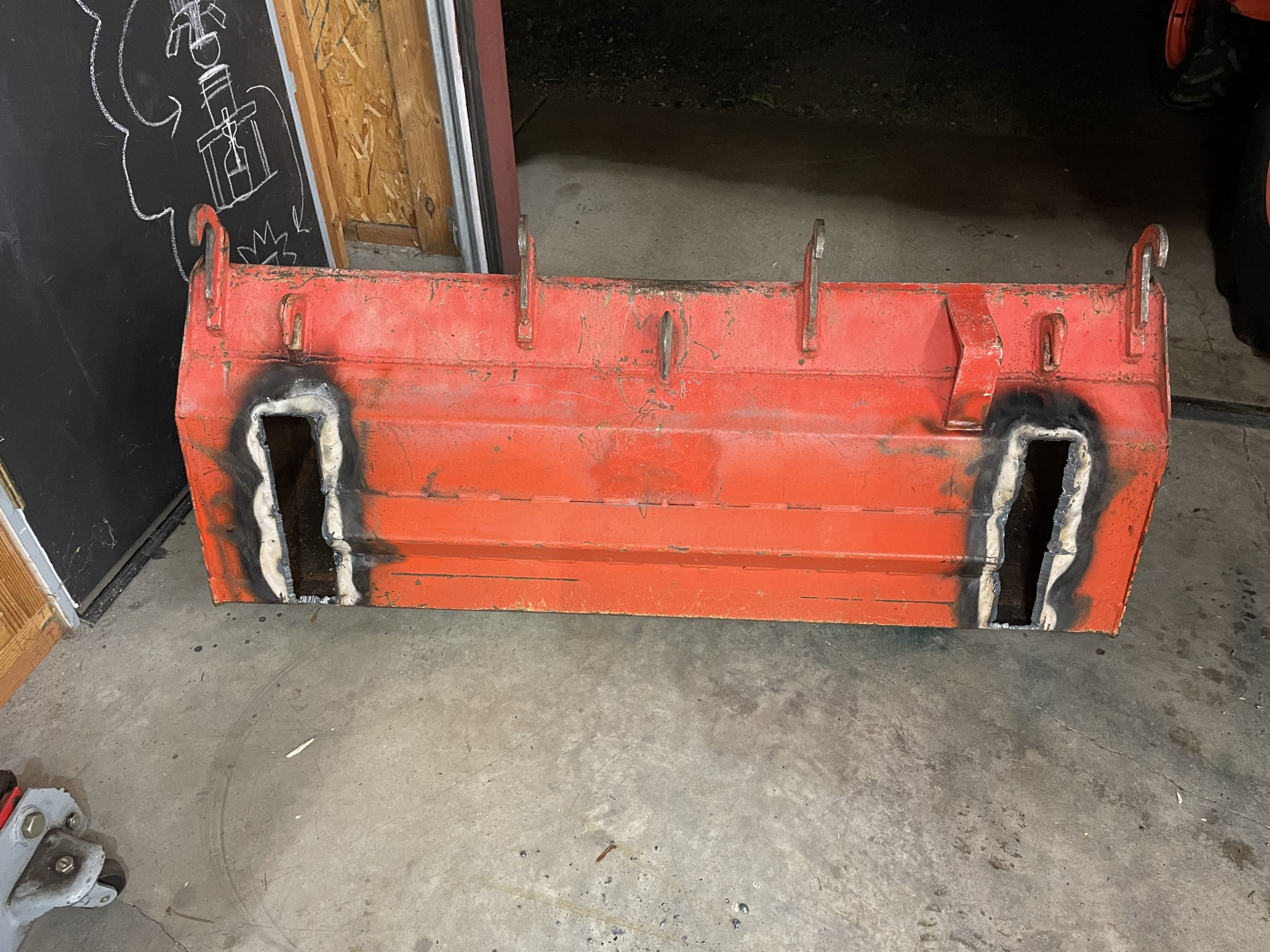

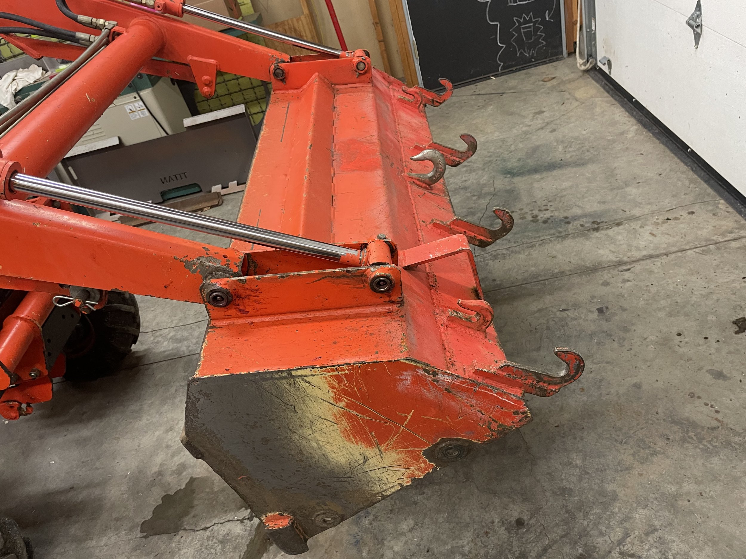

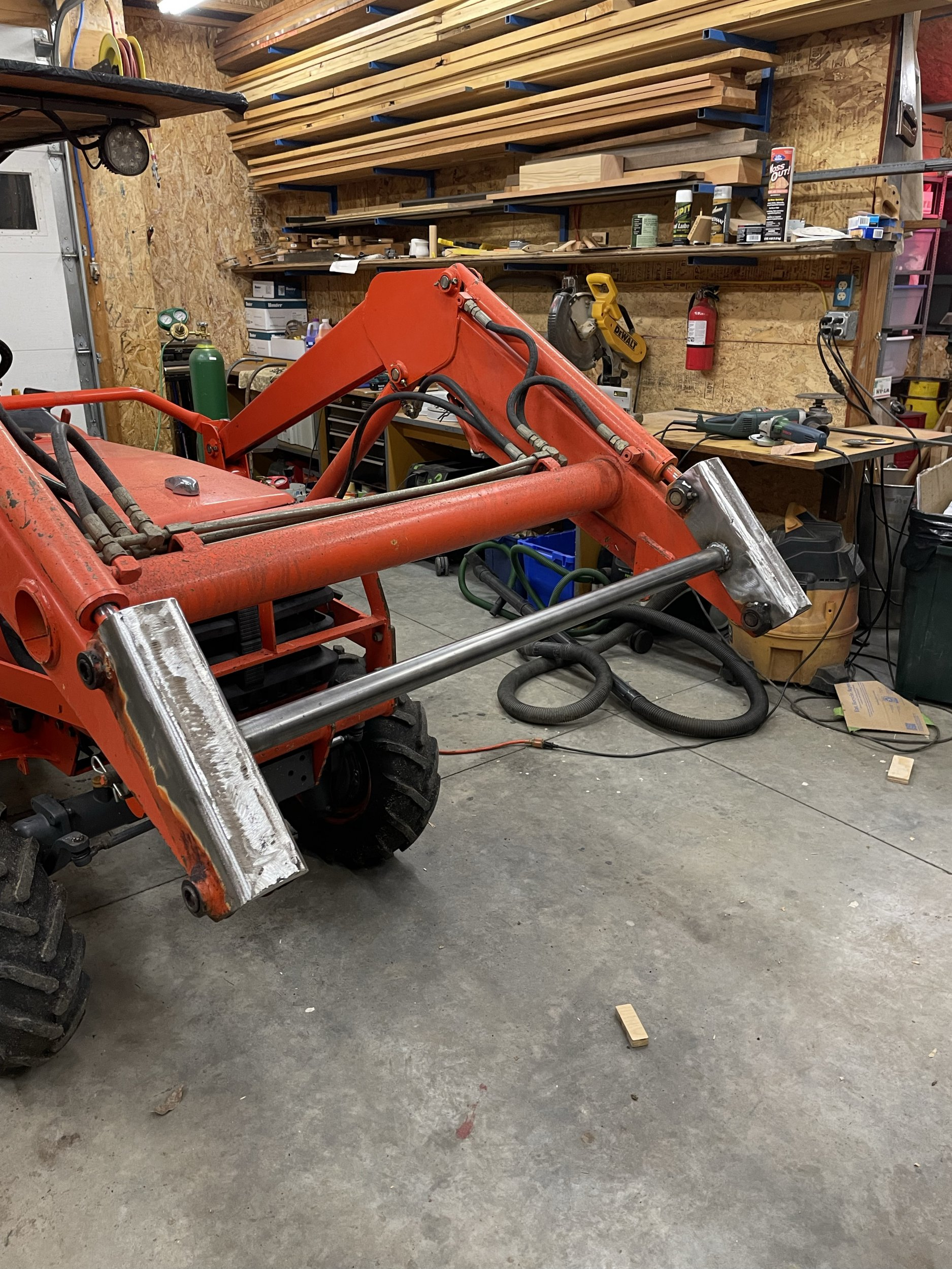

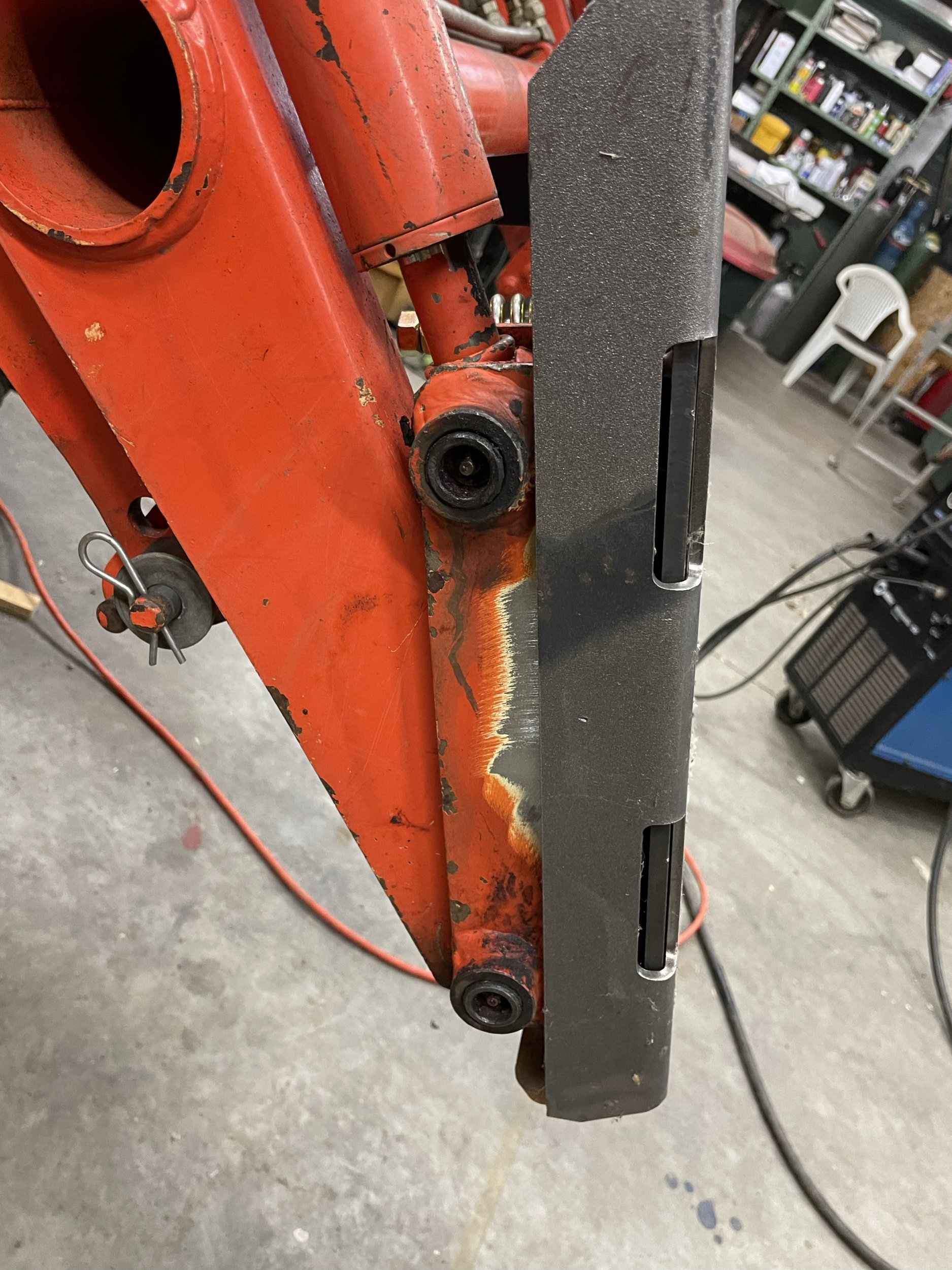

Ever since I bought the tractor I’ve been dreaming about making the front loader a quick attach. I finally took the plunge - no more hanging forks off the bucket or bolting on a light material extension! I wanted to keep the bucket as close to the pins as possible and keep the weight down. The plates I got were cheap and a little warped, but should work ok. So far so good…
Got to try oxy propane cutting and liked it a lot. Kept the torch further from the steel so the propane had time to burn and worked great - easier to see what was going on.

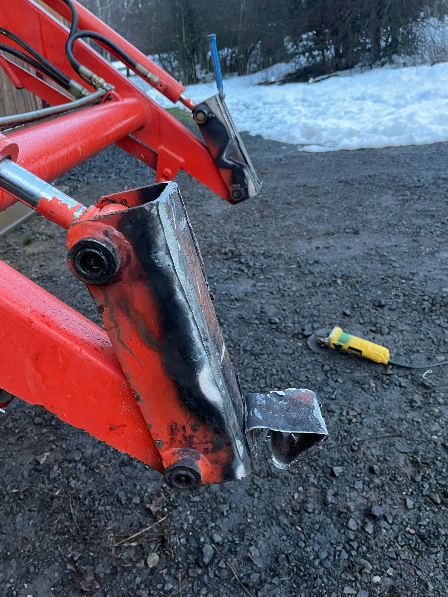

I wanted to get rid off all the old hooks so decided to cut the whole back/top out of the bucket and replace it.

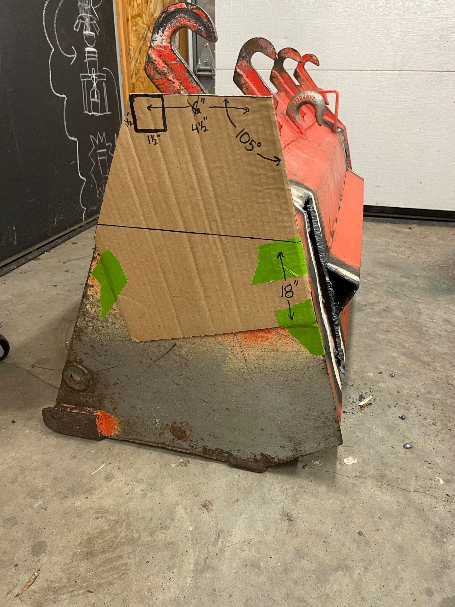

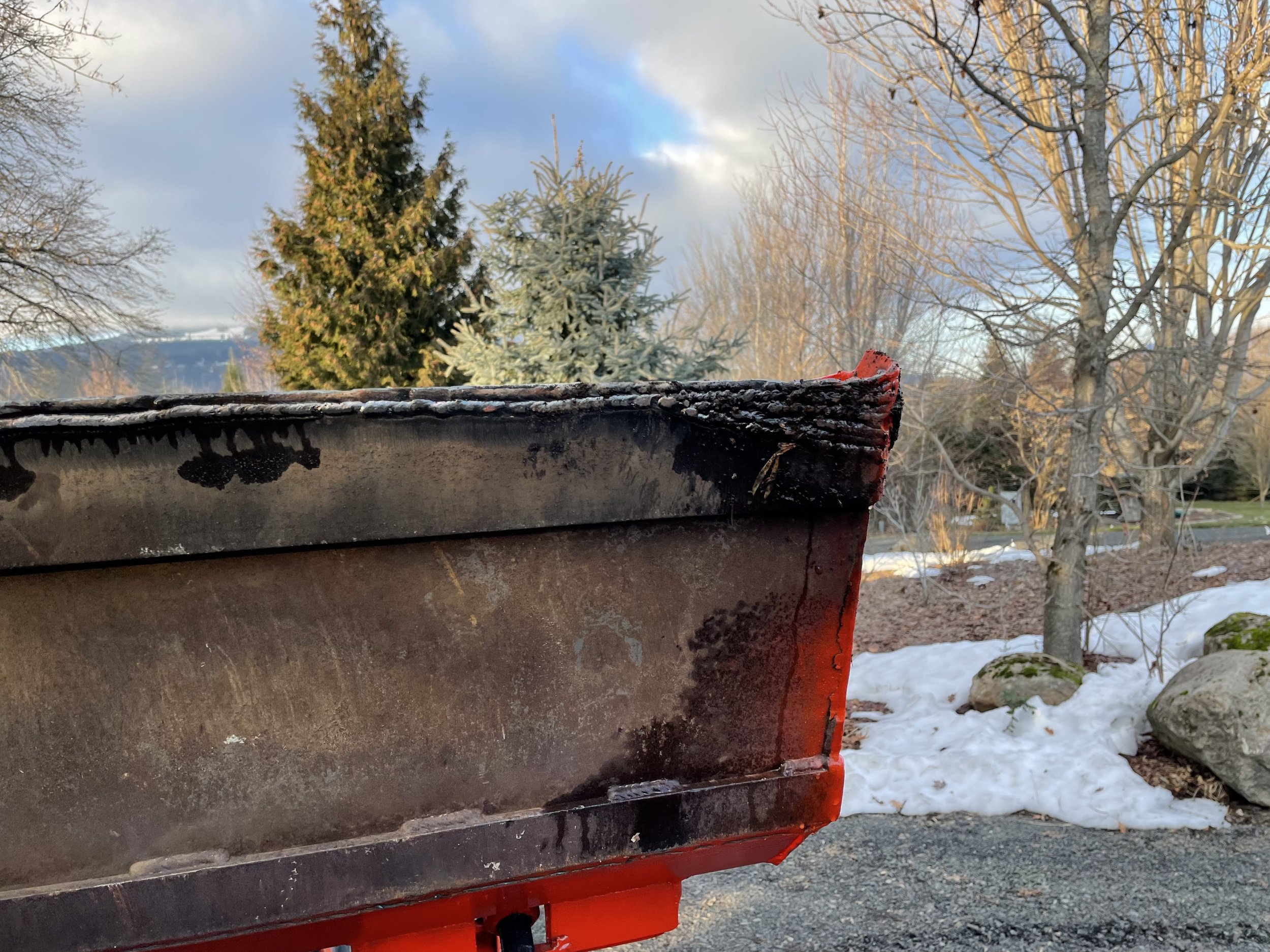

Had the new wrap bent at local shop. 1/8in steel. Top lip is 1.5x0.120 tube.
/ Quick attach bucket conversion for b7800
#2

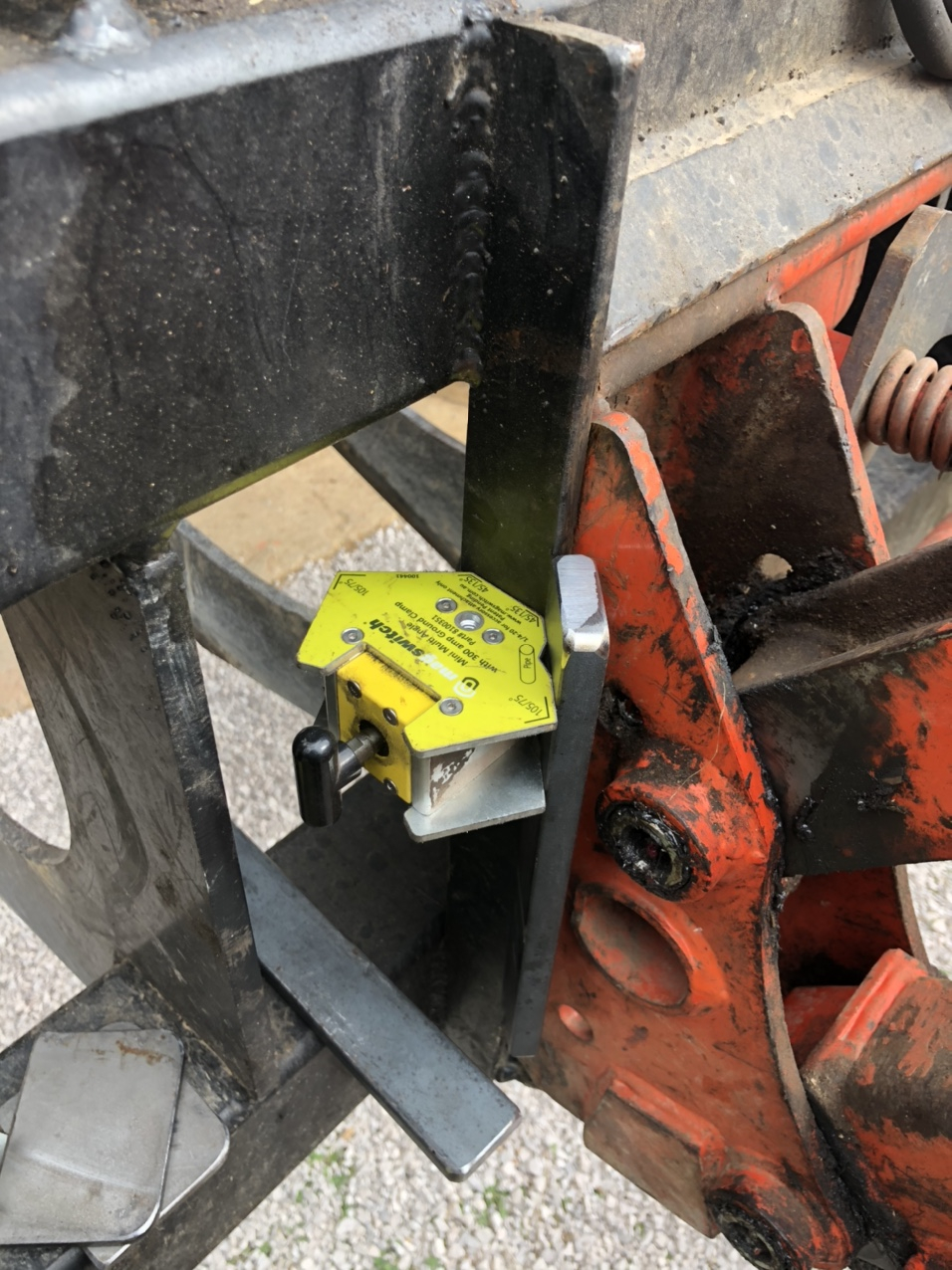

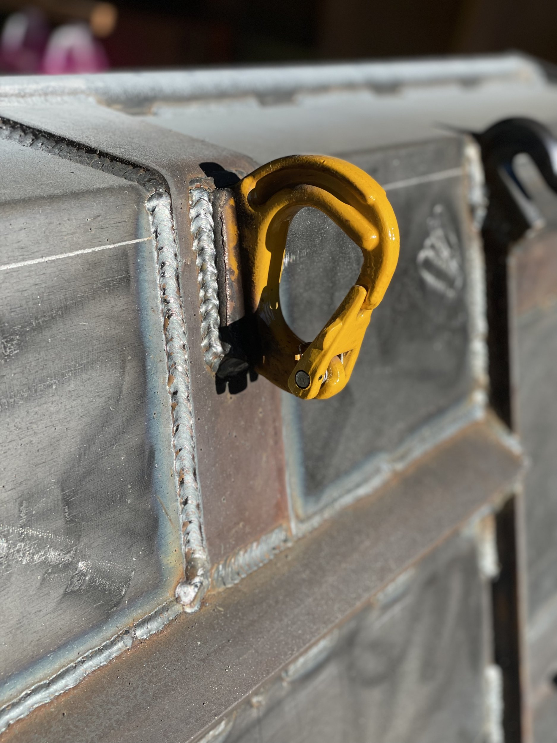

Lots of fussing around to get the new plates all squared up. Probably spent more time than necessary, but when I got it all welded up I could insert and remove the pins by hand so maybe it was worth it.
The connecting tube is 1.5x0.120
Tight fit! But it all worked.
New bucket is about an inch or two taller than the old one.
And the cutting edge was getting a little worn so I took the opportunity to run a little hard facing on the bottom corners.
I haven’t used it much yet and I still need to built the forks and light material bucket, but felt good to get started!

Thanks! I made the bucket side a little tight, but if I tweek one piece about a 1/16 I think it’ll go on and off a touch easier. Then, on the next one, I’ll keep things a little looser. I planned 1/2in clearance left and right (1in total), but kept the top to bottom really close. With the slight twist in in one of the pin boxes I have to press on the bucket a bit to engage the left pin.

Impressive work, great looking welds too.

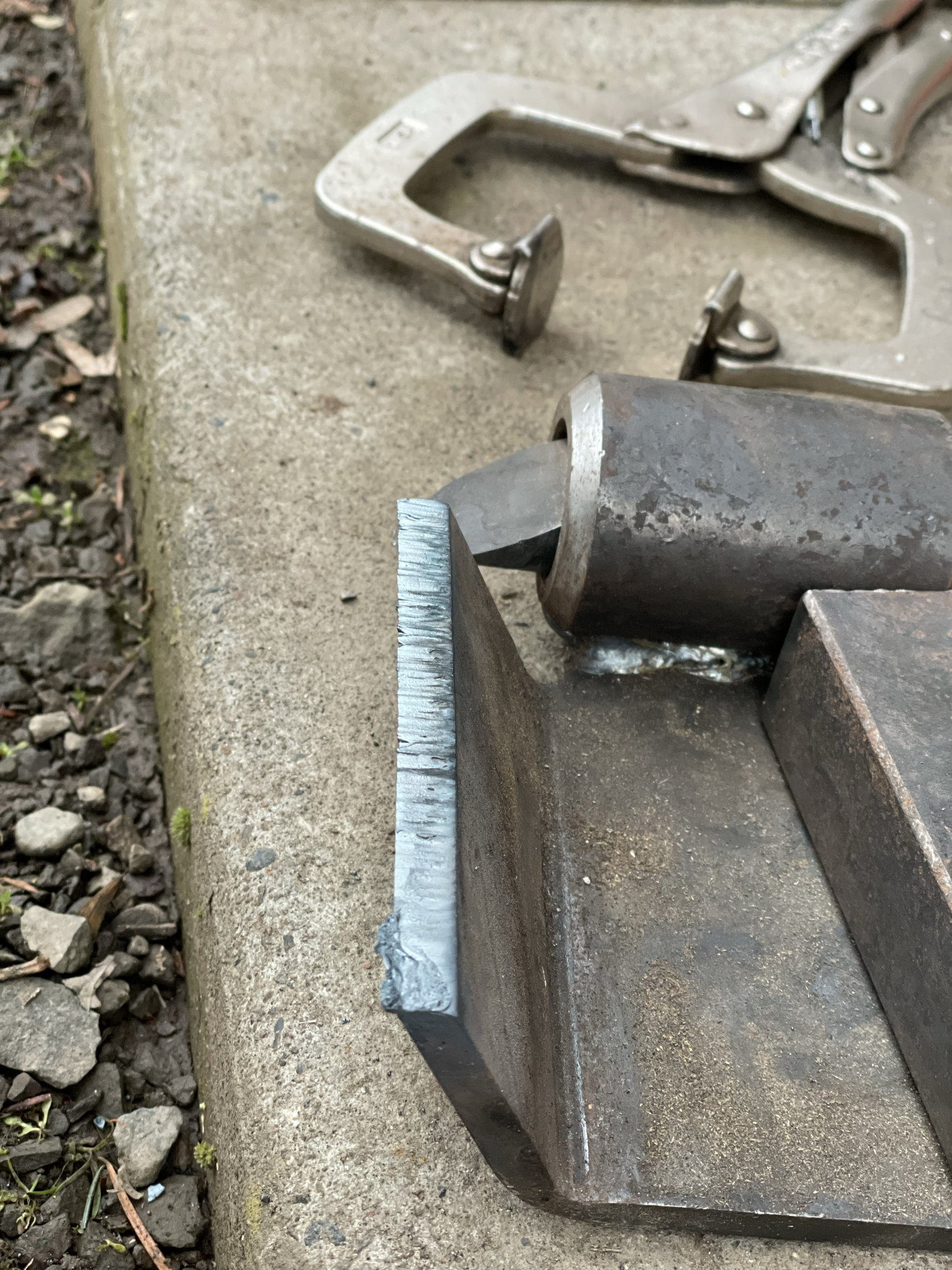

Thanks. I got mine from Titan. They are ok, but not great. The plates were twisted a bit at the top (maybe a 1/16in) and the pins/bushings were not very smooth. (I don’t know why they had to cut them on a large rather than just buying tubing and cold rolled stock.) I sanded the bushings just a bit and with grease they don’t seem to bind, but they did when they were dry. All-in-all they are probably fine for tractor parts.
The biggest thing is figuring out how it will all fit together without spacers.

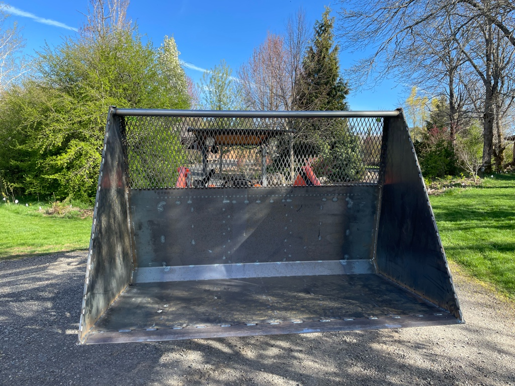

Thanks for the compliments. Heavy use will come this summer, but so far everything seems to be working.
Just got the wood chip, bark mulch, snow bucket done. Should hold close to a yard if the material is light enough. It’s 60in wide instead of 54in on the factory bucket. And I made it extra tall because I sometimes use it for hauling firewood etc. The sheetmetal is 14g. If I was doing it again I’d probably use heavier material and fewer reinforcements, just to save fabrication time, but I was trying to keep the weight down.

Pretty cool. You gotta post a pic of that thing filled up when you get to using it. 😁
