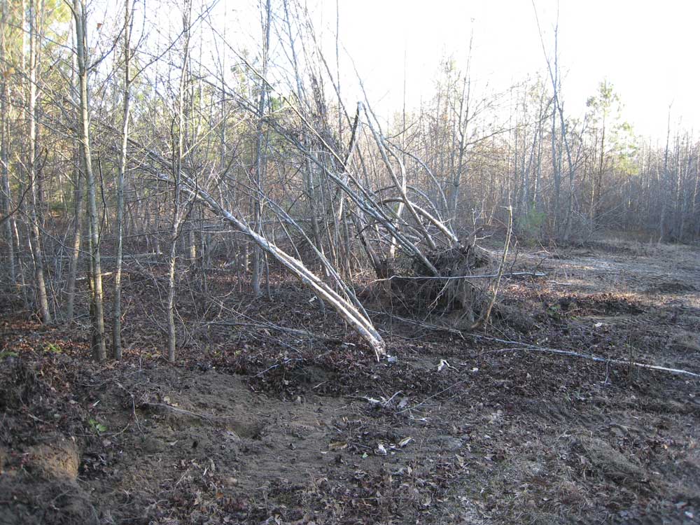

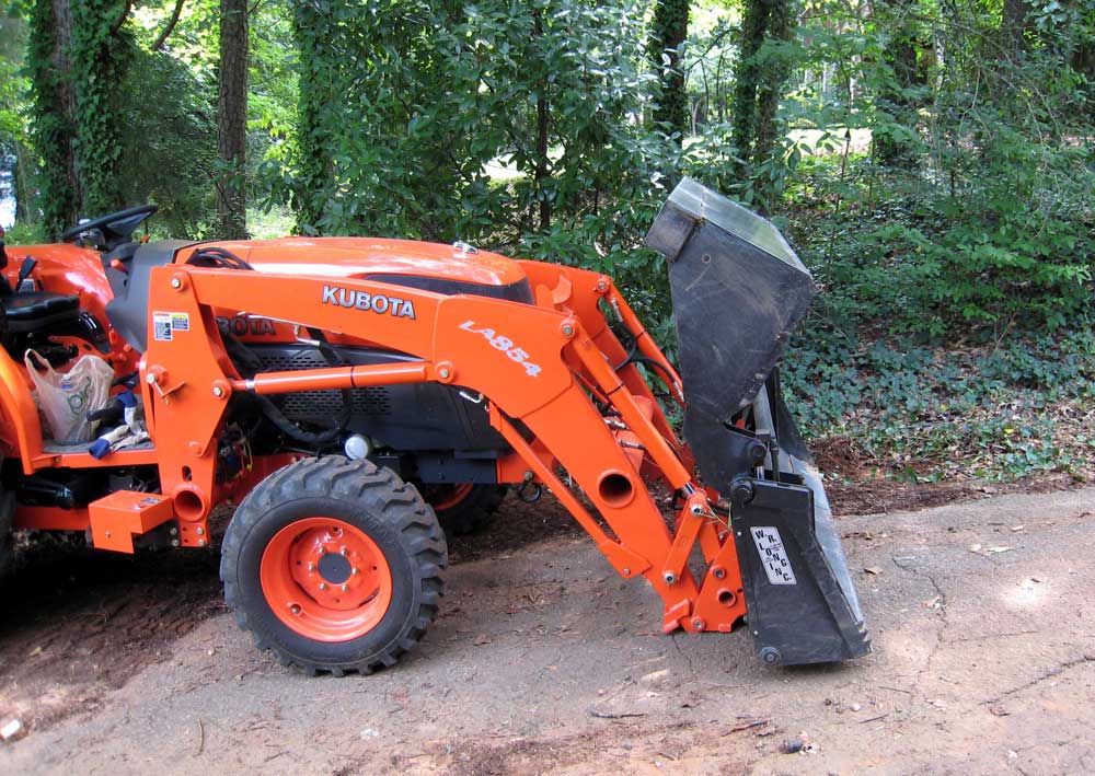

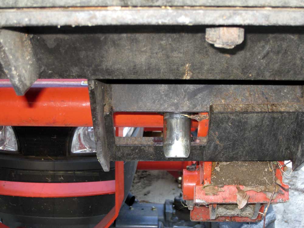

I bought a L5440HST with La854 FEL and a WR Long UJ-172 4n1 bucket with a WR Long B72 tooth bar May 07.
Shortly after I bought the tractor and had 50 easy hr on it I started moving some old debris piles and pushing over 3-5 inch gum balls. I noticed that the right side of the 4n1 bucket was loose. The pin that holds the bucket in place had popped out. When I tried to put it back in place, it became obvious that the right side of the quick attack was warped. The dealer said it would not be covered under warranty because I did not have a Kubota 4n1 bucket on it. Problem is Kubota did not offer a 4n1 last year. I now have about 110 hrs mostly light bush hogging and disking. I have not used the bucket until this week end. I was pushing over small gum trees mostly 3-4" occasionally 5". I always center the tree, lift the bucket and use the weight to push the tree enough to expose the root ball. Then I work it out of the ground. Now the right pin has come out again and I have again bent the QA. I can't believe that the QA could be so fragle. Any ideas?
I enclosed some pictures.
Thanks

When I first got my L3130 in July 05 I had similar problems. That slant cut on the pins would, when putting a load on the bucket or other attachment in the reverse direction, just cam out of the slot in the attachment. The spring was just not strong enough to hold the pin down. I put a stack of washers under the spring so that I could just move it past top center. When latched the pin only has 1/8-1/4 inch vertical free play. No more problems. Several others have done the same and it has worked for them. There was a Service bulletin or kit for this but I never looked into it.

I bought a QA plate and welded it onto a frame I had built for forks. In doing so, I warped the QA plate by making it conform to the fork frame (my mistake). Bottom line is that on one side the slanted pin was not going far enough down into the opening on the QA plate. It appears this is the same case on the 3rd pic you have attached. I ended up cutting about 3/16" of material off the hole in the QA plate where the pin made contact. This allowed the pin to go down further and engage better. I know this weakend that point on the QA plate, but I felt it was minimal, and since the QA plates are designed to withstand extreme weights (skid steer, etc.), I didn't feel I would have any problems with the forces I would be able to apply with my 1100lb. lift loader! If that was a concern you could always beef up the thickness of the remaining contact point.

I think you need to check the spring rod length and the stop position. The pin appears to be up against the stop. Measure each side and check pin protusion with the pin against the stop. The stop may in the wrong place. It could be that your bucket is made wrong. Have you tried it with the factory bucket or aother attachment?
   / Quick Attach Broken AGAIN!! #7
Sloppy Q/A fits on other skidsteer attachments can break the tips. My LA853 loader was fine with the factory bucket but popped out of the forks I had. I bought the kubota fix kit for a few bucks, it had a washer spacer but there was also tubular spacer to go inside the springs that limited the amount the pins could move the spring.

It is not the spring which keeps the pins down. It is the metal stop above the bolt which keeps the pins in place.
   / Quick Attach Broken AGAIN!! #11
Verrry interesting! Neither of the local dealers or anyone else I discussed this problem with, had ever heard of it. Certainly neither had heard of the kit. I first started having a problem with the Anbo grapple rake and after some head scratching, decided to weld a piece of 1/2 barstock to the QA plate at the location that the pin engages the slot therby allowing the pin to carry the load at a thicker cross section than previously when the spring compressed. Observation told me that the load acting against the pin caused the spring to compress allowing the pin in turn to ride up and out of its engagement slot. Sounds like the fix discussed above accomplishes the same thing, more elegantly limiting the back travel of the pin and spring compression. I broke 3 pins before devising this fix and have now done the forks, bucket and grapple. Having heavy loads bearing on such a thin cross section as the tip of the pin is a failure waiting to happen. Now my pins are broken off 1/4" up, but no more falling out of the slot back dragging and whathaveyou.

That 3rd picture of yours doesn't look right. I think the main surface of your QA should be seated on the main surface of the implement and yours has a gap there. If it were seated, your locking pin would be penetrating the implement more. Is there a gap between the two main surfaces on the left side as well?
If my loader valve weren't broken, I'd put the bucket back on mine to see how it mates.
