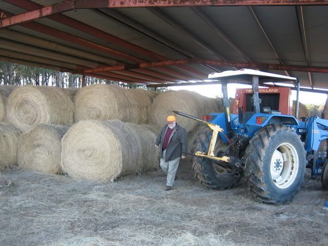

If the bale is rolled good and tight you won't get a spear in the round side. I don't understand why you want to stack the flat side down. If you are stacking on dry sand/dirt under a shelter, spoilage will be negligible either way in one year's storage. The rolls in this picture were two years old.
When I was hauling and stacking round bales, I left one on the rear spear as ballast. As you see, it really doesn't protrude that much in the rear. Also, you will be much betternpleased with a front-loader spear that replaces the bucket rather than one that bolts to the bucket. I have tried them both and there is no comparison.

Redlevel - good comments, but your photo didn't come through. I was planning on a FEL spear that replaces the bucket. Only reason I wanted to stack flat side down is to avoid having bales roll and start pushing on the sides of the barn, possibly damaging it.

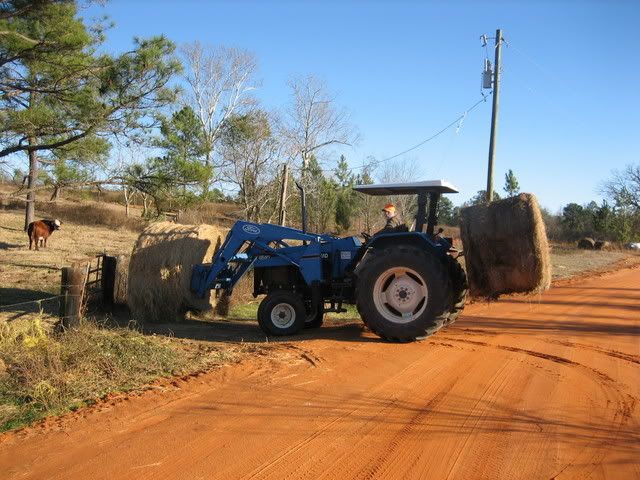

You will quickly figure out the most efficient way to do it. It is easier to put the bales exactly where you want them with the loader. Typically, I would get my rows started with both bales (front and rear), then start "stockpiling" the bales from the rear spear. I would stack the bale I hauled in on the loader, then back up fifty or so feet and drop the bale off the 3ph outside the barn. When I accumulated 15 or so bales, I would start stacking the ones I had stockpiled. Then I would start over again. That is much quickier than trying to back in and stack them in the row off the 3ph.

Fork on rear and FEL spike... I use all the time.
Always put bale on rear FIRST, then spike one on the front. Yep, you know that, but it's worth repeating.
Always carry front bale as close to ground as you can and not rake hay off.
WARNING...attempting to place bale with FEL without serious rear ballast is dangerous. Every time I get myself into a situation and attempt it I get wheels off the ground and recalibrate my pucker factor... just drop the front bale and place it with your rear fork.
You can turn bale on end using spike..that's how I drop bales into round bale feeders... raise over feeder edge, tip over, let it drop into ring. I do NOT recommend this as a method as the base for your hay stack. You can't manage them properly. Put them on their side as in REDLEVEL's photo. That works best. They WON'T roll... they flatten on the bottom
Once I tried an experiment to stack bales 3 high....couldn't do it with my equipment...didn't get it high enough... SCARY too, even with round bale (1300lbs) on rear fork, 1000 lbs of liquid in tires AND 300 or so extra lbs on the 3ph.
Suggestion... maybe somebody in your area could let you borrow a FEL spike and 3ph fork and you could try stacking some in the field...to get a feel for it. This way, you KNOW what size bale works with YOUR tractor using this technique. I'm not very familar with your tractor... but my FEL lift capability is 2800 lbs or so.... and there are times when I don't fully spike a 1500 lb bale and the relief valve pops..then I need to reposition bale closer to tractor.
Be aware that the 4 wheel assist/drive can be decieving... you have good traction until the center of gravity moves just wrong on you, then bad things start happening fast... so, just move slowly and be ready to drop your front/rear load at all times unless you know you are well balanced and not going to hit pot holes or tilt.
