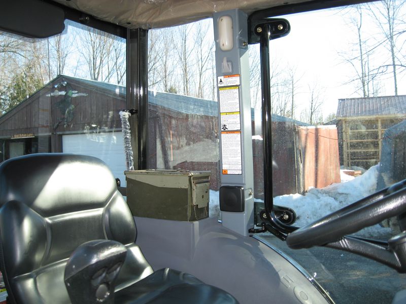

I know this has been talked and posted about numerous time and I have gone and searched everytihing that I can find about them. I have come to the fact that I want the W. R. Long Electric over Hydraulic Valve Kit.
I have a Montana 4340C tractor that I will eventually put a grapple on and a plow on the loader.
Does anyone here have a breakdown lost or directions/parts lost that came with your kit to show what is included that you could share?
I know this kit can be a little pricey and would like to know if you could just buy certain parts not the whole kit to save money?
Another thing is that my loader control handle has 3 knock out holes. Does anyone know of a switch that I can use to put in to my hand instead of replacing it with the one supplied from W. R. Long?
I will attach a picture of my control handle. It is on the lower left of the picture.

I can't help you with the kit because I only bought what I needed.
Regarding your loader joystick handle, it's much nicer than the WR Long one. I would contact your dealer or web search the maker of it. With those punched out holes, they are obviously designed to take switches. It follows then that they should have switches for them too. A rocker switch comes in the WR Long kit so you can nix their switch and joystick handle. As a matter of fact, you can buy the Hyvair electric over hydraulic valve from Surplus Center too for a lot less. If you can get your own switch, and hoses ... and make your own mounting brackets and bulkheads, you could do the whole hydraulic thing yourself for quite a bit less, I'm sure.
Check out this thread when doing all that to my wife's 284 Jinma. Components (and cost) needed to do it your self are all listed, including a new joystick (which you don't need) starting on post #21.

Thanks guys I have gone over all your threads many times and they helped alot. I emailed WR Long and he said that the cost was around $600 - $700 for the kit. He is going to contact me later in the week to give me details.
My plan is to get peices from WR Long as I don't need the joystick handle, brackets, QD's, and hoses.
My only problem right now is that I am trying to look for a switch for my handle. I need 2 buttons that can be wired together that will fit in the handle. I can find buttons and rocker switches, but I am not exactly sure what I am looking for and how to hook it up. This is why I came to you people as I know you have alot of knowledge and first hand experience on hooking the 3rd function up.
I did emailed Montana and they told me that they did carry a kit but it is just a diverter I think and the guy didn't know for sure. All he gave was a part number to take to my dealer. I will contact him later this week for price on that kit and find out more information on it. He is still trying to convince me to run hoses to my rear outlets and run it that way. I wouldnt mind it but if I want to put a TnT kit on this would make it impossible to run the grapple or what not. And I like the idea of having the switch on the handle and no having to reach for another lever.
I know that the kit from Montana has one button for the control. Is it possible to get two of the buttons and hook them up to make a rocker?

Update on my progress for installing the 3rd function kit. I contacted WRLong and he said that they dont make a kit for my tractor yet and has not installed one so he recommended that I build one myself. The only thing is I ma not sure what I need. I know I need hoses, quick disconnects, and such. But which solenoid valve, subplate, and connectors. Will the ones that 3rrl got work for all tractors or should I be looking for something more specific?
Also I have been in contact with Brian at Scorpion Technologies. They sell controls, handles, and switches. They have been very helpful in building switches to insert into my handle instead of buying the whole thing. They are great people to deal with and they bend over backwards to help make anything you wish. I highly recommend them for all your control handles and switch needs.
