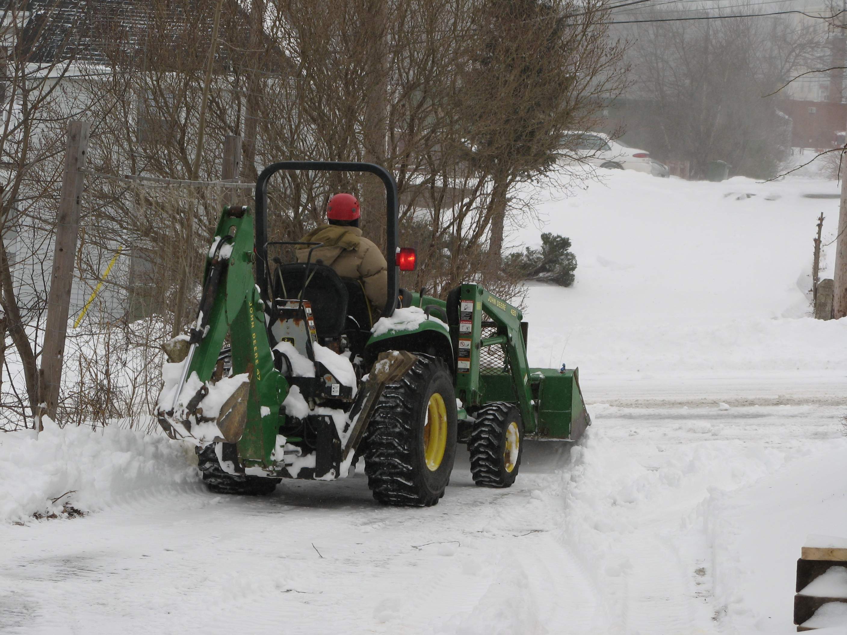

I have a JD 4200 HST with attached no. 7 backhoe. It would suffice for the tasks you mention. :D
Can't comment on the other tractors you have listed.:eek:

Egon -- are you Green?? What have you done with your 'Bota?
Hah, you still have snow..?!? Ours has been melted for weeks.... (in my mind's eye - this is Hawaii). :thumbsup:
AKfish
/ Questions for the JD CUT experts #8
The Little Mule was exchanged for a little larger JD with a backhoe several years ago. The picture is from last winter. Our snow is gone.:D
