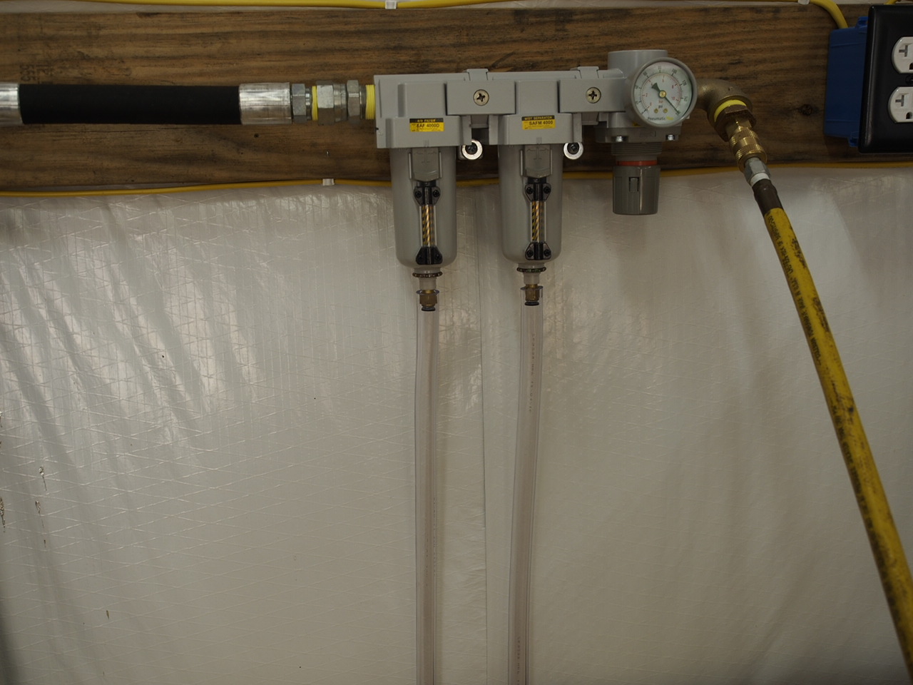

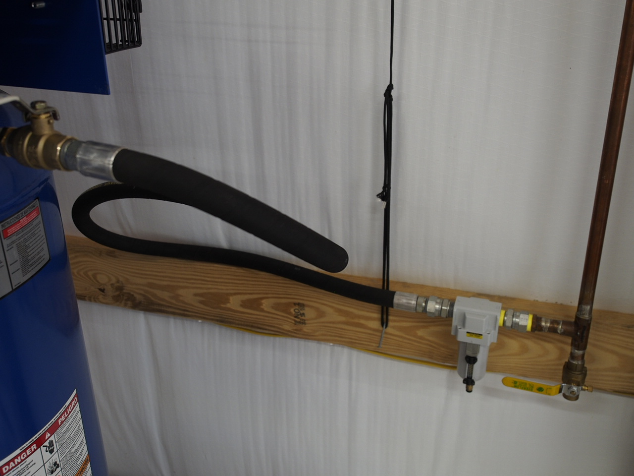

The IR cooler has an automatic drain also. I use a Motor guard filter system also.
+1 on the Motor Guard filter. Mine is mounted on the plasma cutter cart fed by a reel of 1/2" hybrid air line for cart portability and 40' of 3/4" copper tubing for a radiator with an automatic drain water/debris filter at the Quincy dual stage air compressor outlet and a dual auto. drain set at the other end of the copper with all ball valves the full flow type. The air at the plasma is around ambient temperature and dry. All of my consumables last quite awhile unless I am dragging the tip. I am considering adding an auto drain valve for the compressor itself in case I happen to forget to drain it.
