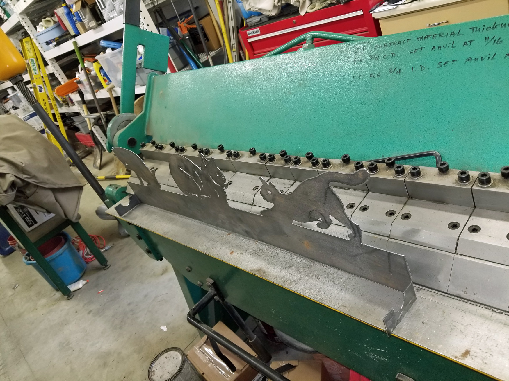

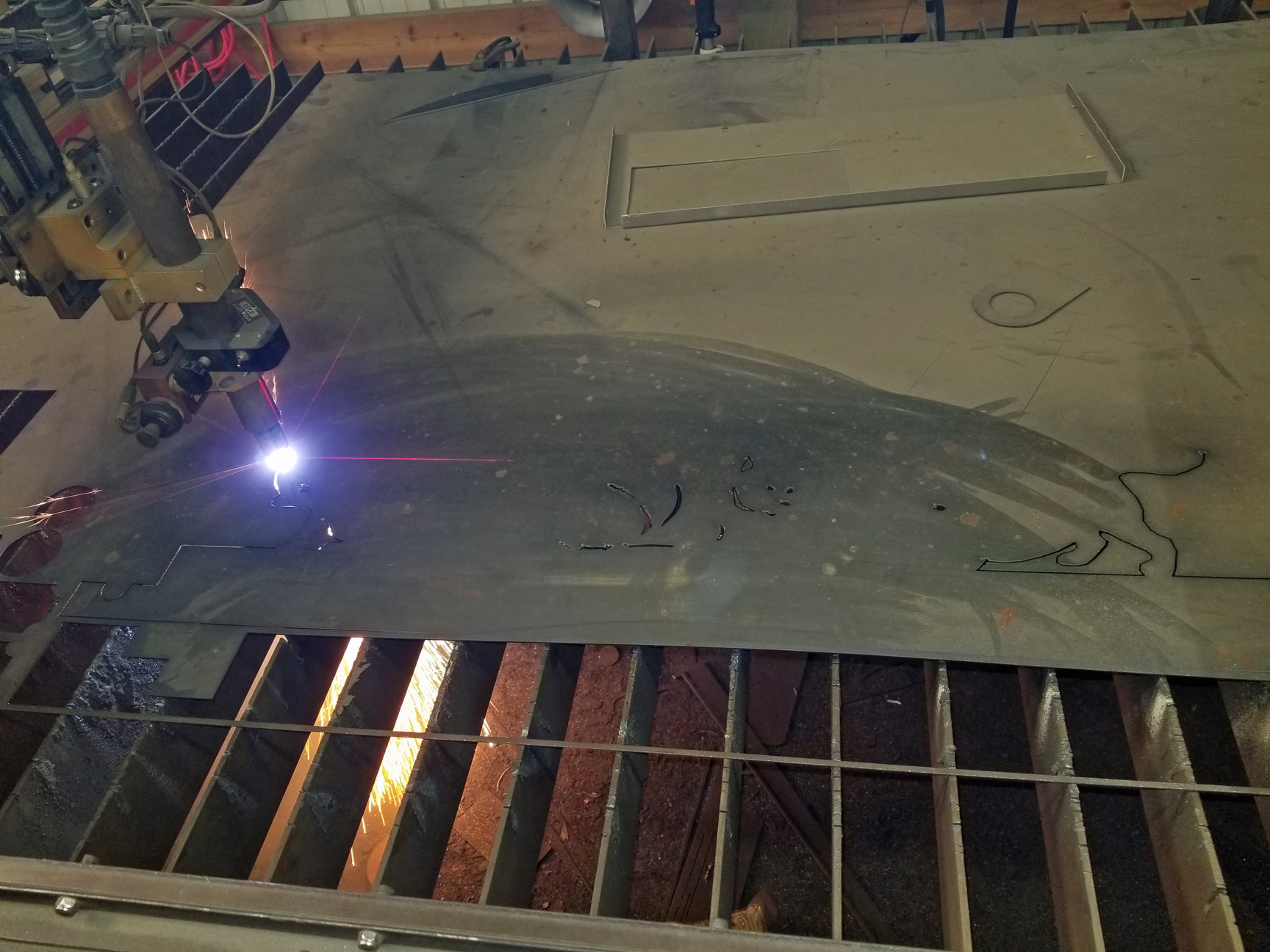

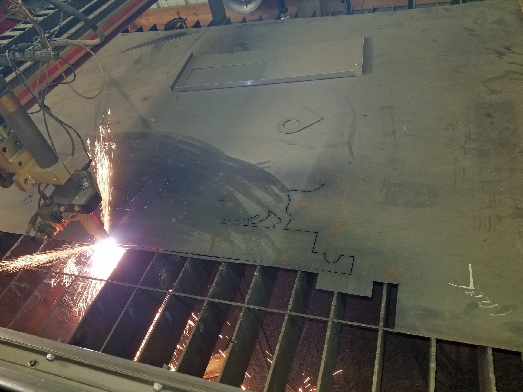

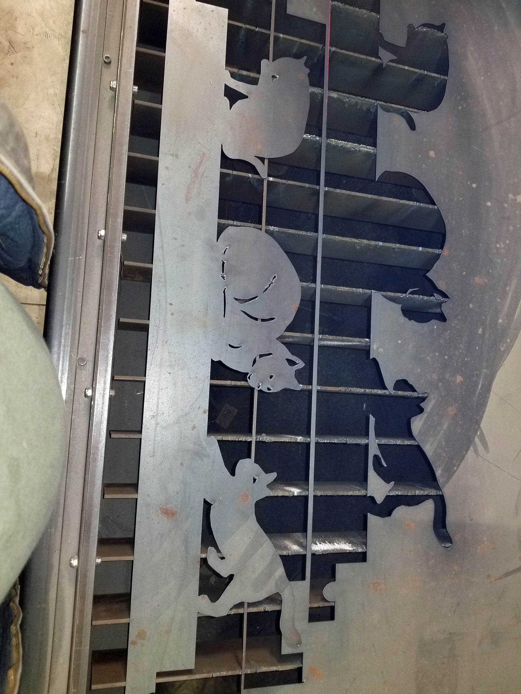

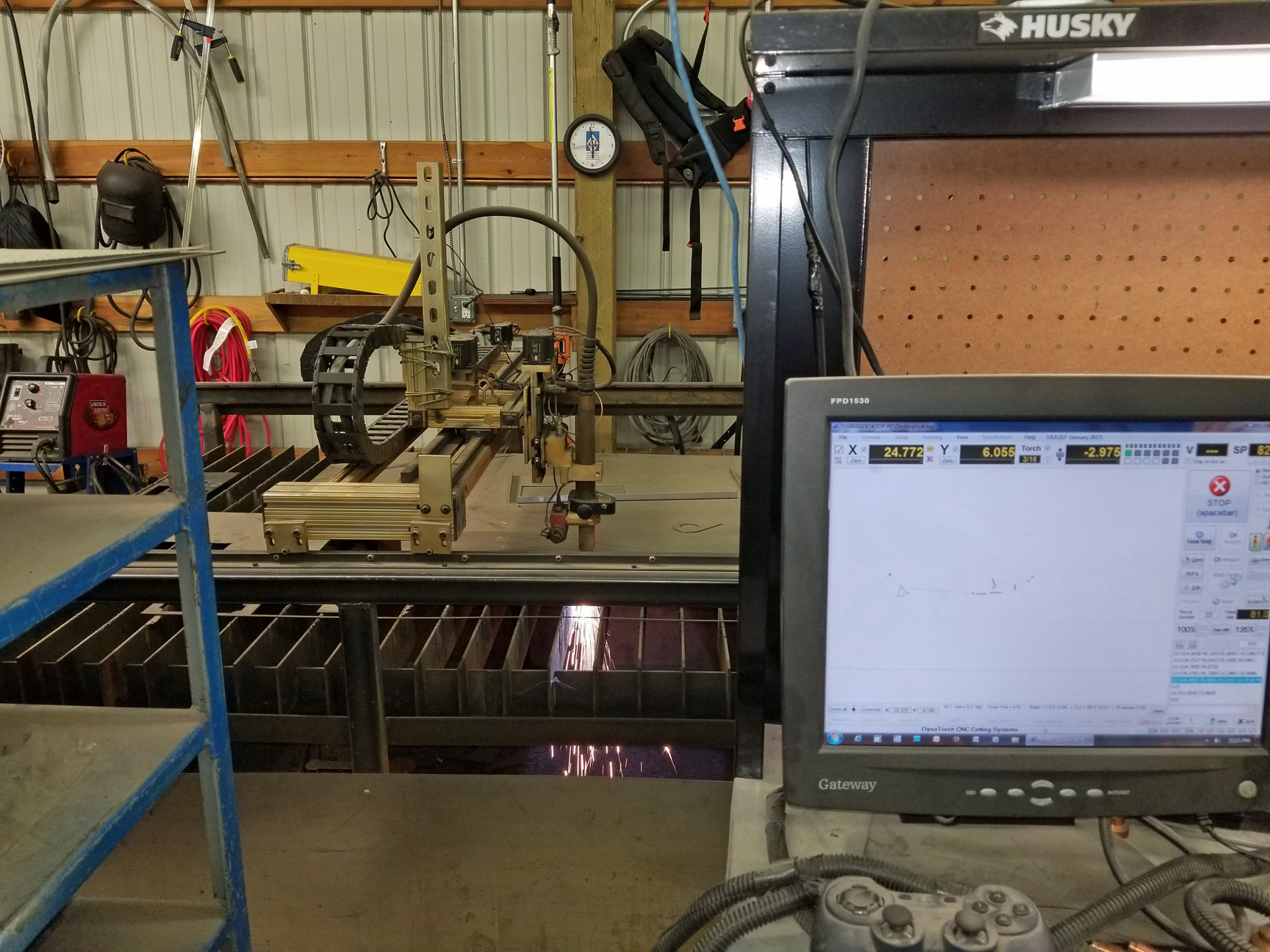

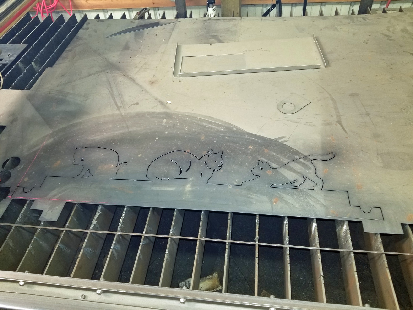

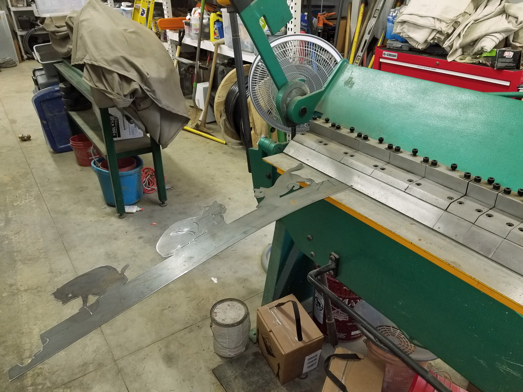

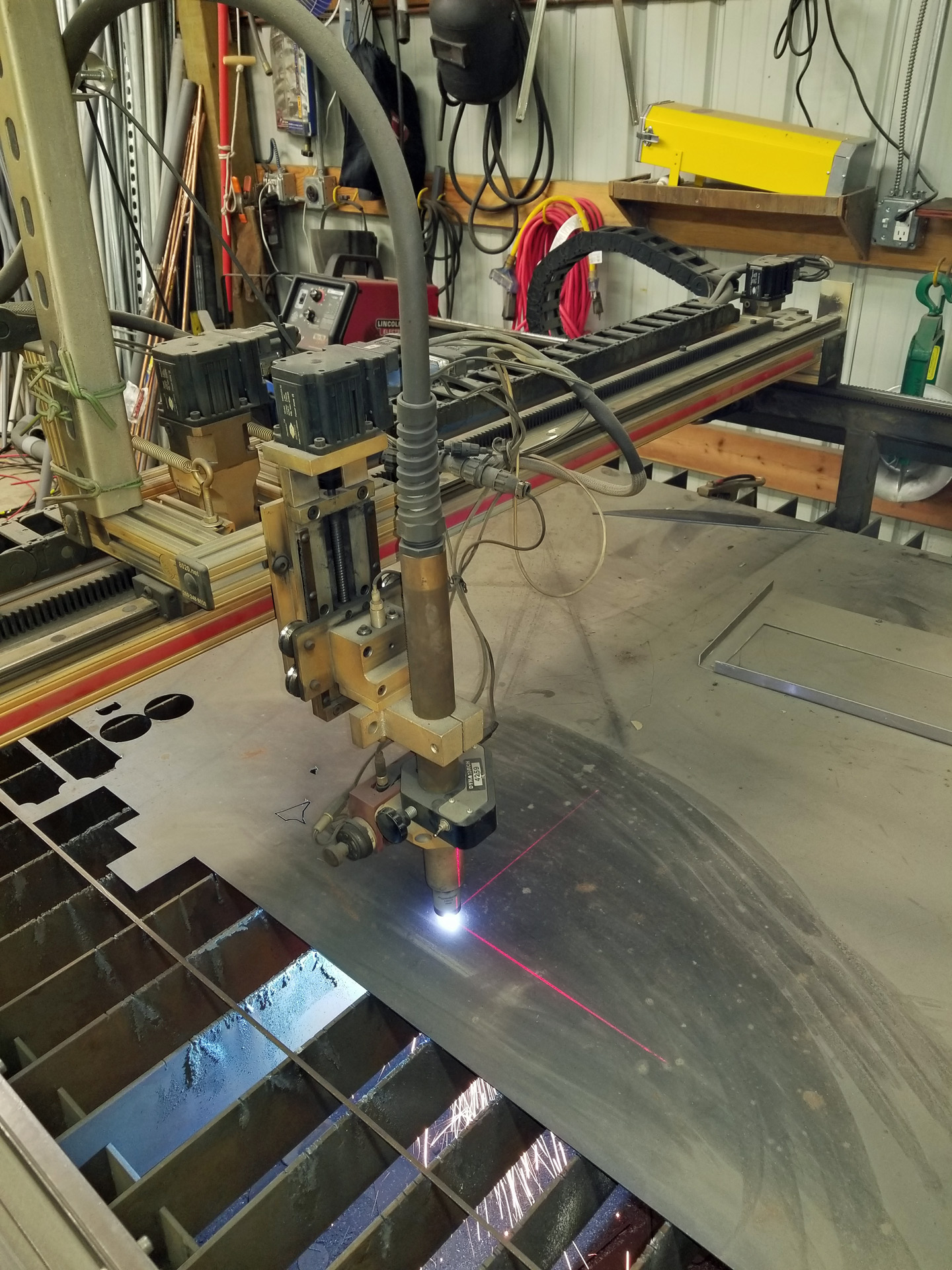

i was cutting a new quilt hanger base for the wife today. thought id post a few pics and a file on it cutting. 16G metal. 190" cut with 21 pierces. my unit has a torch height controller.
heres some youtube links
20180408 121248 - YouTube
or
20180408 121408 - YouTube

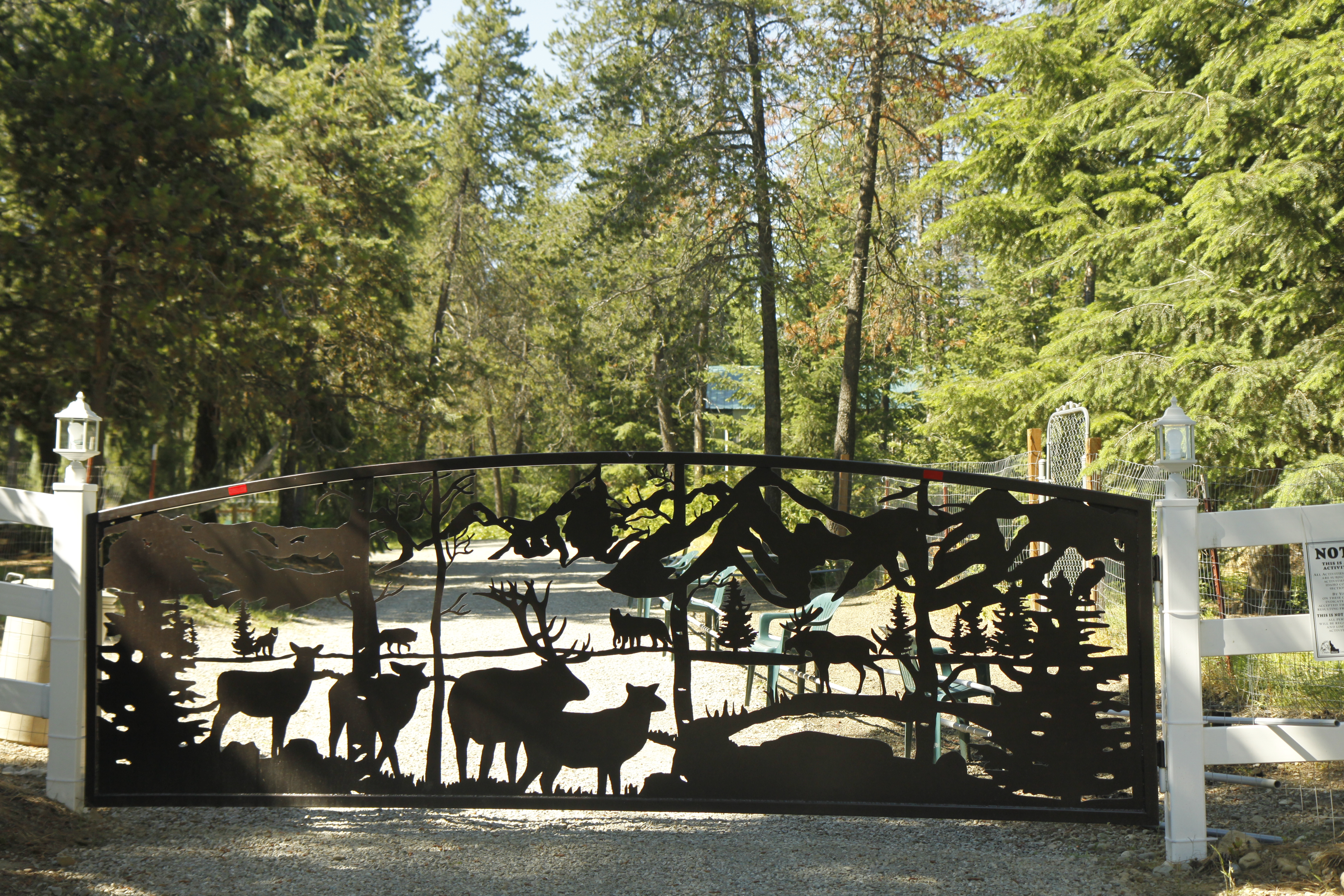

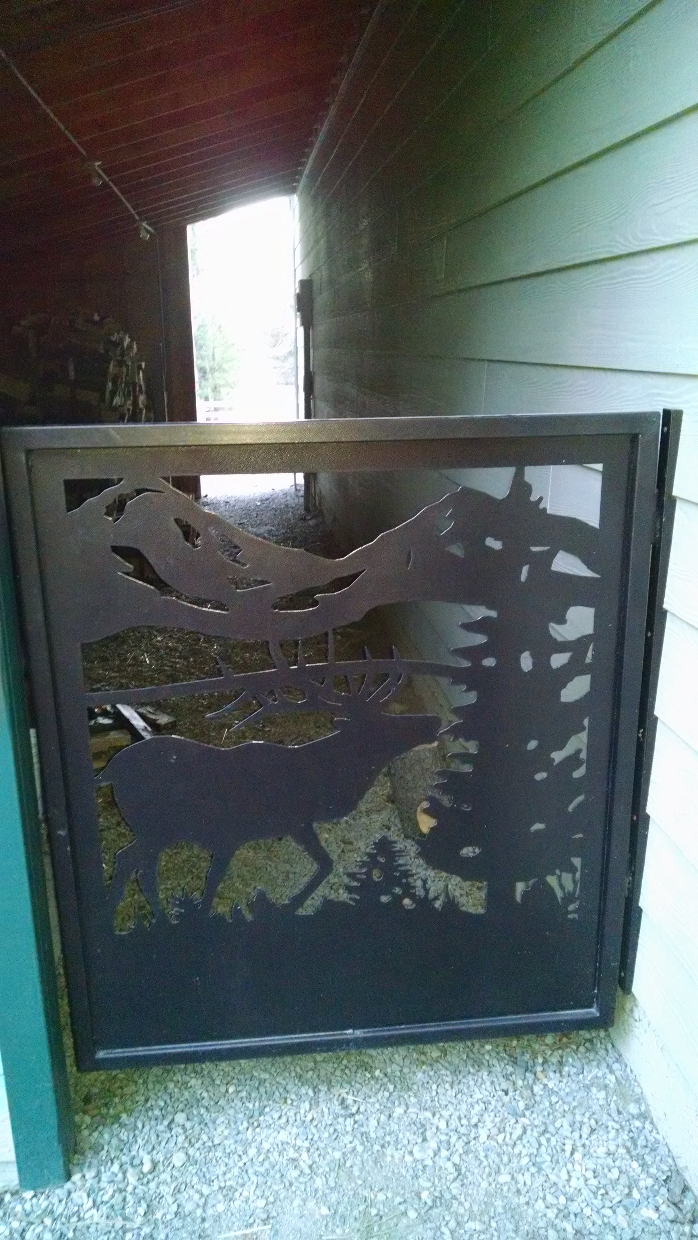

a few years back i made this gate . i even cut 3 notches in a 1/4" thick 5x5 steel post and powder coated it white to match existing vinyl fence so i could carry the 600 pound gate. it needs no wheels._MG_2001.JPG

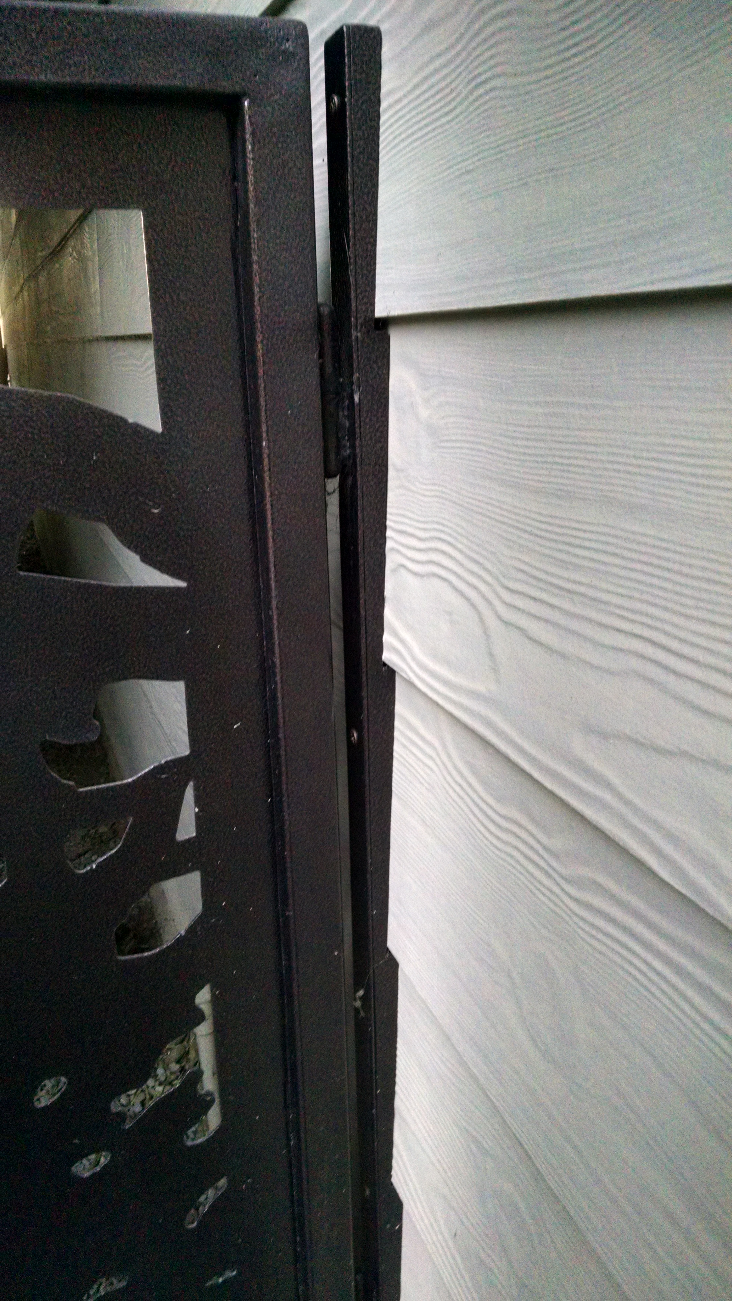

then i made a man gate. i even made the notched side bracket that mounted to the lap siding to hold the gate. was alot of fun . i love making gates, but they take alot of time and are too expensive for most people. IMG_20150223_170738113.jpg IMG_20150223_170658372_HDR.jpg

im using a Dynatorch table with a Hypertherm plasma torch system. mine is kinda old...like 10 years i believe. the newer systems are better, but i have no intention to upgrade my system. Ive done software upgrades every few years thru dynatorch, and the Hypertherm system has worked flawless the whole time. My table has automatic torch height, automatic crash detection, laser light tracer to check cut path prior to actual cutting.
cutting is easy....getting the art work onto the program takes some practice. I use both Autodesk CAD program and Corel Draw for basic work, then i have to export as a BMP and then tract the work with a program called vextracor. then its off to a program called Enroute that installs the cut directions to the work. thats all automatic, as it assigns all the inside cuts first then directs the exterior cuts. that took some time to set up years ago, but now is all automatic.
then its off to the cutting table.

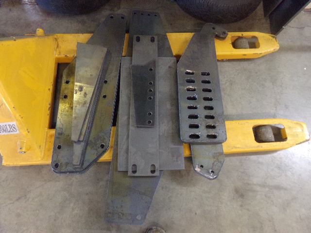

   / Questions for TBN members who own plasma cutters #69

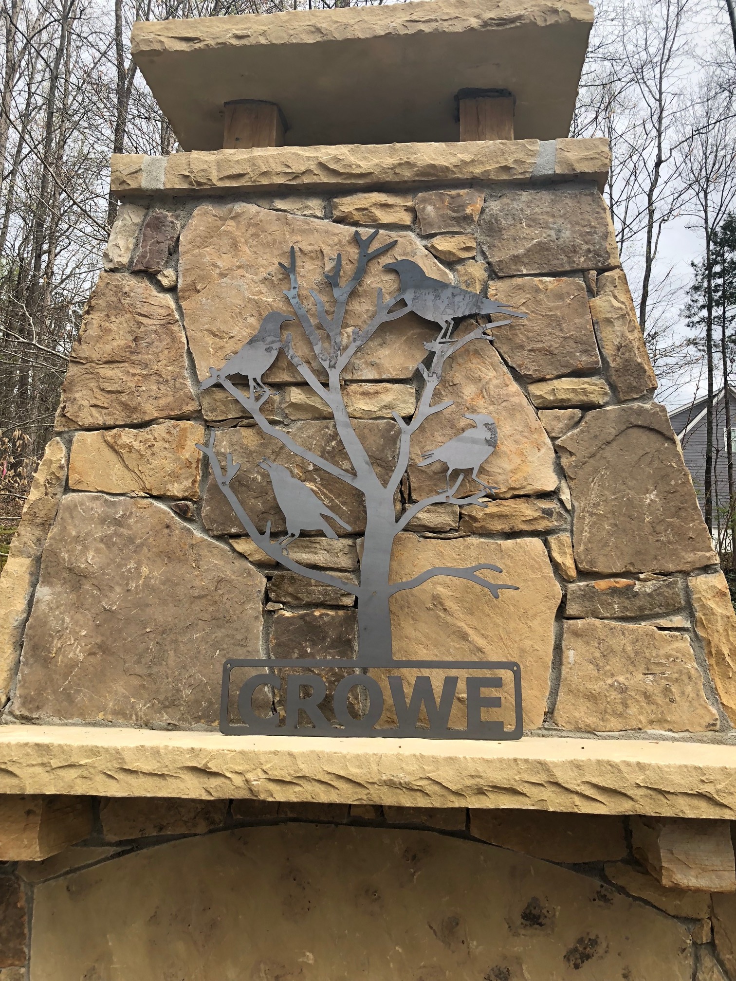

cut some 1/2" and 3/8" plate for loader brackets this week.
