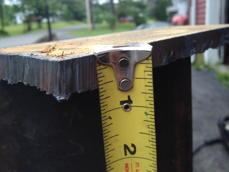

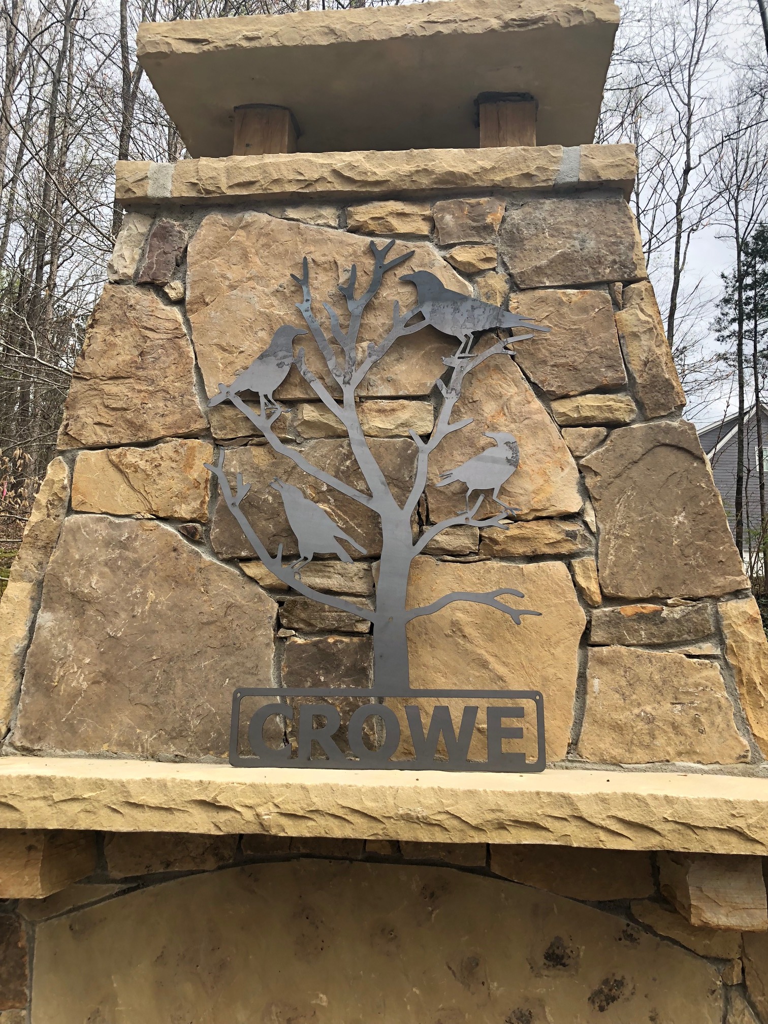

Sorry for double post, TBN being weird and not letting me upload more than one pic.
Cut this freehand too, 1/2" thick. No problem with the PM45 (not the xp, mine is older).

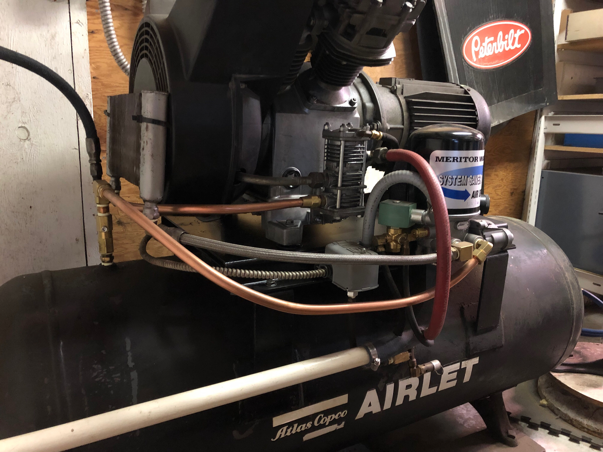

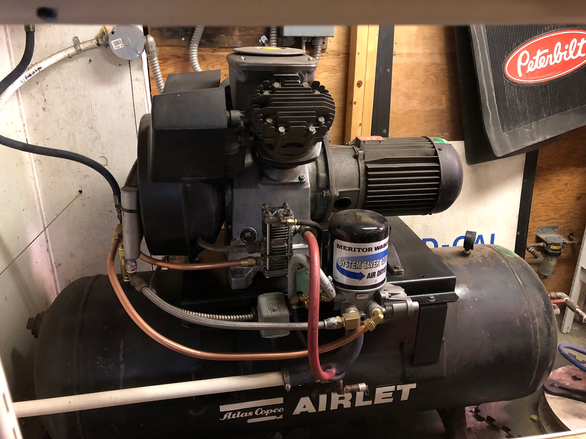

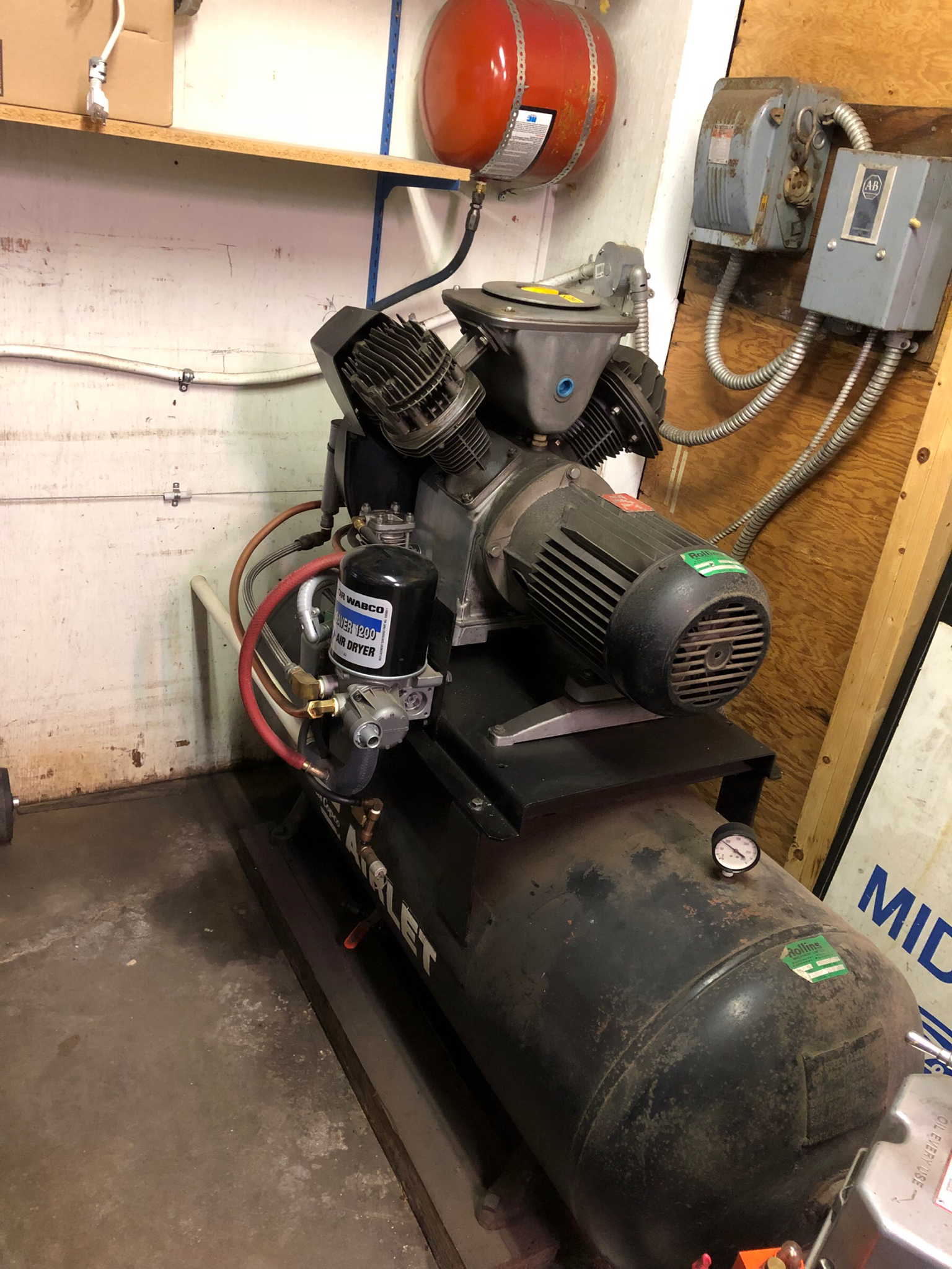

Hmm , Interesting Thought . I usually rebuild the drier on My semi , cheaper than buying a rebuilt one . I know most have 12 volts going to them , But I can't remember What exactly that did , But was told that is would work without it . Only issue I foresee is when ever it pops off at cut-off pressure , I would hope that it would be enclosed in a box if in the shop , or located remotely , Otherwise that constant pop off noise would get to be annoying at the least .
Fred H.
Fred and muddstopper: This truck air dryer was installed by my mechanic years ago and works extremely well.
The last photo also shows the small "radiator" on the left of the compressor used as an inter cooler.
The white PVC pipe on the bottom is routed to the outside of the building thus minimizing the “pop off” but still scares the crap out of anyone outside.
   / Questions for TBN members who own plasma cutters #33
I have been watching some truck air dryer vids on utube. It seems that there are basically 2 types of dryers for trucks. A 3 line and a 4 line, the 3 line being older and probably what I have. Second issue is CFM rating. I have no ideal what kind of cfms a truck air compressor puts out. I know they recharge fairly quick, but their air tanks are also a lot smaller than a shop compressor. At any rate, it seems that one would have to match up the air dryer to the cfms of their shop compressor in order for it to work properly. Other than that, and the popoff noise, it should be fairly simple to plumb one into a shop compresssor. Not sure about the 12volt, but I think that is probably for some sort of sending unit and would be unnecessary for a shop system. As for the popoff, the compressor ics Bigbarn posted shows the air dryer mounted on the compressor, right beside the pup. I know on trucks the dyer is usually mounted under or behind the cab somewhere on the frame rails. I see no problem runing the lines outside the shop to the dryer, and then back inside to the storage tank. This would keep the popoff noise outside the working area, and probably scare the crap out of anybody walking out back of the shop. Which I think would be good for a laugh or two. LOL. Anyways, somebody figure this out and post how they did it and how well it works.

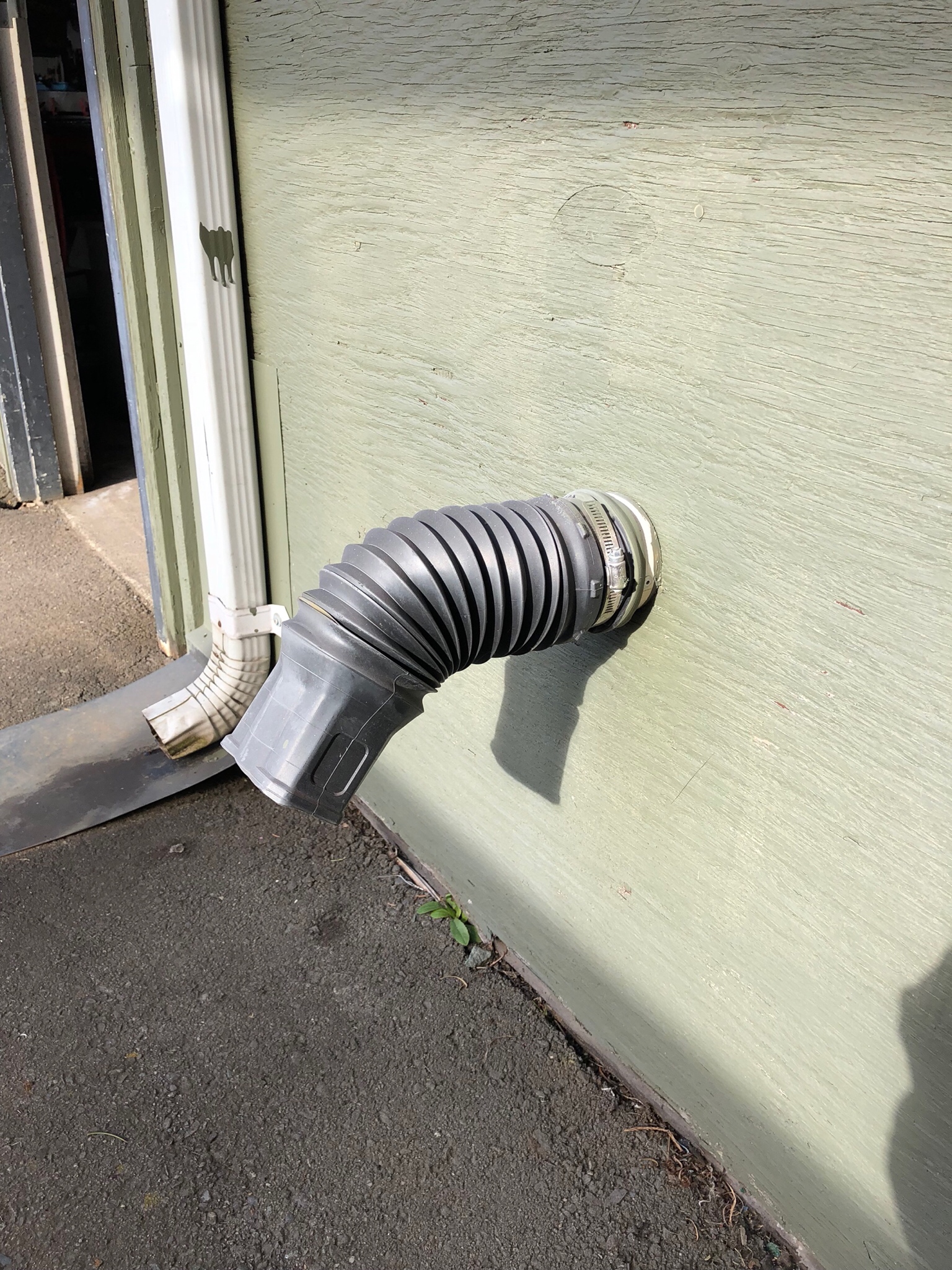

The pop off exit is actually at the FRONT of my shop. Here’s a pic with my homemade “muffler”IMG_0036.JPG

Just wondering if anybody has tried to adapt a big truck air drier to their shop compressor. I have a airbrake international I am robbing parts off of and it has a air drier to prevent brake line freeze ups. I want to use the dryer for my compressor, just havent gotten around to hooking it up. Looks like it would be a siple plug it into the air line between compressor and tank, but I havent even looked at whether it is feasible or how hard it would be to actually do.
I looked into it when I was setting mine up. But as Colorado doesn't have humidity & i'd have to source one, it wasn't worth it. But others have done it sucessfully.
They are just a desicant type drier with extra parts & plumbing to occasionally dry out the desicant with some compressed air. Not always the most efficient, but very practical. They eat up usable air when regenerating. You need to check the CFM rating on the drier and/or pump on the truck to see if it will meet your usage requirements.
Desicant can be regenerated to dry out absorbed water. But the media can be contaminated with oil that inevitably shows up in oil lubed compressed air systems & that can't be removed. So you need to replace the media occasionally even in automatic systems.

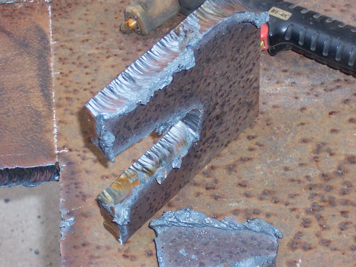

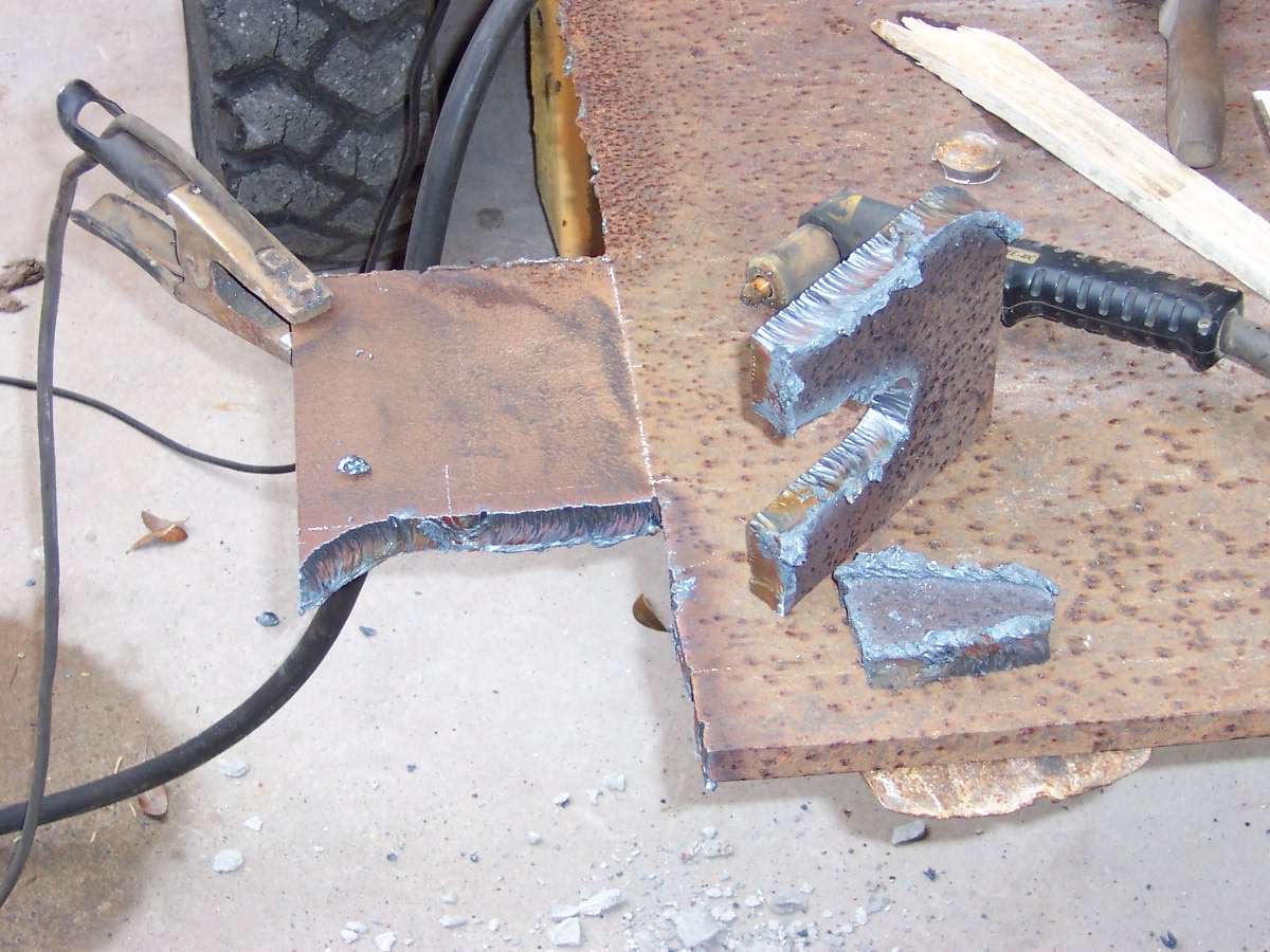

I have had a Miller Spectrum 625 for over 15 years and am very happy with it.
Until I retired 1 1/2 years ago I was repairing construction equipment with heavy mortar and cement on it.
I had to cut a lot of 3/8" and 1/2" bolts off with heavy covering of mortar/cement on them.
With O/A it will pop and shower me with hot M & C.
The Plasma arc is so hot that it just melts through the coatings!
The pic is when I cut some 3/4" plate making brackets to attach forks to my Branson Tractor quick change FEL.
It was really slow and over the machine rating but it cut it!
It will cut drag or stand off.
I had about 85' of black iron pipe to my Plasma area so water condensed very well.
I recently ordered more tips from China/Ebay and they look good, haven't tried them yet.
Was that rusty? It doesn't care, rust or paint!
