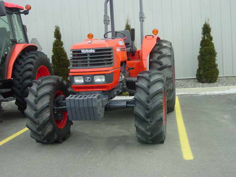

Any advise on these questions would be greatly appreciated. For any fellow M5030 owners here is a picture of one that has done us well for many years.
Thanks, Mike

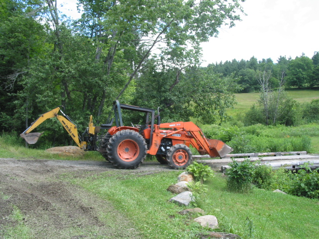

1) The hoe should be fine, it doesn't sound like you abuse your equipment. I don't think the new M is much weaker structurally than your 5030. That said the 85 and 95 have stronger hitches.
2) You can handle the larger grapple but it is more money and if you are doing light work the lighter one will last ok. I wouldn't be tearing out rocks with it though, your loader would be able to tweak the light one I think.
3) I would go with R-1's but you can get the wide floatation fronts. This really helps reduce the cutting in when using the loader. The rear weighting, the loaded tires are handy if you always use a loader but it makes it harder to fix flats, and you already know the heavy part. I'm not sure if cast centers are available on the smaller M's but they are a good comprimise. You probably already have a good rear weight in the form of an implement like the backhoe or snowblower.
I'm not sure the wide fronts are listed in the options but the dealer should be able to get them. I've attached a pic of an M6800 with them.
