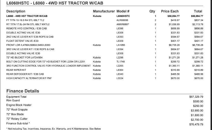

Well thanks everyone for your comments and feedback. I have to decided to purchase the Grand L6060 with these options. Let me know what I am missing. Dealer has to order most items.
Block Heater, He told me it is a kubota branded heater, but no the CCV unit. Just plug it in like a Diesel truck
Rim Guard
Rear Wiper
Rear Defrost - not sure if I need the rear quarter glass defrosters
HD Altenator
Third Function for Grapple
3 Rear Remotes, 2 DBl Acting and 1 Float
HD Bucket with Cutting Edge ( Although they are trying to get me to use the standard bucket )
This unit has the R4's They claim that is all they sell and no need for R14's I originally wanted the R14's but he said it will be way more and no advantage
What do you think, I don't have any plans for a front mount Snow Blower so I didn't opt for the Mid PTO, do you think I should get it anyway?
Attatchments I will pick up elsewhere They seem to be so expensive from dealer. and I have no issue with used either.
