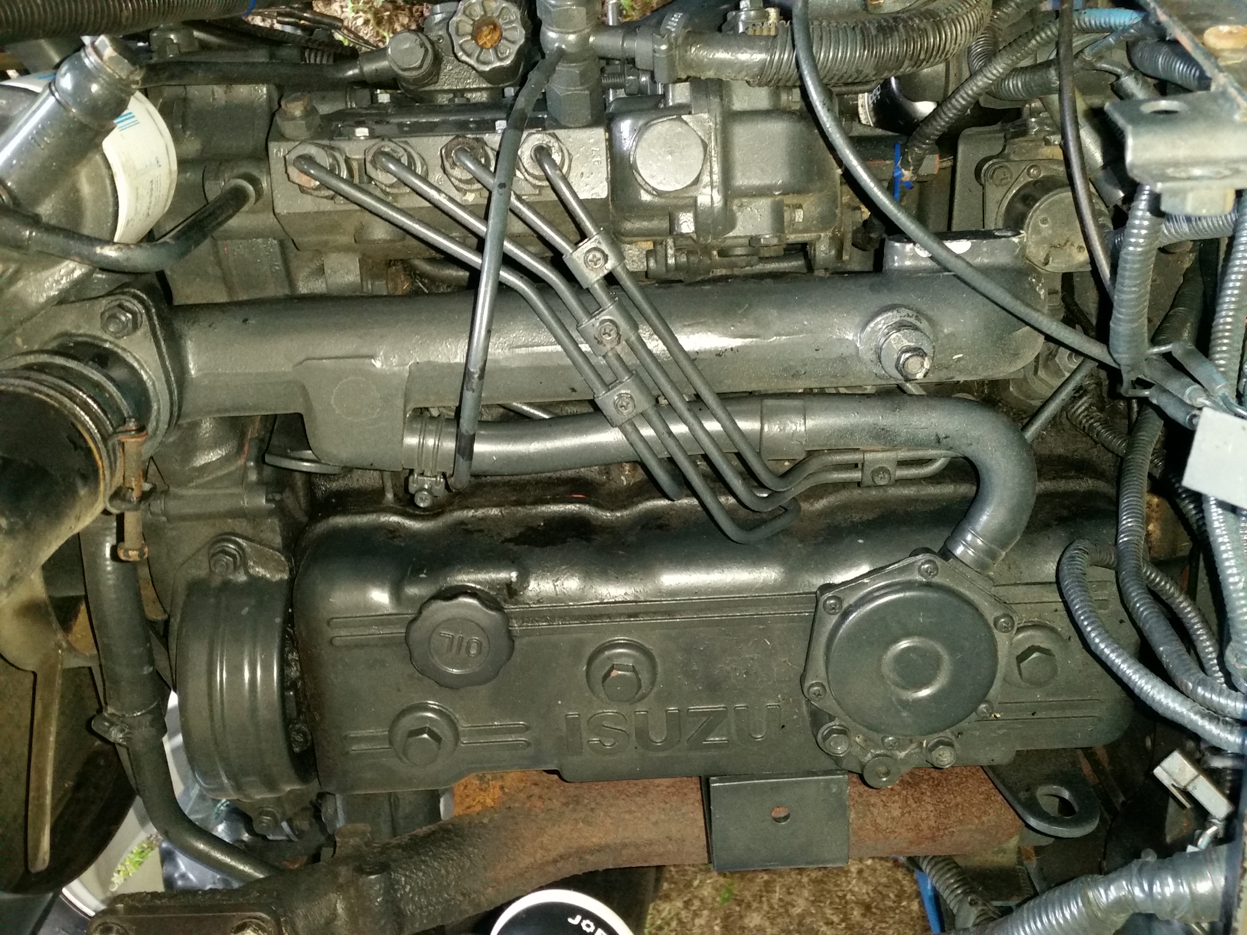

Hi everybody.
I'm a newbie in the world of tractors. Quickly, I'm 38 yo, teacher, hobbyist machinist, welder and woodworker. I own horses and I needed a tractor with a front loader in order to help me.
I found a little TA320:
The seller gave me a TU hard-top, I've adapted it for the TA. No particular problem with the tractor hitself, but I've questions.

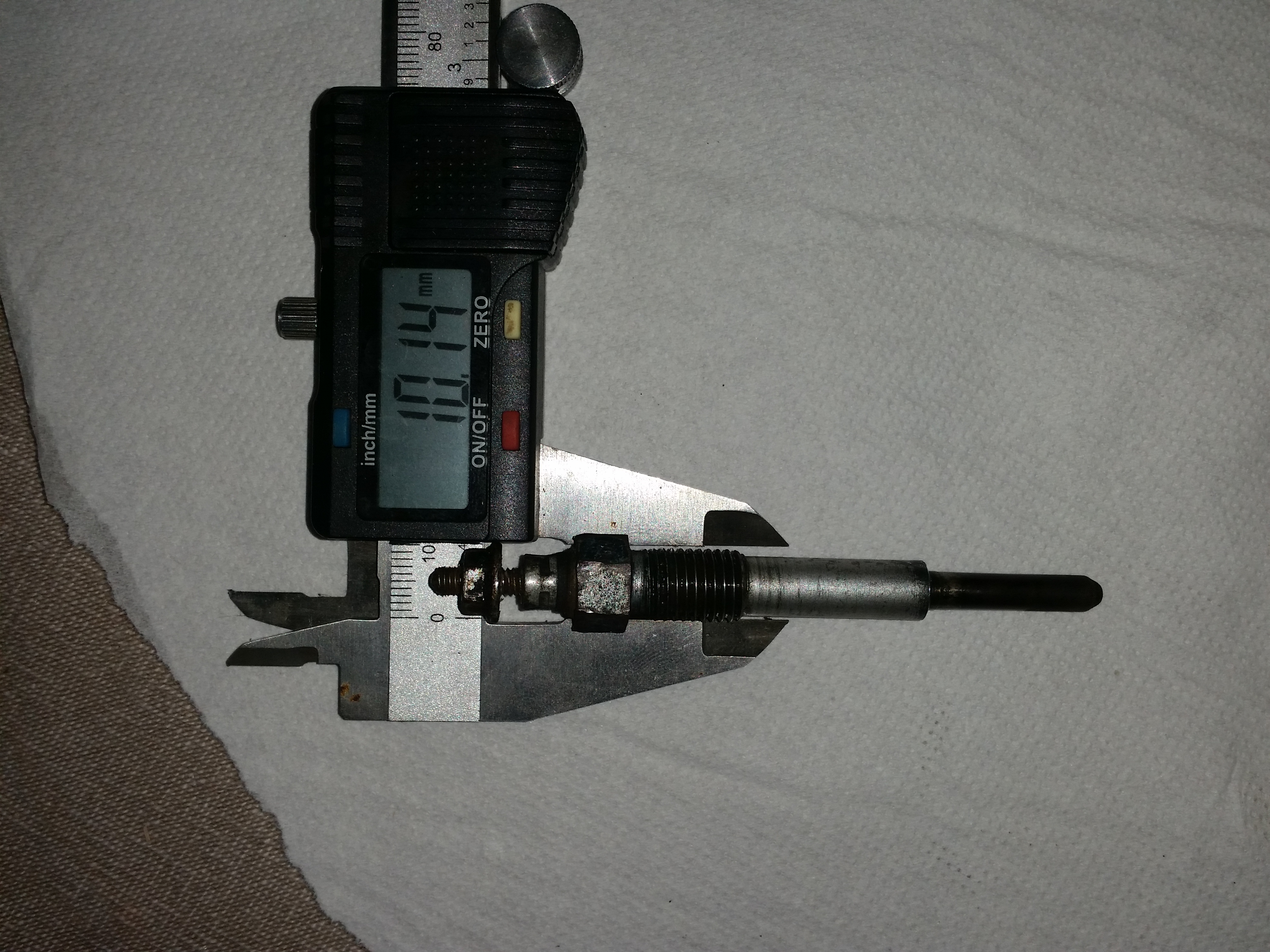

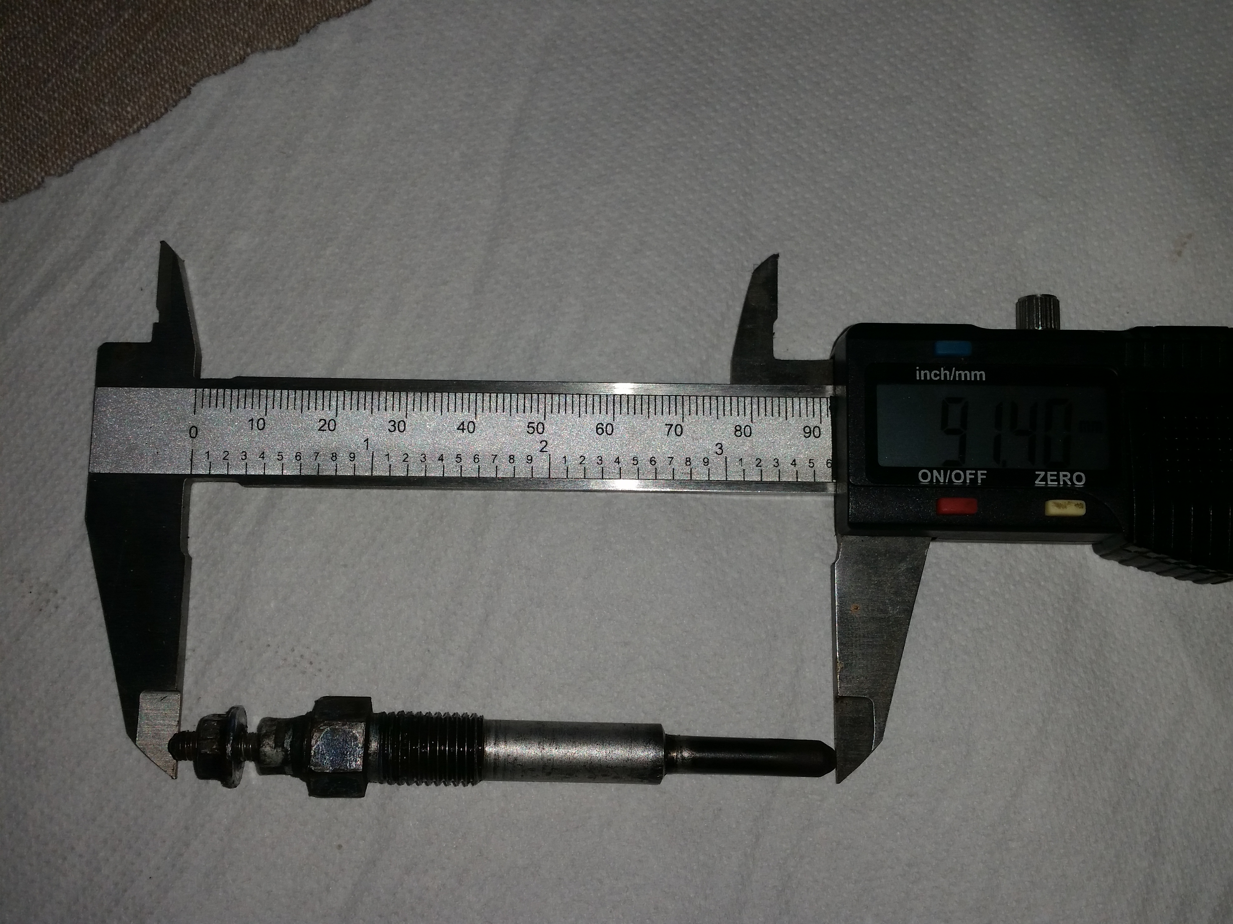

The only problem with it is glowing time. It's looooong. I need to change glowing plugs.

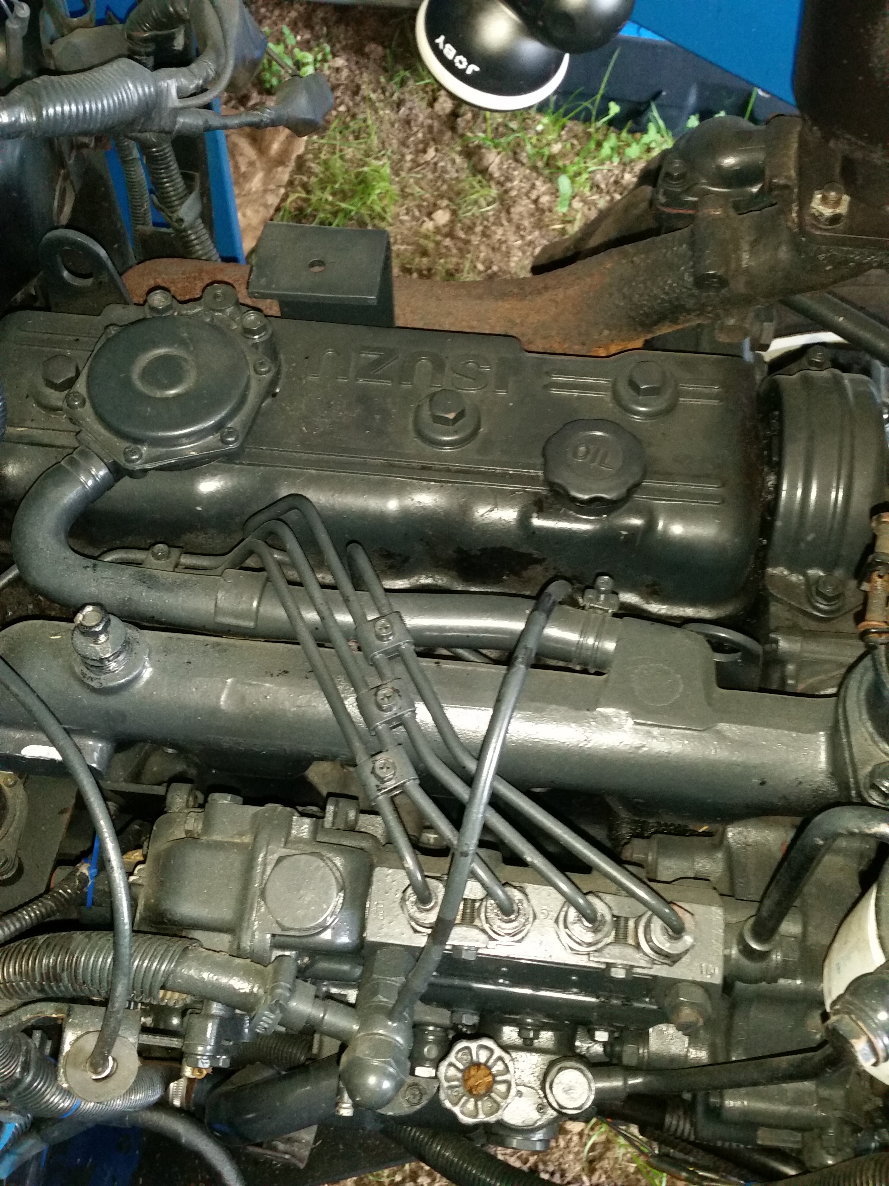

But engine is an Isuzu 4 cylinders and there is no reference :
And here are glow plugs:
So the question is: were could I find glow plugs ?

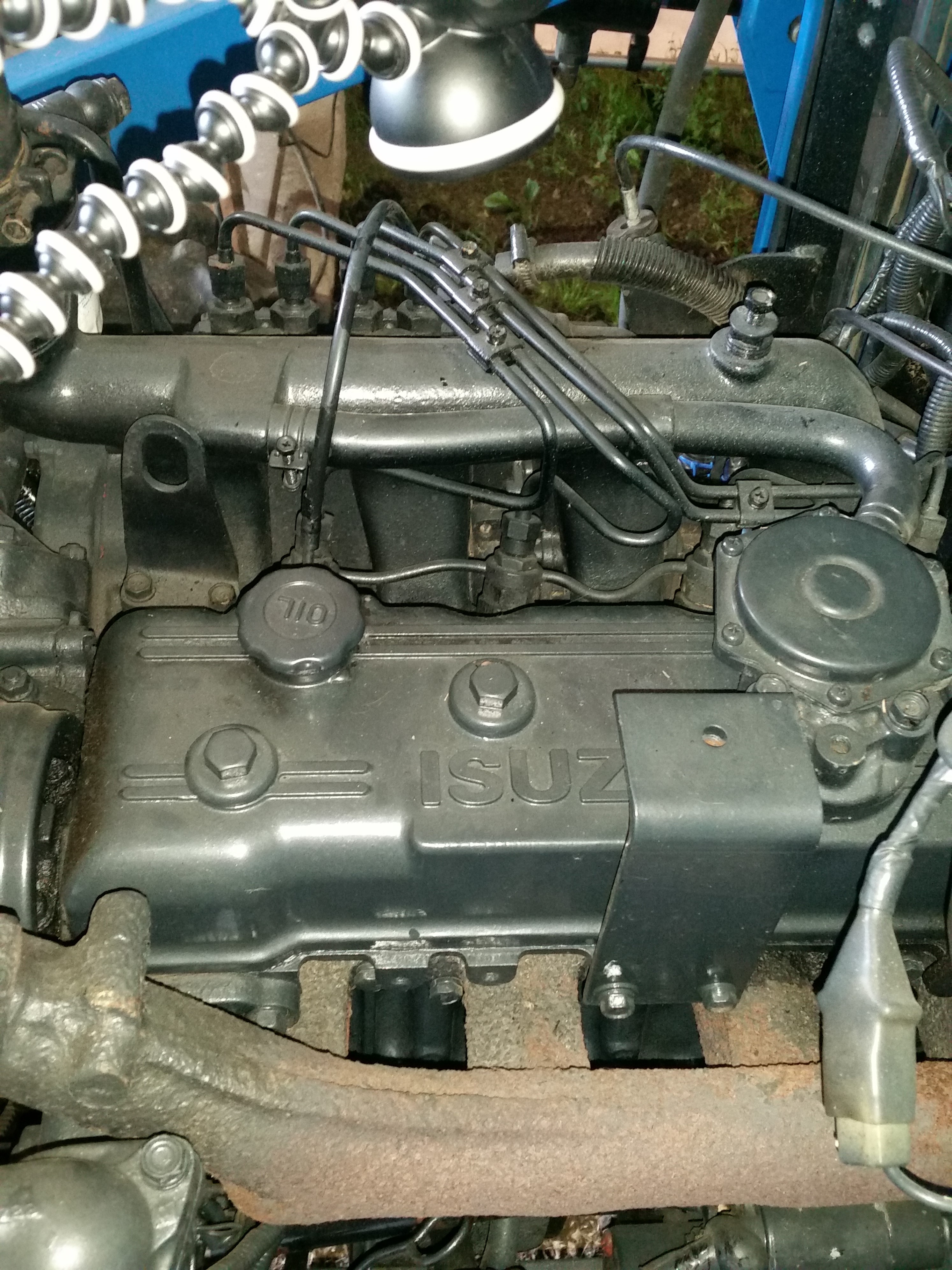

You must first know the engine model. It is engraved on the left side of the block above the starter motor
/ Questions about Iseki TA 320

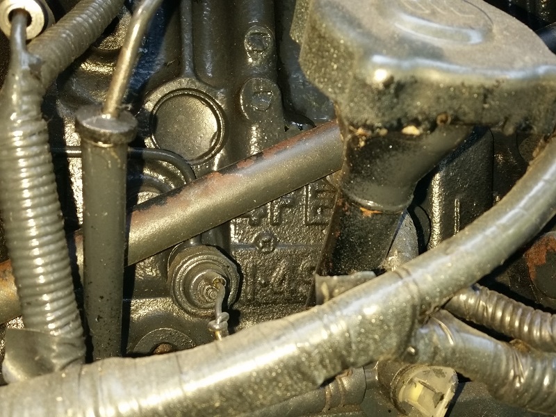

Thank you for your answer but I can't see nothing engraved near the starter motor.
/ Questions about Iseki TA 320 #4
Thats a picture of mine , I have a TA 357 with Isuzu engine

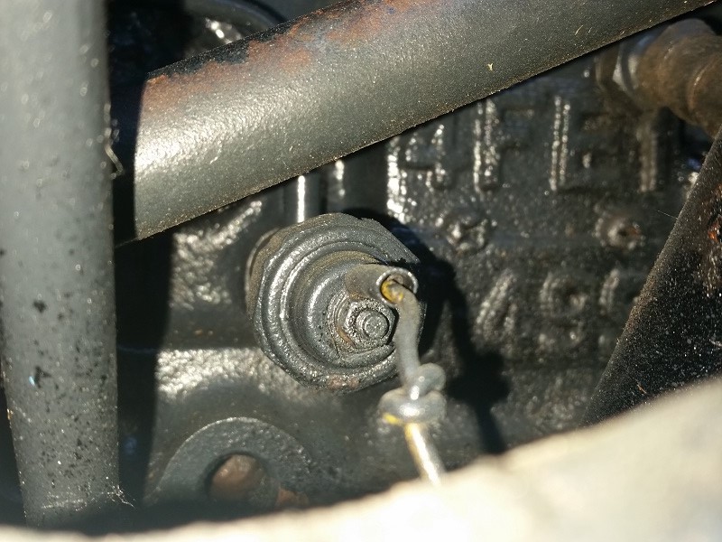

Could I have a larger view to see where it is ? Thank you.

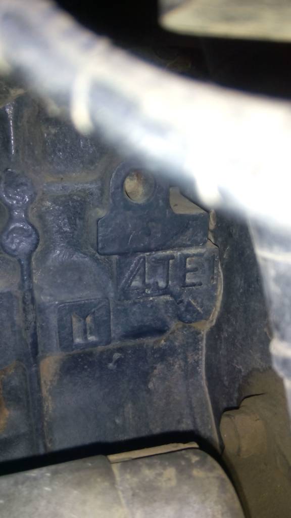

Ok, I've found I. Mine is engraved behind oïl refilling.
It's a 4FE1 engine.
#9
And the 4JE1 is ?
#11
OK. I've found glow plugs on eBay. And even a complete kit to rebuilt the engine. It's good to know it.

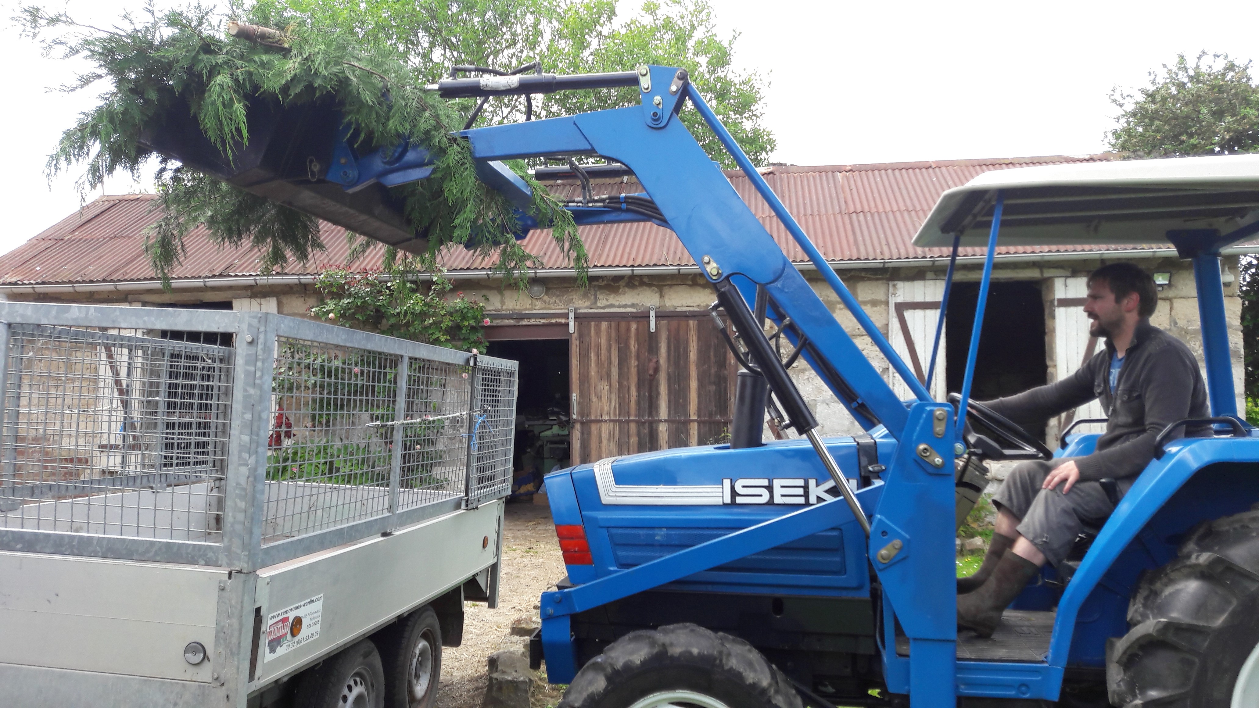

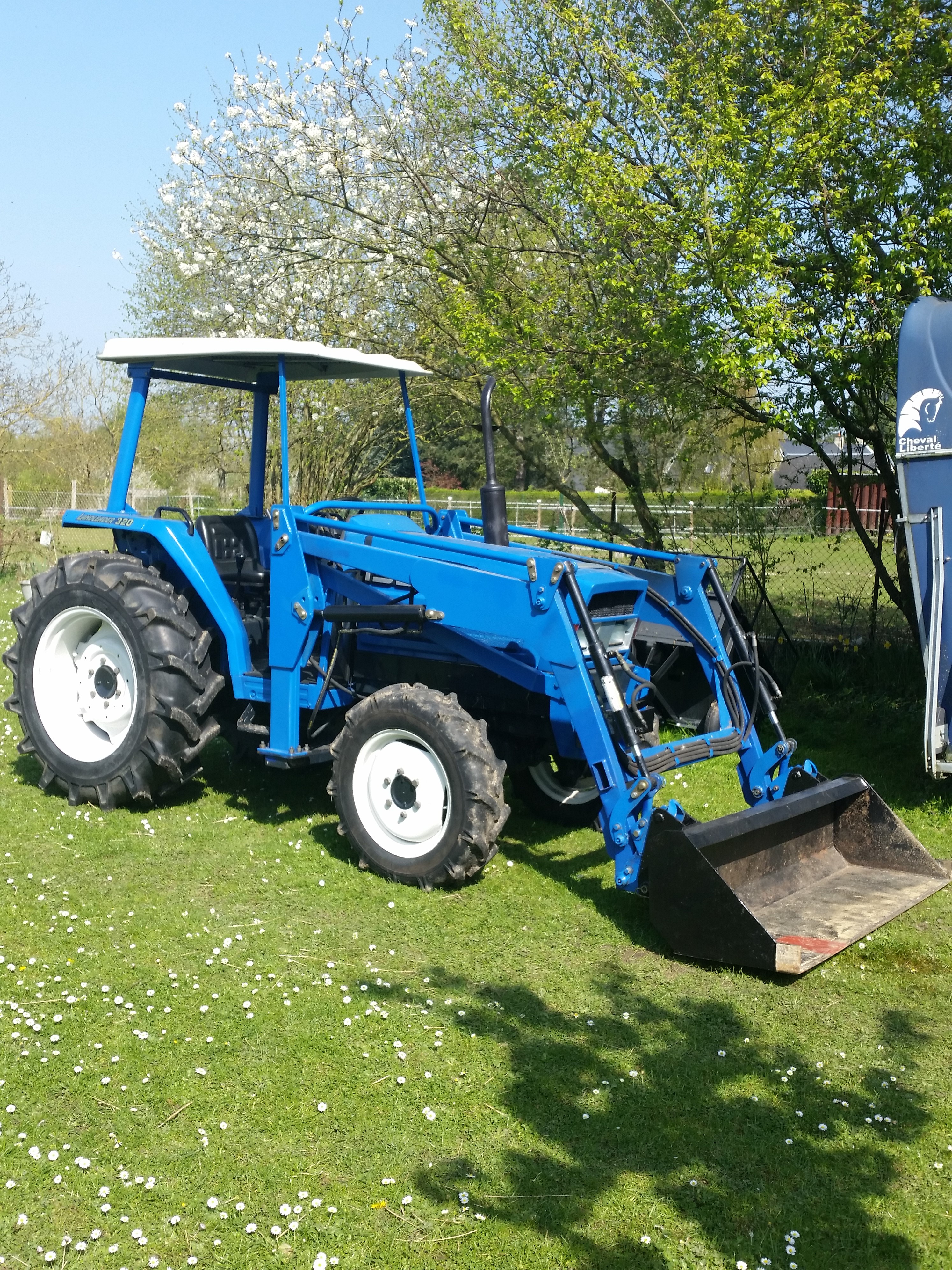

Yes. The advantage on this loader is you can remove bucket to use forks. I don't have forks on this loader, but I'll make soon.
#15
It's a beautifull tractor. And if you have the clim, it's usefull for you. Here in the north of France, it would be useless ;).

You might want to investigate if your existing glow plugs are actually "bad." Test their resistance for being open or shorted. They should have around 1 ohm of resistance. You mention the glow time is long - how long? Typical glow times are 20-30 seconds. If you're missing the glow indicator or it is broken the glow plugs will not function unless someone bypassed it.
#18
Thank you for your answer.
Edit: glow indicator works, but spring is at the bottom, and seating it's not very viewable, but it works perfectly.
Actually, with a rather hot weather, glowing time is typically 10 seconds. But in winter, it's longer.
But glow plugs are not expensive and I'd prefer to have 2 pairs in replacement. I've tested glow plugs with z 12V battery. They became red more or less quickly.
