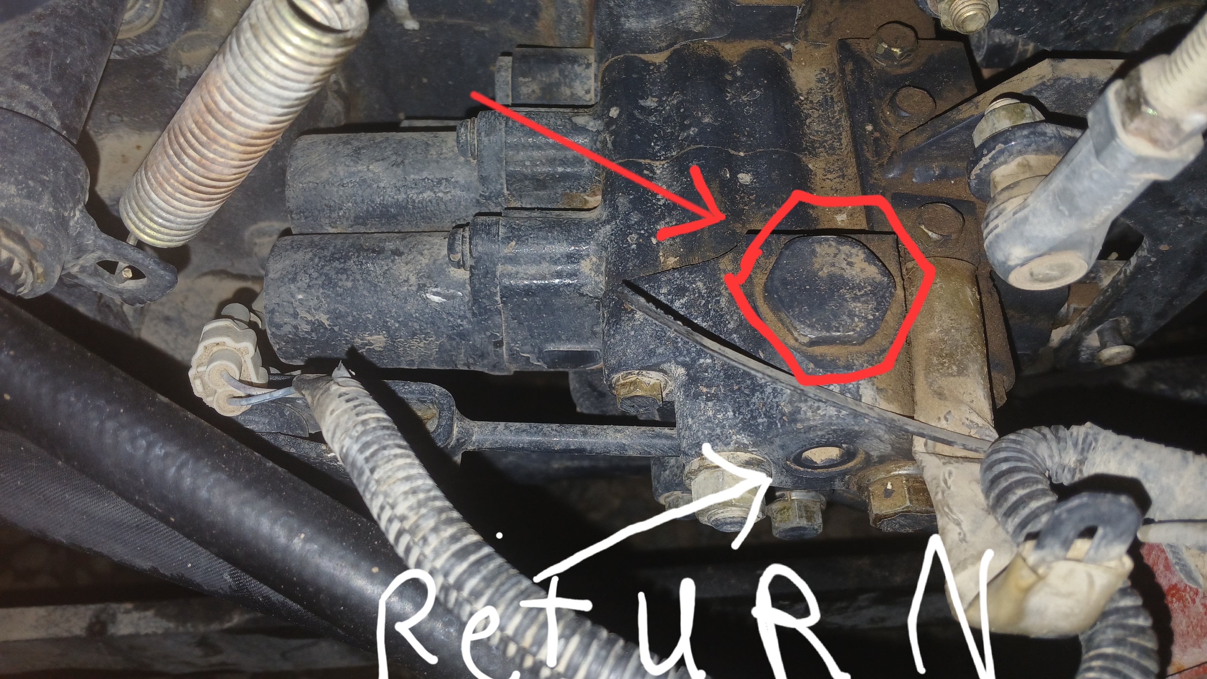

Are you talking about this plug? Thus picture is from the top side of the last picture you posted.
That’s the sump port for the third hose. I couldn’t see it in your other photo. So you have all 3 ports identified 👍🏻
It’s not the hex plug that gets replaced with a diverter plug, that I mentioned though. That should be directly on top of the return port casting, pointing downward

It’s not the hex plug that gets replaced with a diverter plug, that I mentioned though. That should be directly on top of the return port casting, pointing dodownward
Here is what I believe you are talking about circled in red. It's a hex capped pointing downward. The white is the return line flush allen head port.
Do I need a diverter plug in it if I'm not using it in a "rear remotes" setup and just using it as a "power beyond" style?

OK so if I understand the diverter plugs purpose. The cap that is there should alow for flow to that plug. (And give me power beyond, or "constant pressure") If I use a diverter plug it would be for a "third function" and would shut off the use of 1 of the loader functions. And diverter it to the 3rd function until I swap it back.
That looks like the one
As I previously mentioned, I don’t know how the machine would operate without it. I don’t recall its exact shape either, so I don’t know if it’s actually diverting return flow from passageways internally vertically or horizontally for some reason , or if it’s only for restricting flow. I doubt you can buy it, and I doubt anyone has a dimensional diagram of it either.

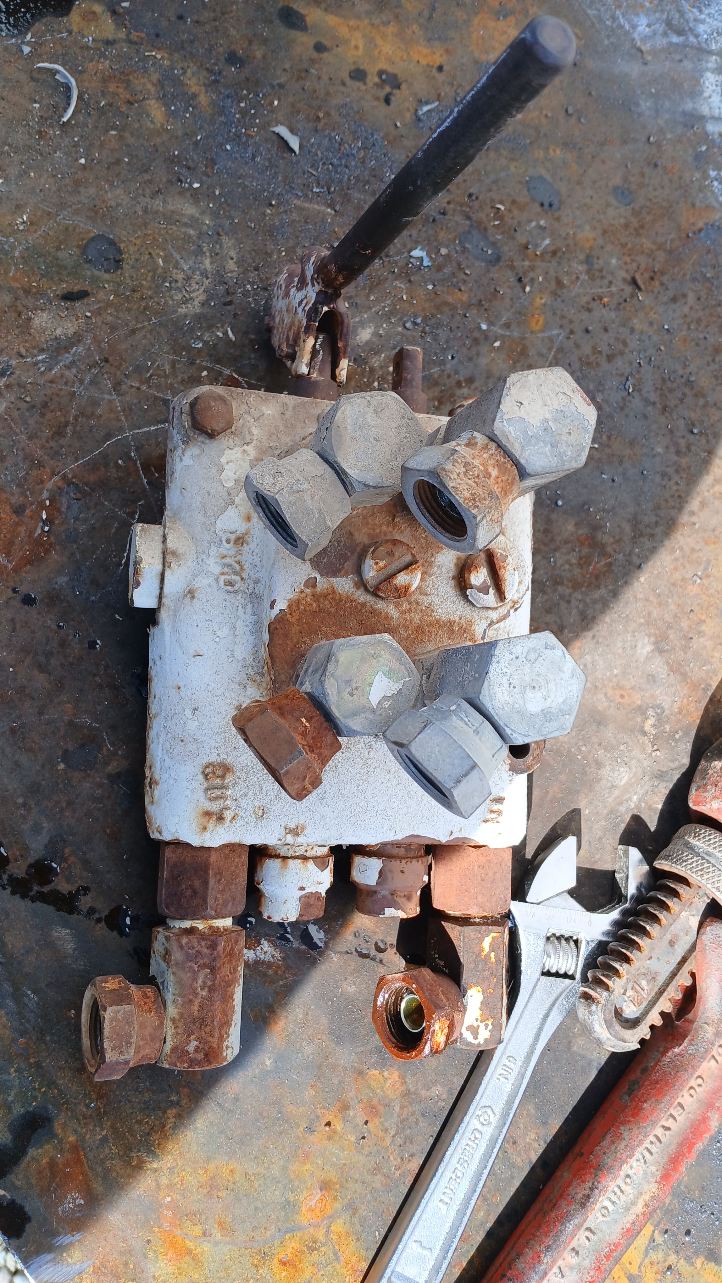

Massey Ferguson 451 has a square steel plate behind the seat to which the valve body and 2 pressure and return hydraulic connections are mounted.
I'd expect any MF dealer can order the plate w/ fittings and valves. Personally I'd mount it somewhere else. Behind the seat makes it inconvenient for hooking up 3-pt implements.
You can see it in this picture if you blow it up,
