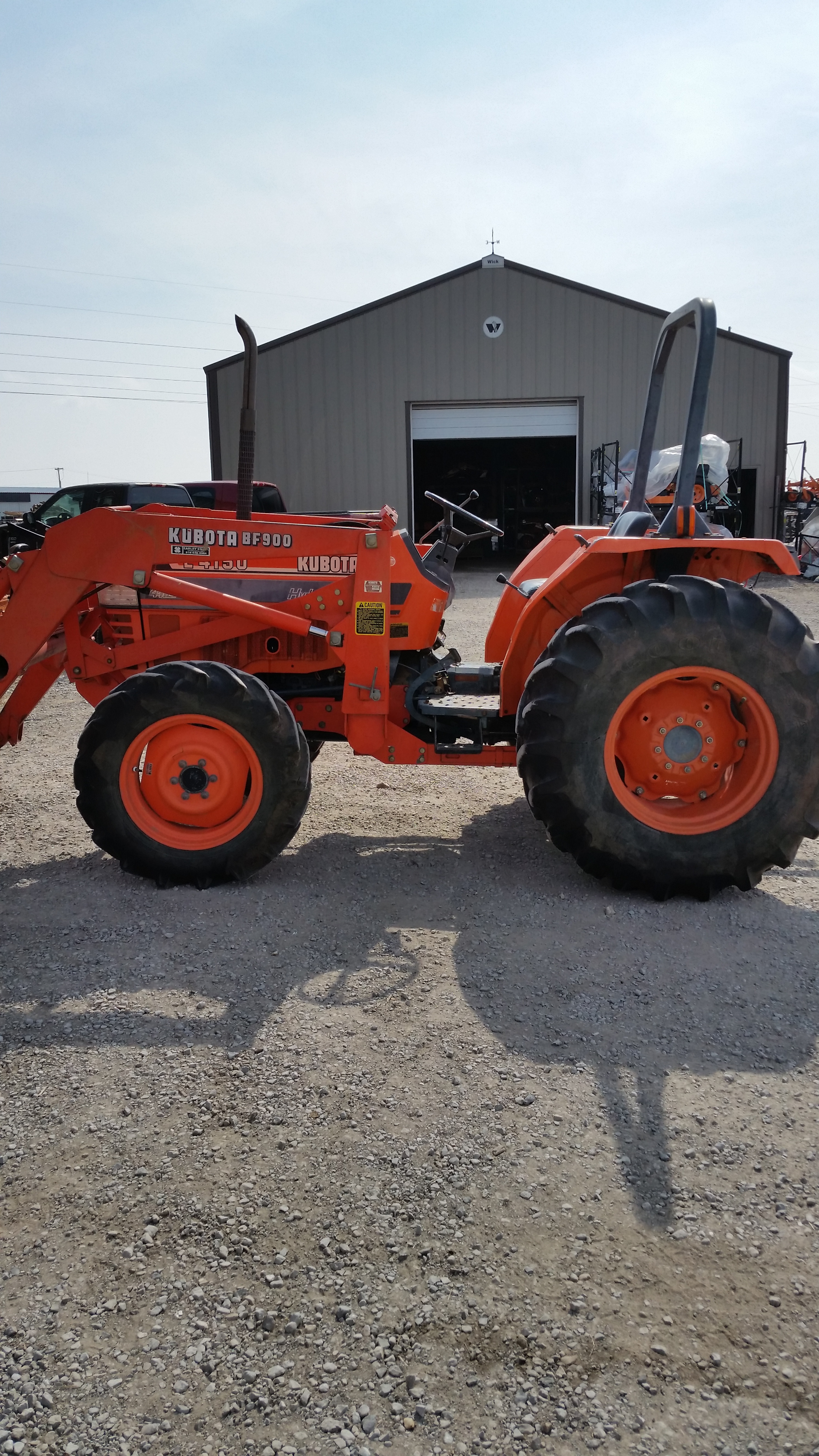

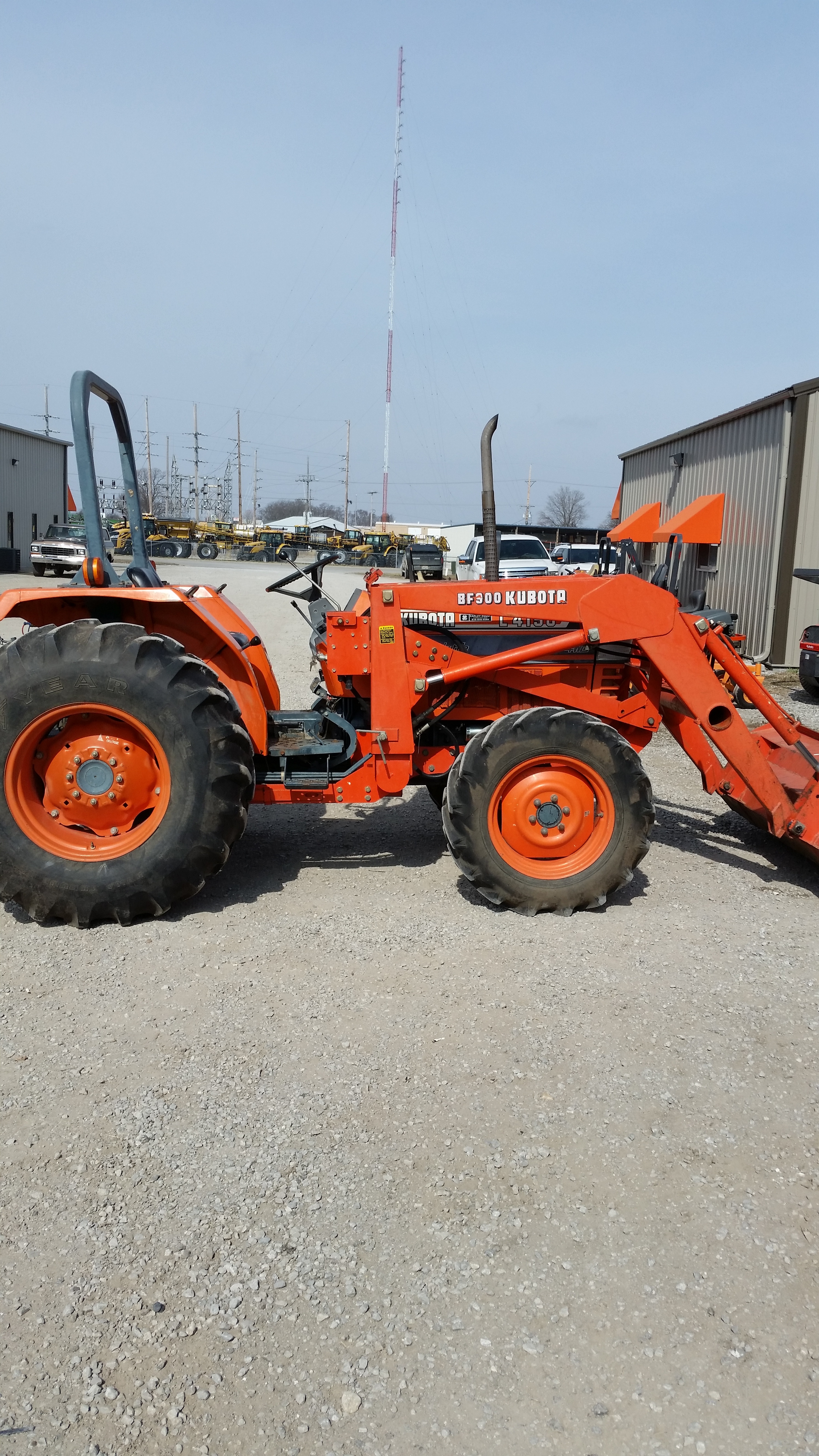

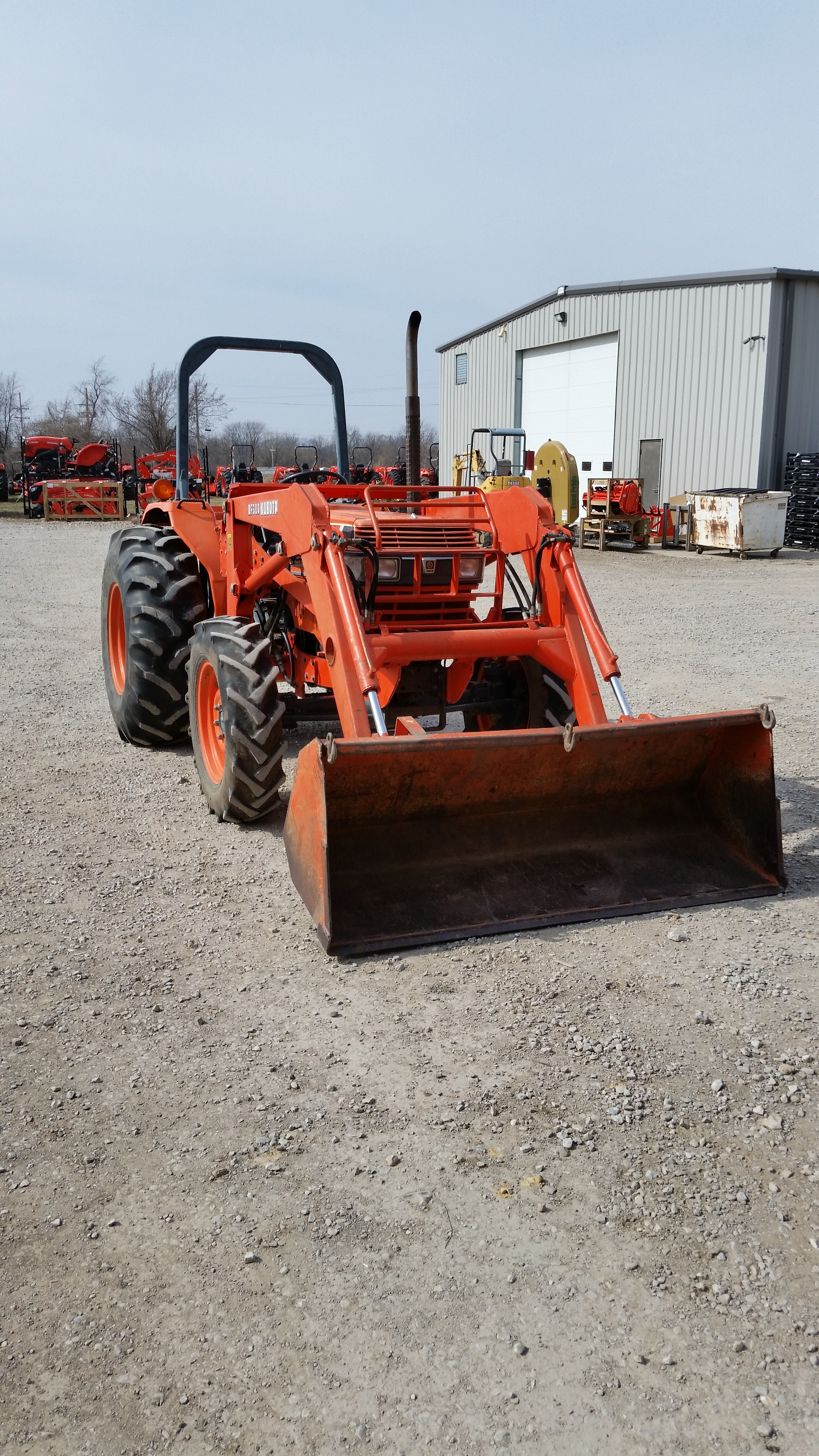

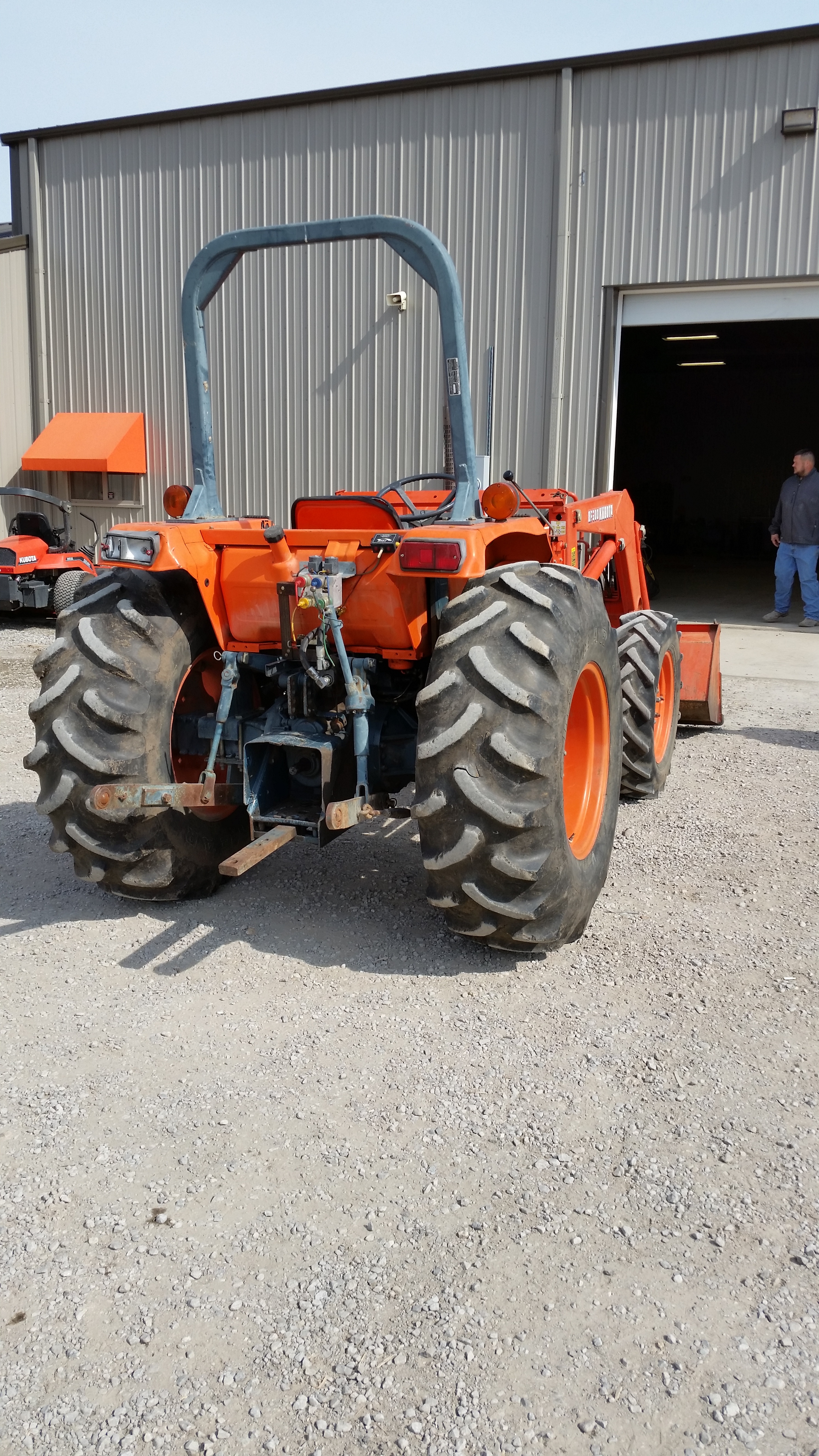

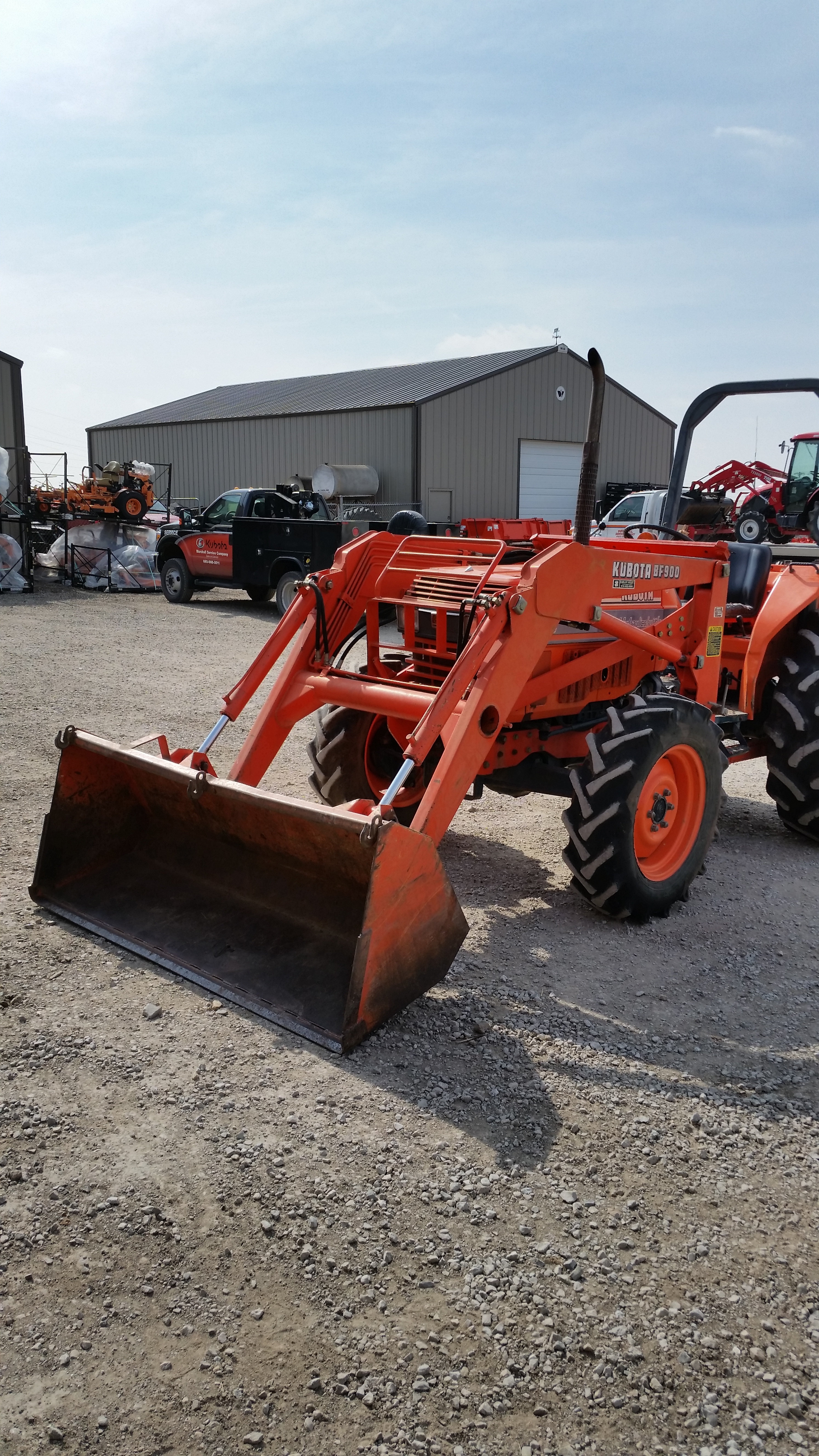

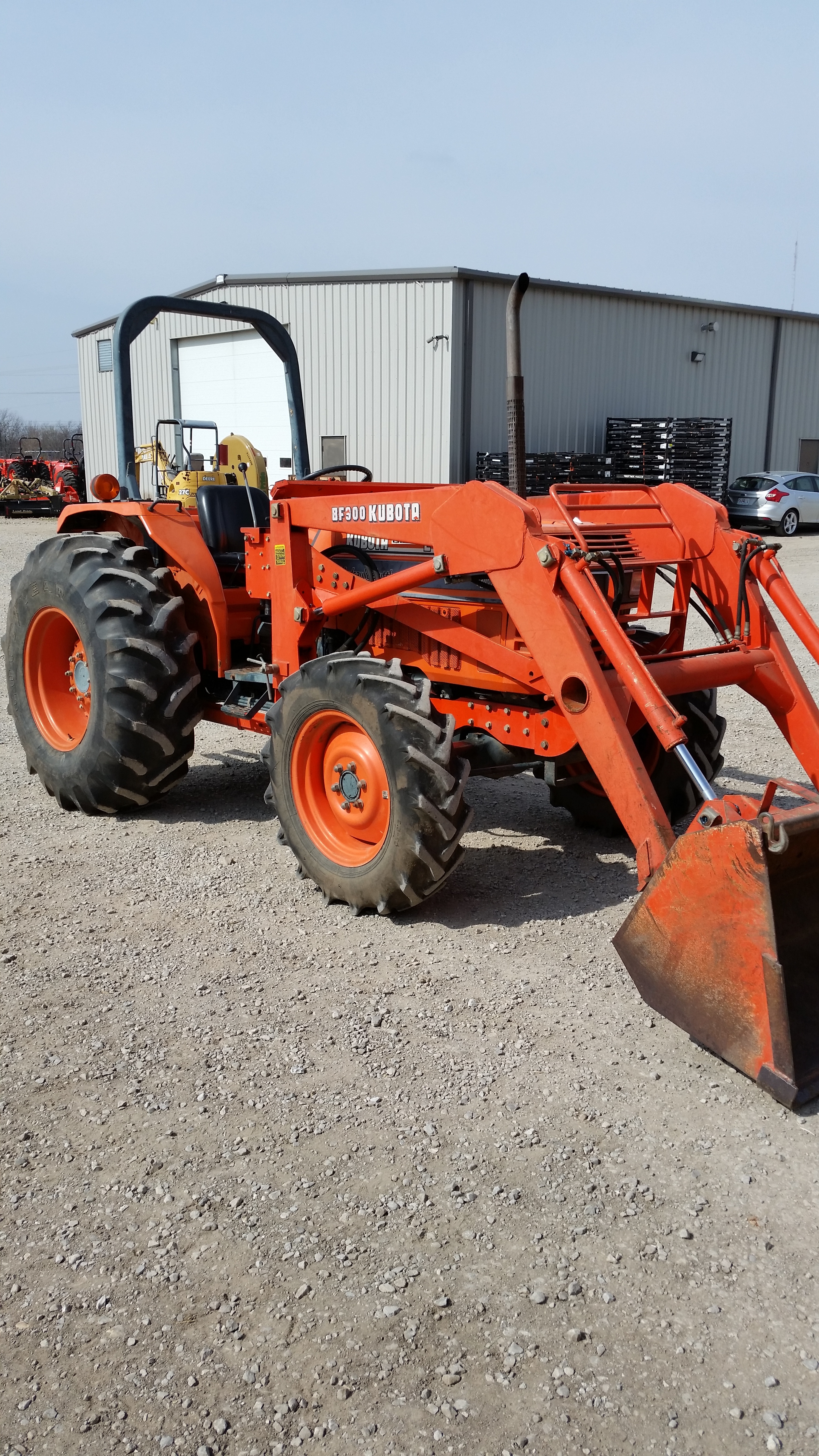

Pictures of the L4150?
/ Question regarding L4150 Hydro light on dash #13
.....Pictures of the L4150?
Tom: jms13 has posted some pics here of this nice L4150.
After reading the page posted above about how the clogged hydraulic filter warning light works, I think the thermal switch on mine is faulty and allowing the light to come on on cold startup. I think your switch is functioning correctly, preventing the false warning light at low temps.
I agree the term "hydro" is used to refer to hydrostatic drives, which are quite different from the dry or wet clutches in L3 machines. Dick B

Dick,
I agree should of used "hydraulic Oil" light on easy checker dash. Wasn't really thinking of Hydrostatic at the time. :eek:
