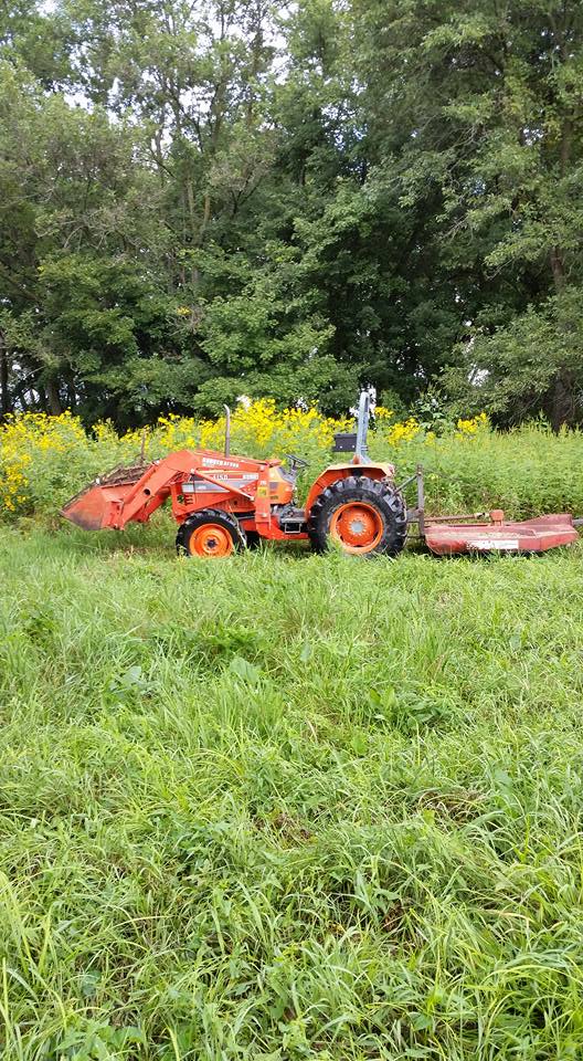

#37
Dick B.:thumbsup::thumbsup::thumbsup:
Thanks. loving the L4150, getting used to how she operates has been a learning experience.
Getting better at not using the clutch and only using the shuttle. Really cool how it works.
Mowed about 10 acres with her didn't miss a beat.
