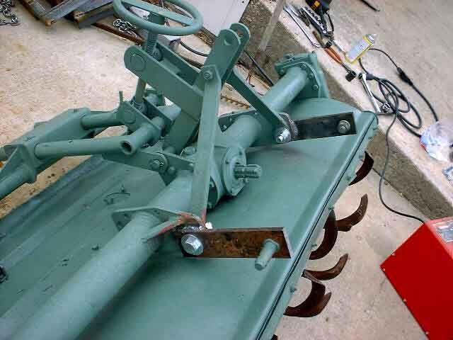

Count me in the exact same situation wall to wall.
Here's a pic that someone posted in one of the previous threads that may be of some help. When I do mine, I think I'll just get the clutch first, then make the lower link extensions to fit.

   / Question on Yanmar RS1200 tiller #14
</font><font color="blue" class="small">( re: HomeBrew2's photo )</font>
Someone posted a similar photo and said extending the pins is also a substitute for the special Yanmar upper link assembly. That is a barrel link that looks normal but is shorter than standard, and an extended mount bolted on the back of the tractor to meet the tractor-end of this short upper link.
Apparently the special upper link, or welding on the pin extensions, is needed so you can lift a Yanmar tiller without hitting the tires.
Bolting on that special Yanmar upper mount before tilling seems like a nuisance. Do the pin extensions really work as well? Comments?

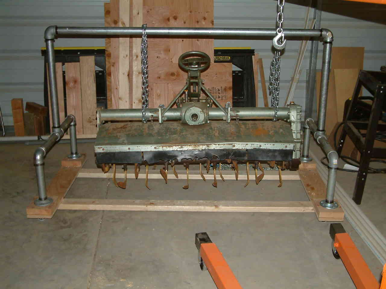

Re: attached photo
That's what my RS1200 tiller looks like with its male, 6-spline PTO shaft (see attachment to this post).
Still need to weld on the attachment bars as shown in your attachment.
Don't know if I'll do the custom paint job.
